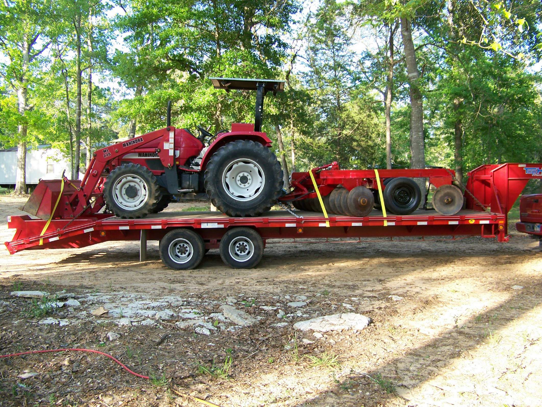

Well, I got the frame crack welded up today. I then took the disc and my dual tandem trailer to our new local Love's truckstop to get on the Cat scale. Weight on the trailer axles was 9,0000 pounds with the disc onboard. Went home and took a short nap, then took the disc off the trailer. Then Back to the Cat scale. Trailer empty weight on the axles was 5740 pounds. So the disc weighs 3260. Wow, that is lite! Also, I realized at the welding shop the front disc pans are 20 inch diameter and the rear disc pans are 22 inches in diameter.
So the trailer weights 5740 axle weight on the axles. Huge difference from the 7400 pounds on my registration.
Tomorrow.....................play time with the disc.:tractor::cloud9::dance1::eek:die::proposetoast::applause:

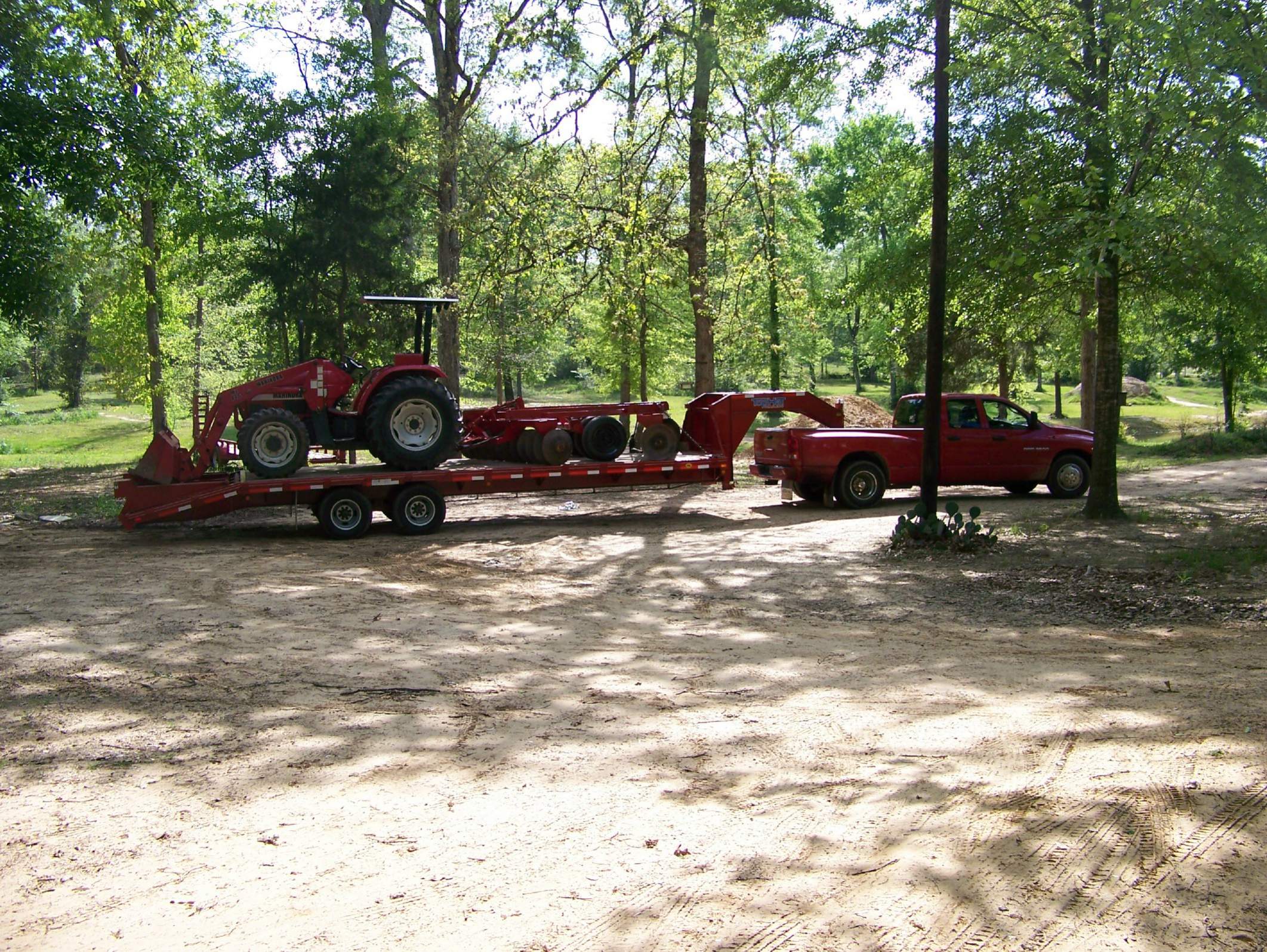

I finally got the Cat scales all figured out and weighed the truck and trailer. The truck by itself. I also loaded up the disc and Big RED Beast all loaded on the trailer. This gave me valuable experience loading and unloading the disc and tractor. It also let me get a feel for how it rode..........WHICH WAS VERY SWEET!
Truck by itself weighs 7300 pounds.
Truck with trailer hooked up weighs 8420 pounds.
Trailer on it's two axles weighs 5740 pounds.
Tractor and Disc on Trailer weighs 18,240 pounds and the truck with all that hooked up weighs 9460 pounds.
So with an empty trailer.........my truck has 1120 pounds of hitch weight.
With the tractor and disc on, my truck has 2160 pounds of hitch weight.
I really need a bigger trailer. If it is was 3 foot longer, I wouldn't have to disconnect the disc hitch from the tractor. As it is now, I need to do this to get the front tires on the deck and off of the dovetail, so I can stow the ramps....................which is what the loader bucket rests on. So the disc weighs a little more than 3260 I stated earlier. I'll drive the tractor and disc over to the Cat scales one fine day soon to get exact weights. I wanted to unload in the truck parking area, but there is a sign at the entrance stating no trailer drops. I figure they would take unloading as a trailer drop.

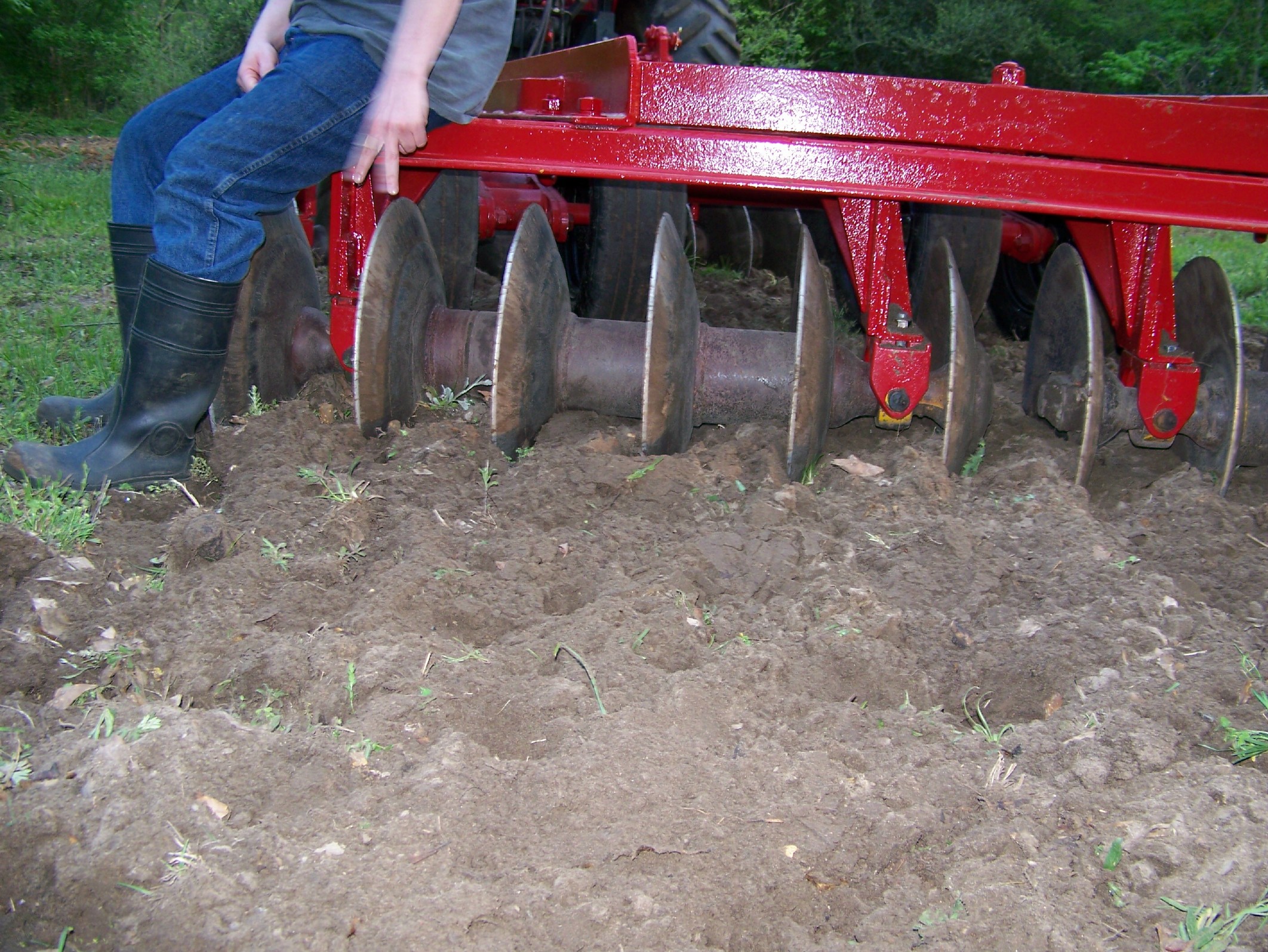

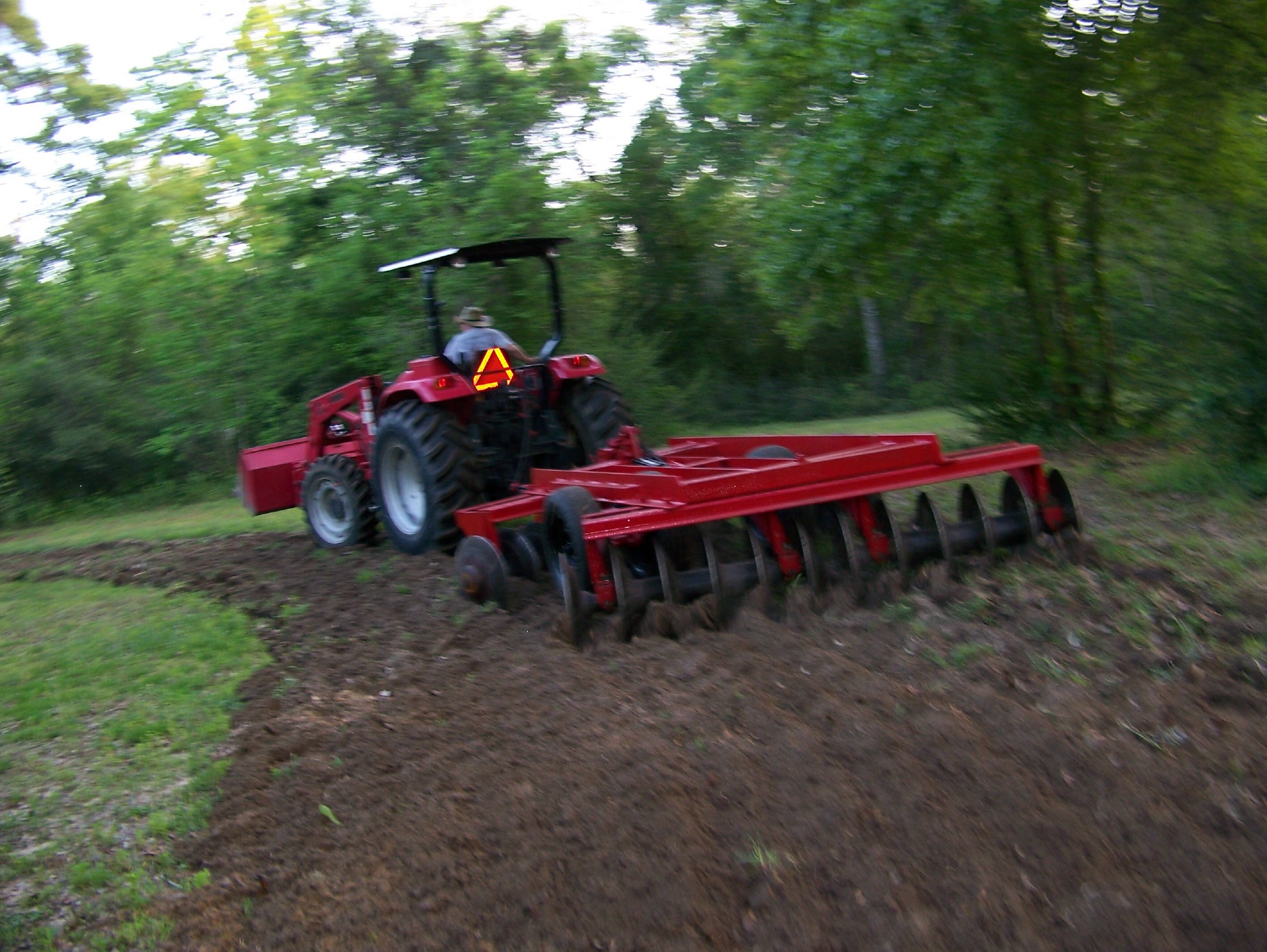

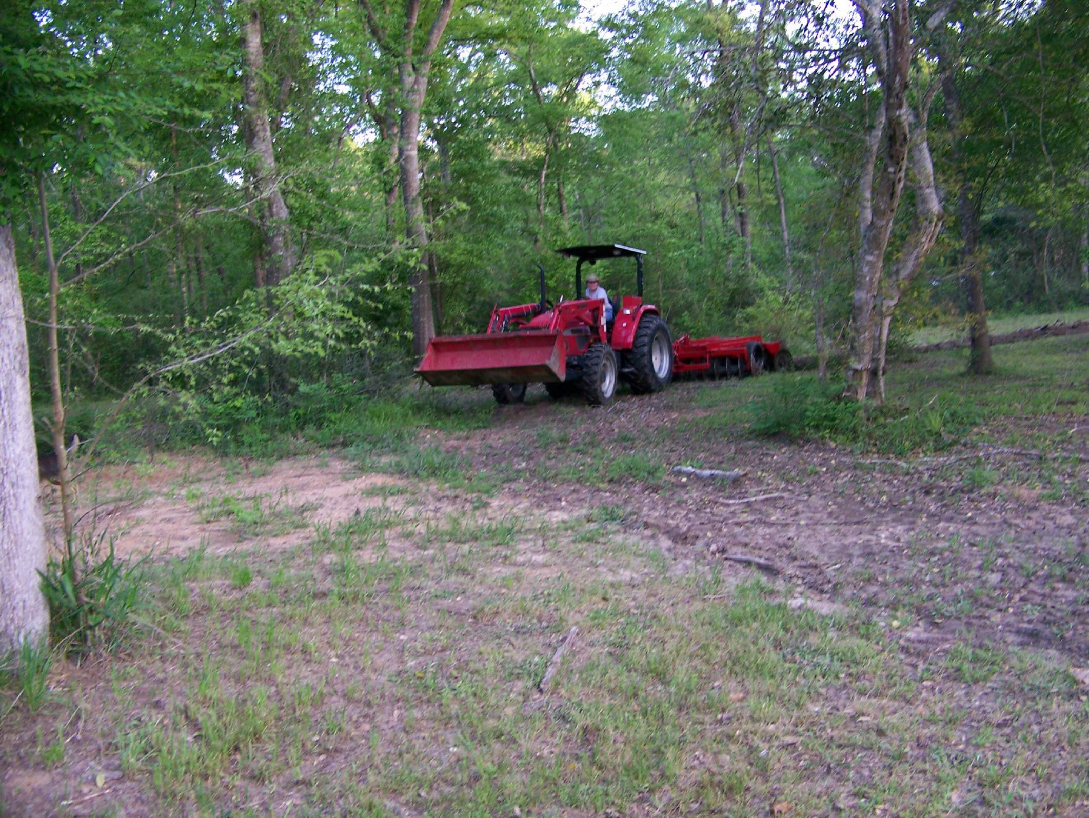

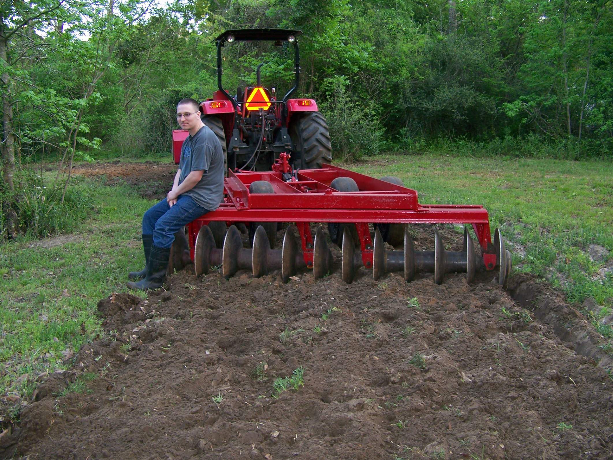

Anywho, after unloading everything, I took the disc out and played while Luke took photos. Two passes and I had it buried up to the axles in land that was thick trees and brush about 5 years ago. Later today I will retorque everything..........after I clean all the dirt off of the back of the frame. Dirt was literally flying.
I do need to get all the scrapers fixed up and reinstalled, as some of the right side disc pans had lots of packed dirt. I also want to make a new tire lock hole to just have the disc sink in about 3-4 inches. If I plant bermuda grass seed and bury it the 8 or so inches that is up to the axles, it will never germinate as it is too deep. Also, I was told Friday afternoon to not disc up under tree limb areas to full depth, unless I want to kill the trees.4-6-13 Big RED Beast Discing.jpg4-6-13 Disc Throwing Dirt.jpg4-6-13 Down to the Axles.jpg4-6-13 Down to the Axles 2.jpg4-6-13 Luke and Disc in Dirt.jpg
I ran in 3rd and 4th gear and between 1500 and 2000 rpm. I love this disc!
