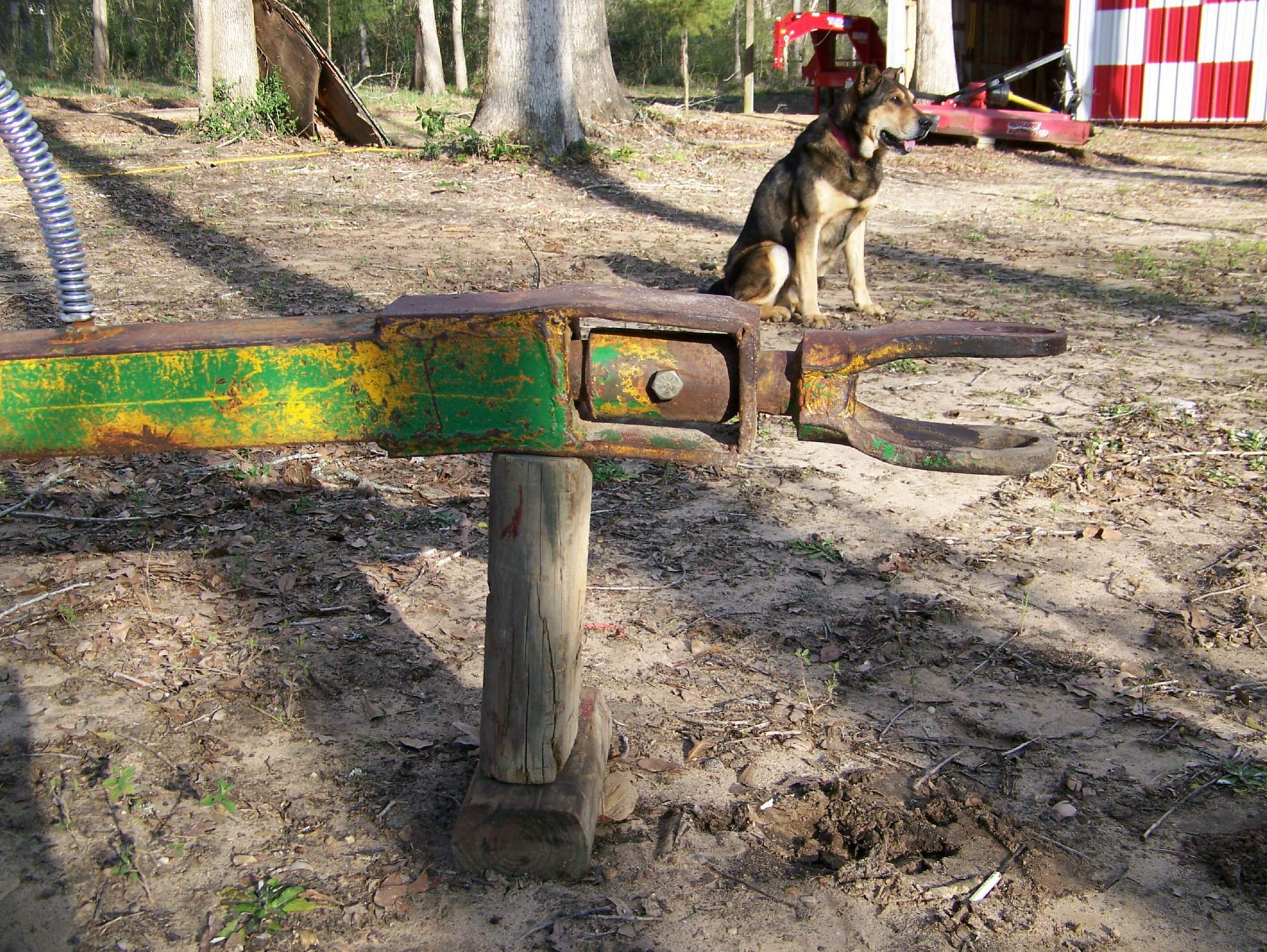

Sixdogs,
Do you see any advantage in using a hammer strap with my hitch that pivots on the tongue? 3-10-13 Disc Hitch.jpg
What would the advantage be on a hitch like mine, other that the pin wearing the holes?
hugs, Brandi

That swivel will help you in the twisting action of the disc and that's a good thing. The benefit of the hammer strap is almost totally with the action on the drawbar hole. Beyond that not much need for it.
I would not get a hammer strap just yet until you use it a bit and see how it behaves. I also suspect the hole in the disc tongue is a lot bigger than the hole in the drawbar and will give you that "chugging" or "hunting" tugging action I mention. Try the disc and come back to it but I'll guess you'll need to have the hole in the disc tongue made smaller and that you will ultimately need a hammer strap.
That is one heck of a rugged offset disc. Carry a spare drawbar pin and make sure there is a hole to put a click pin or hairpin in to keep it from popping out. Also, don't be tempted to use a grade 8 bolt. Normal hitch pins are a grade 5 and the grade 8 will wear the drawbar faster.

Wow.........Grade 5. I just bought a Grade 8 bolt 8 inches long to use in the tractor's front hitch to just move it around.

She showed an extreme example of the wear on the disk tongue a few pages back that you have been explaining the hammer strap fix for on the tow bar.
She or someone repaired it and drilled a new hole. A snug fitting pin or a smaller one with a pipe sleeve will probably keep the slap from wearing the tongue into a slot for a long time on the disk.
I really don't like fooling with sleeves and I don't like the clips you show on your pin. They are nice to pull out but too easy to be pulled out and lost by something while in use. A snug fitting pin, like you show is the best solution unless it gets bent a little; then it's time for the torch. Were the holes in your draw bar already there for the hammer strap piece? I'm recalling an extra hole or two in my old Ford draw bar to mount a loop to hold the baler safety chain. I don't remember if the CNH has extra holes or not. One of them, at least, is shaped like your strap would be if it were on the bottom to lower the pin hole down closer to the ground for proper tongue height on the implements. Guess I better go look. I don't normally leave the draw bars on the tractors except for making hay.

Grade 8 is OK to move it around but when actually being used the grade 5, unless it bends or breaks, is the right thing. Hitch pins are grade 5 and make sure you pin it on or two nuts locked together .
