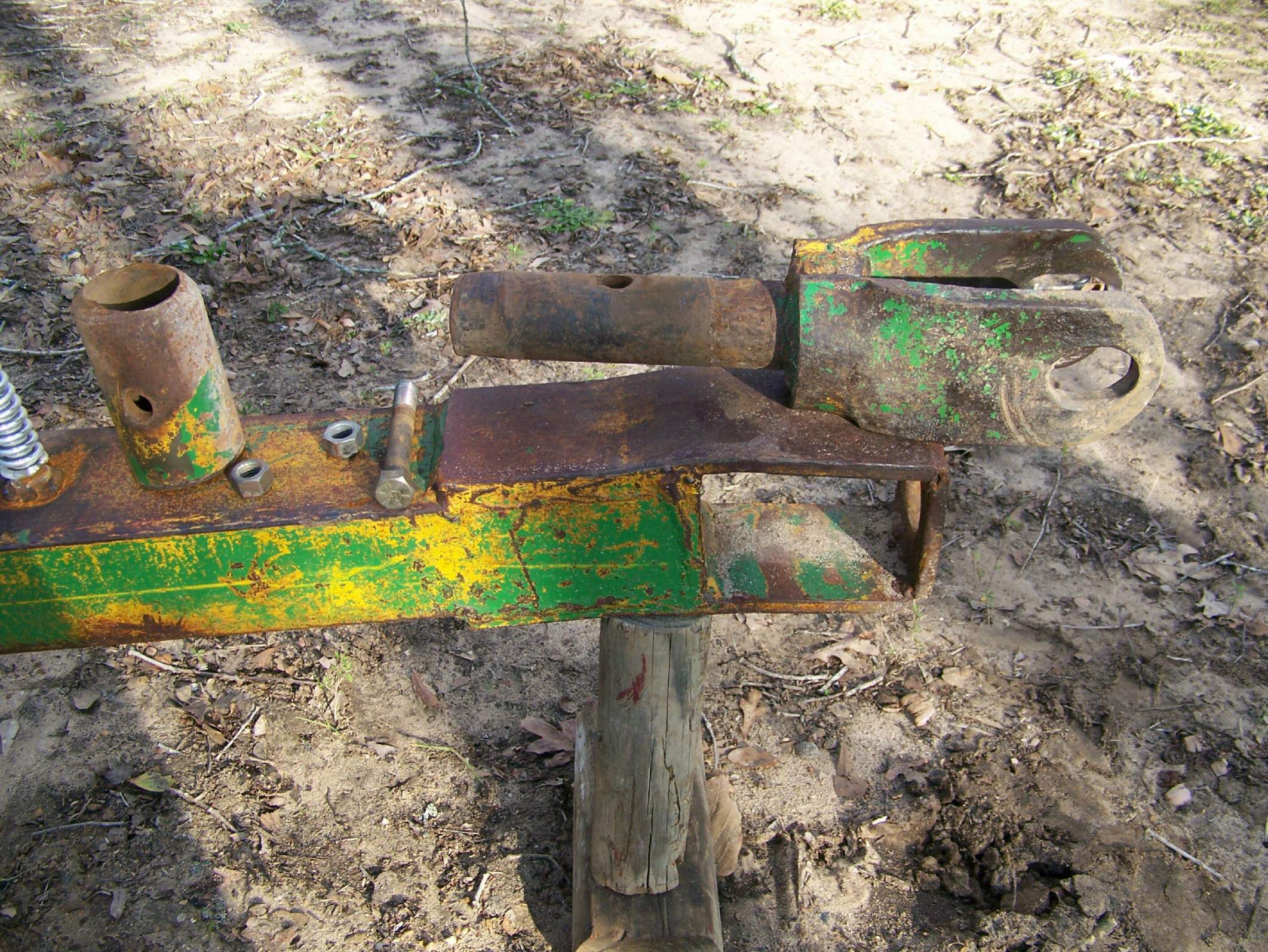

I forgot to watch the hitch, but when I hit an old hidden large root or stump, it really gave me a shudder or as you stated.....chugging. Just from moving it around and on and off the trailer and unhitching it yesterday, I'd say eventually the hitch hole will need to be repaired or rebuilt. The edge of the hole that was welded up has distorted. That it and hitch welds are so ugly...........I mentioned remaking it to the welder. I would like to remake it with less gap between the upper and lower plates.

Why not weld another thick plate on both insides of the hitch fork to lessen the area (Gap) in there and that will also give you a base for welding the elongated holes back round and the new holes in the added plate would strengthen the holes...1/2" plate should work..lessen the gap by an inch.

It is hard to tell by the photos, but the top and lower plates have been heated and curved to fit the round "pivot" section of the hitch by someone that did a sloppy job. Hard to fit new plates to it. I want to cut it all off at the round piece and weld on a 3 inch block to it, then weld upper and lower new plates to the block.

I had a hitch situation like you mention and it needed to be squeezed together. If it's steel, heat and bend. if cast it's no dice. Mine was steel and not quite long enough so I had a shop cut off the old flat hitch pieces and weld on new ones that were 6 inches longer and then squeeze them together. I can get photos if you need but there is my old thread out there "cultimulcher" that deals with the before aspect. I needed help welding the 1/2" plate.
