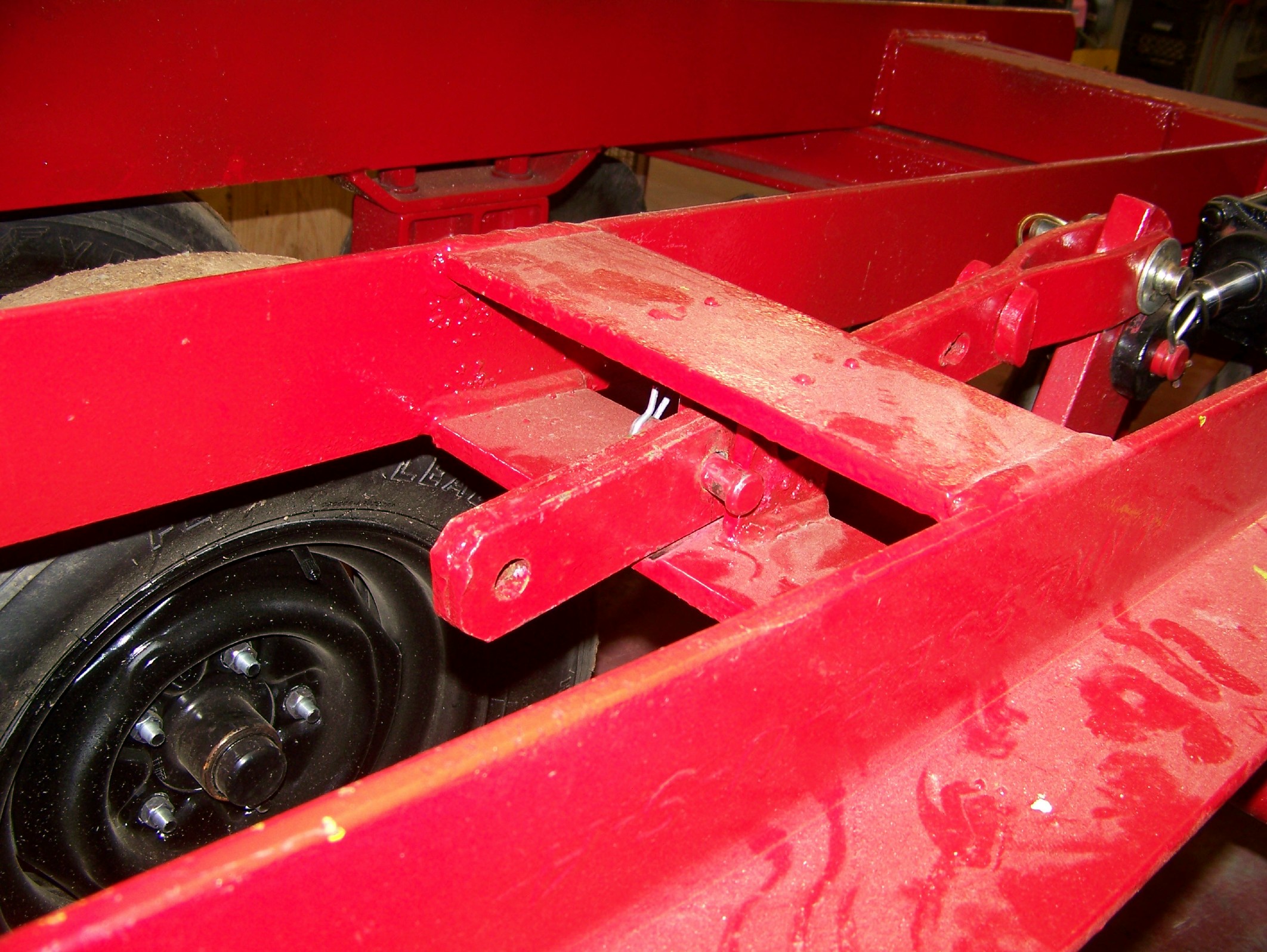

I drilled 3 new holes in the wheel transport lock beam. I now can disc shallow if needed. Seems the cylinder leaks internally and the lock will allow about 3-4 inch penetration. Hopefully this is all that is needed for bermuda grass seed near treesl...........................which is almost all of my property.

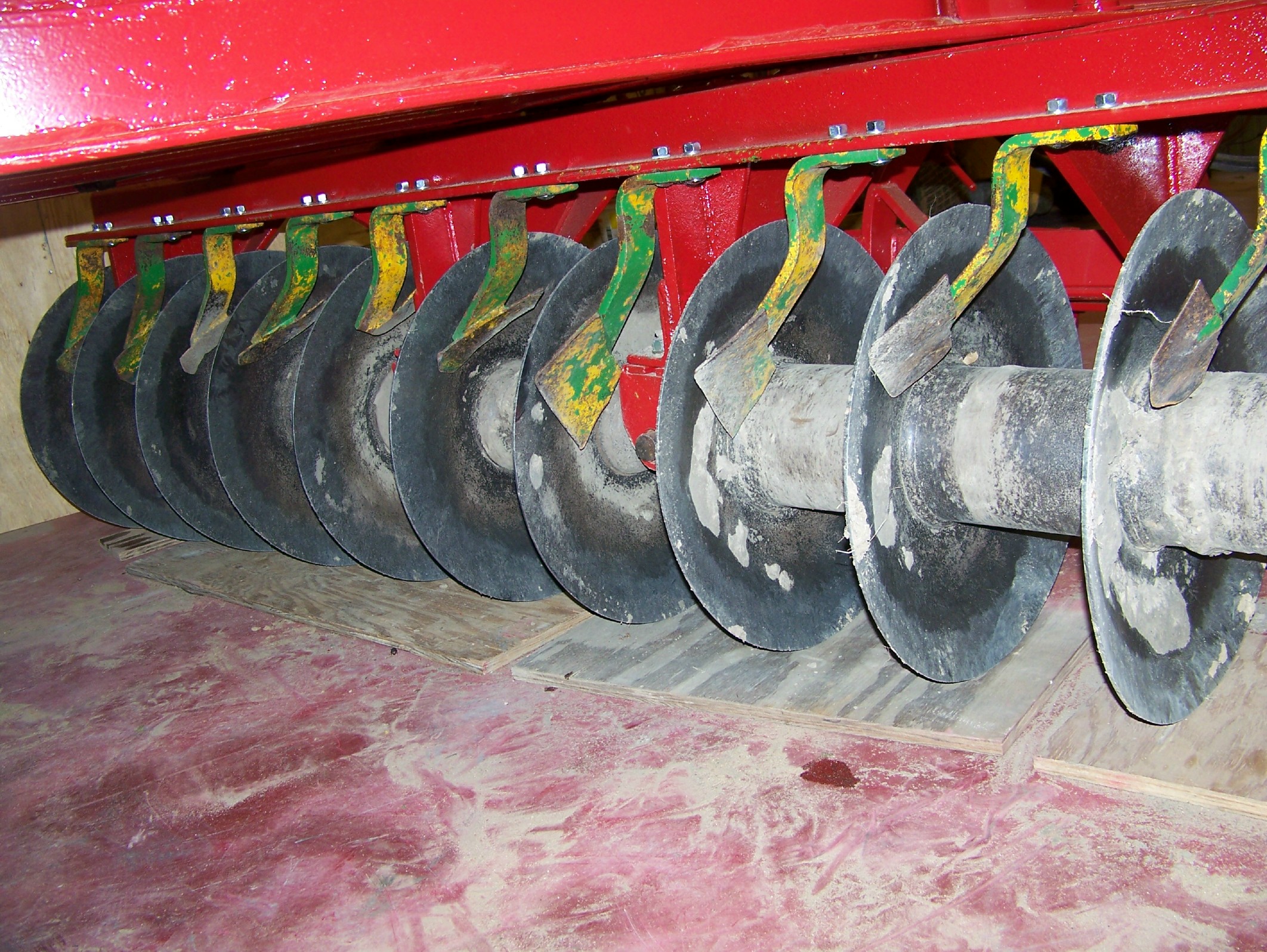

I also installed all scrapers on front mainly for disc pan protection. It will take some time remaking all of these. I need to buy a gas ax and welder and this "after" project will need a lots of gas ax bending and shaping. I only have 11 wore out ones and need 22............11 left and 11 right hand.
hugs, Brandi
