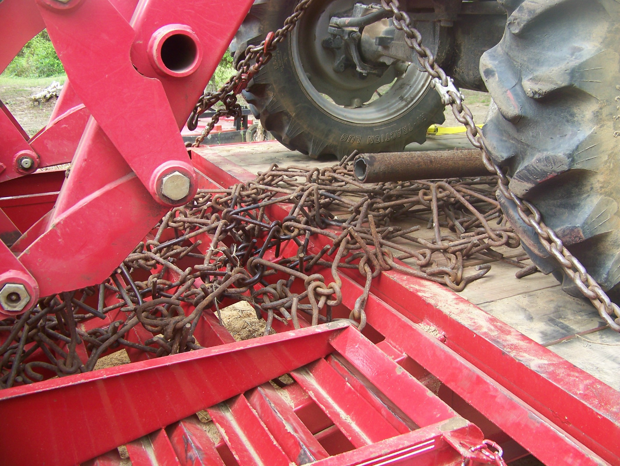

A big piece of old chain link fence chained back from the disk helps but your turning radius gets bigger.
Ron,
Looks like I will go with chain link. Should the spreader bar for chain link be attached to one point on the disc or attached to two points on the disc? Guess I need to search Craigslist for some fence now.

If you go with a "fence" type thing I would buy the commercially made chain harrow. They work great and do a much better job compared with a piece of fence. You can run them in two directions as well as upside down, depending on the finish you want. They distribute soil very well. The awkward part is you need a loader to load and unlload the thing.
There is also a drag type spike harrow that does a great job and either of these can be pulled behind the disc if the field is big enough so you can turn.
If you plan on packing the ground, a cultimulcher that has two packers with spring tines in the middle will do a much better job and leave a seedbed finish. A cultipacker, that has no tines in the middle, will show the tire tracks after the ground is packed because it lacks the ability to cultivate the ground after the tire tracks are left. There have been threads with photos on these topics.

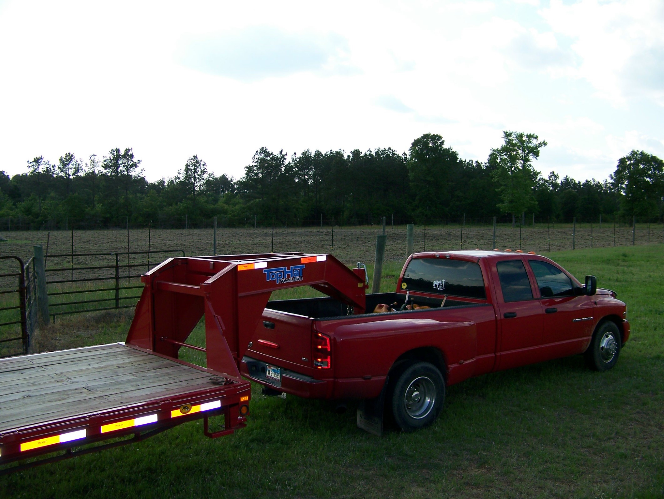

It took a while, but I got the disc, tractor, and drag harrow loaded on the trailer. I put the drag harrow under the tractor, but didn't like it there. Only other place to put it is on top of the disc, which I didn't wanna do.

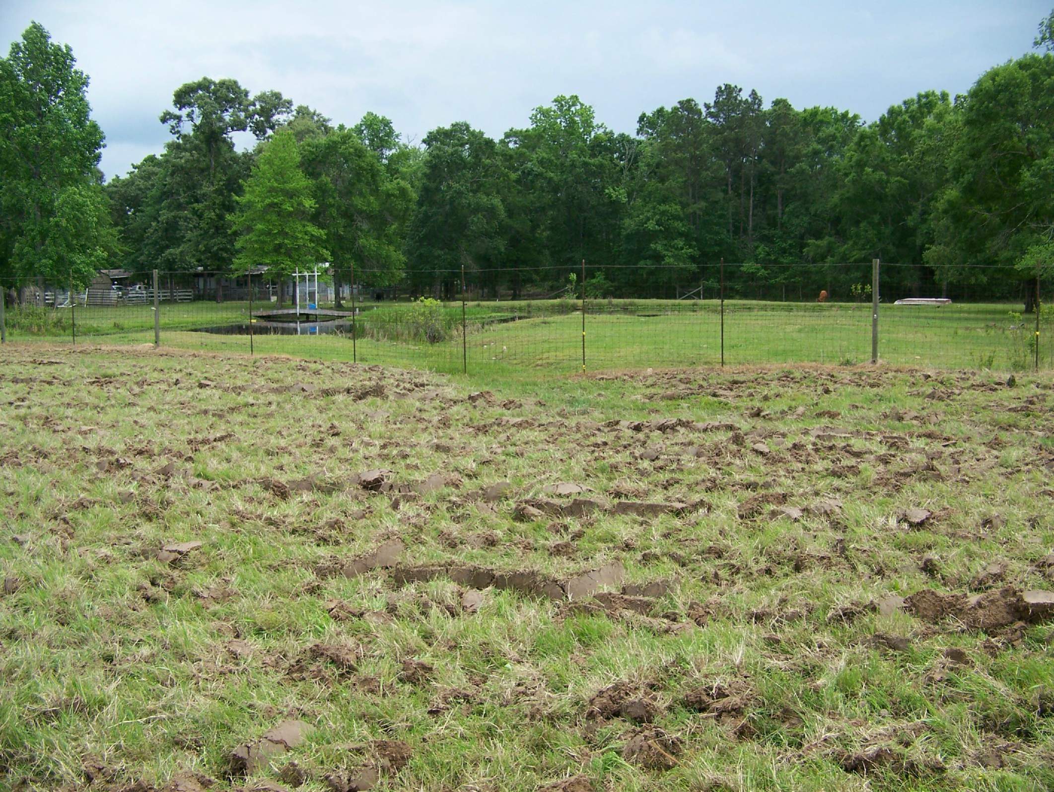

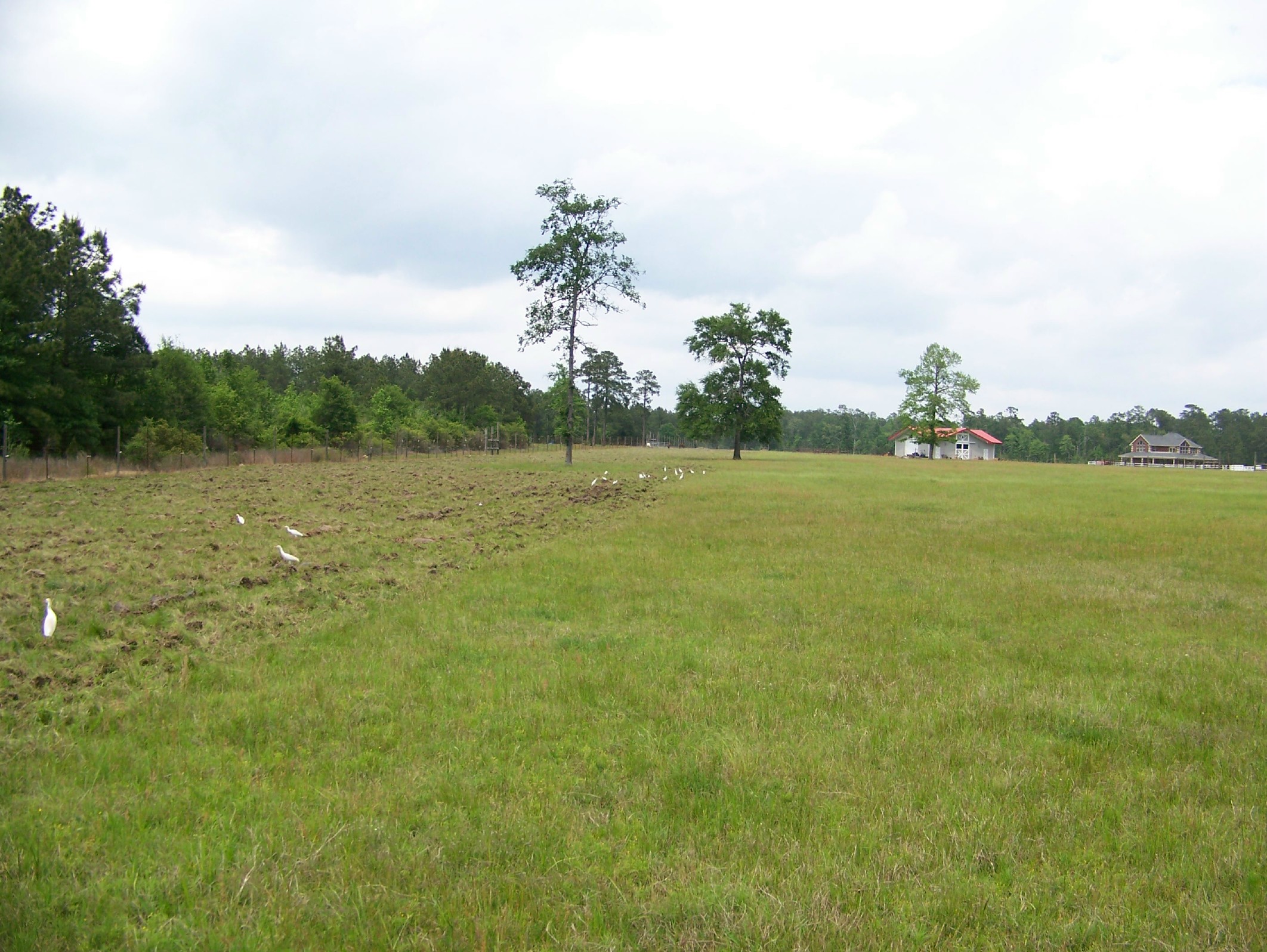

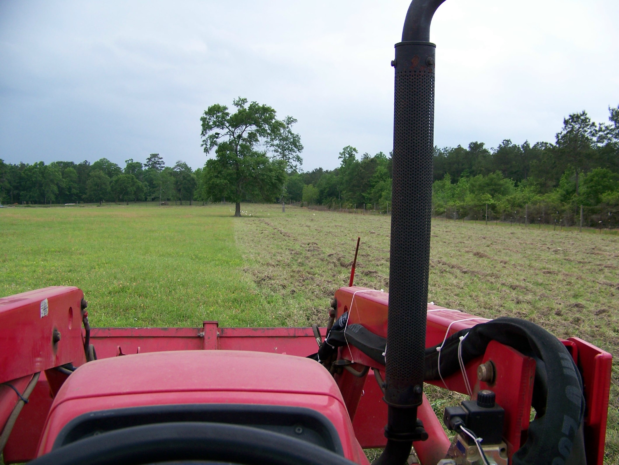

The hay patch was a triangle with a handful of huge trees in it. Very scenic. Pity I turned it into a sow's ear!
4-27-13 Seven Acre Triangle Patch...First Pass.jpg4-27-13 Hay Patch Looking Towards Neighbor's Pond.jpg4-27-13 First Pass by Neighbor's Pond.jpg

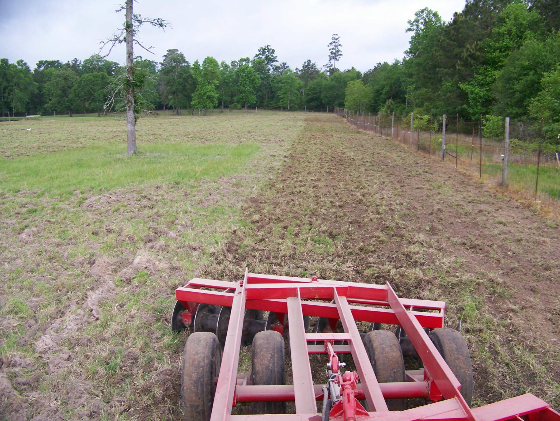

Just into the second pass, the owner came out and said it would take 3 passes. 4-27-13 Second Pass on Hay Patch.jpg
I was thinking 2 passes when I bid it. But I wanted to do right, good job. So I did 3 passes times 7 acres equaled 21 acres disc. Make that 28 acres including the final drag with the harrow. The Big RED Beast made me proud by pulling the disc and the disc even had some dirt "bulldozing" in front of the axle. So I cranked back on the leveling screw and put more weight on the rear. I pulled it all in 5th gear, but had to down shift to 4th in the low corner near the pond. The corner near the neighbor's pond had a ditch cutting across it and pulled mostly good thru it. The second pass had some wheel spinning and raising the disc slightly got me thru. The 6520 is at the bottom range of horsepower to use. If I had more hp, I would have finished way faster. But hey, it is all a learning curve. I need to move the rear disc over a little as the front disc is throwing to much dirt the rear disc is not smoothing out. So the disc has 4 bolt holes on each side and a huge center pivot bolt. So I move it counter clockwise one hole should reduce hp requirements and cure the furrow problem. I hesitate doing this as the bolts holding the gangs in position are "J" shaped bolts. Very special. I'm gonna see about buying new ones before I try to pivot the rear gang.

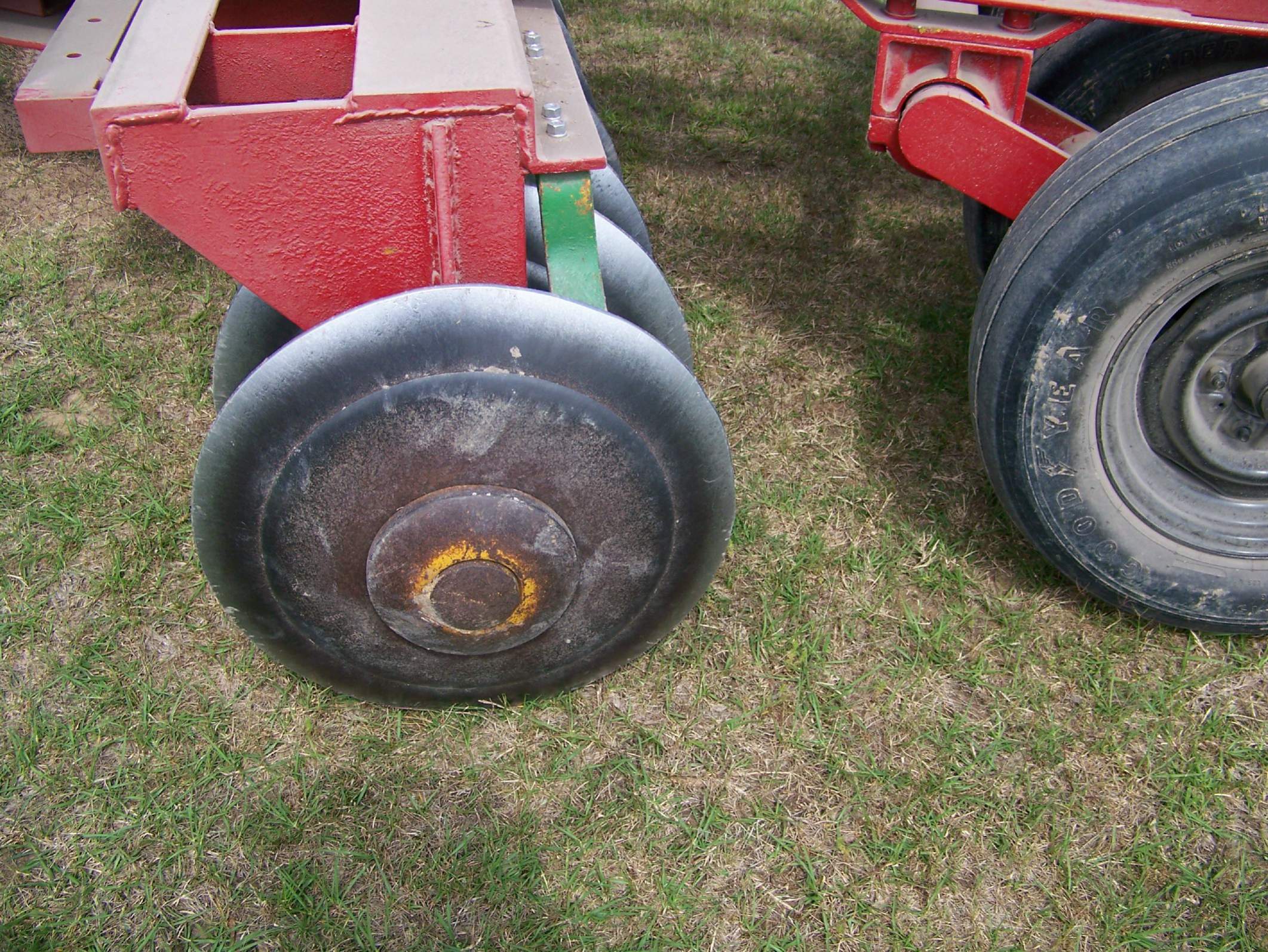

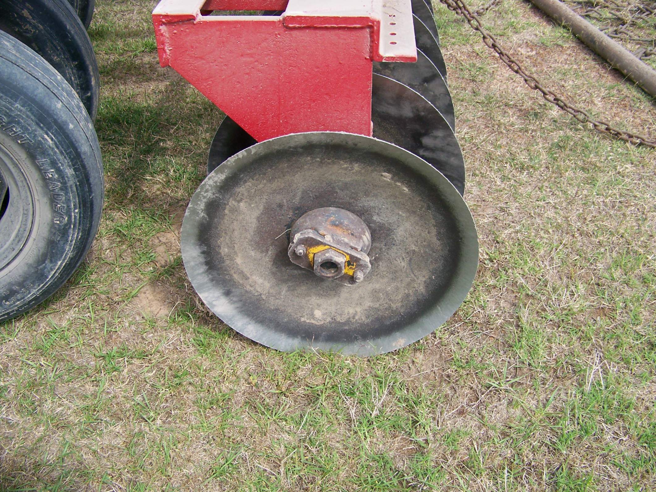

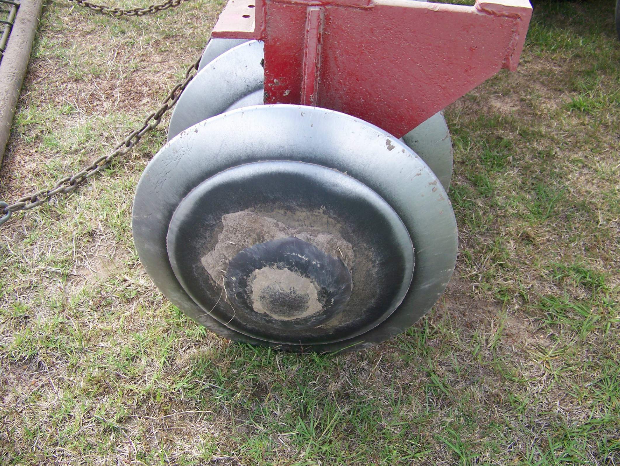

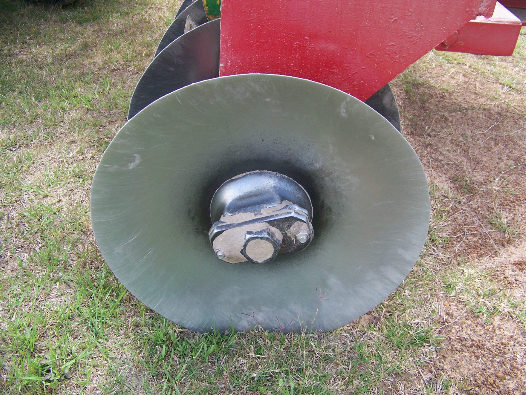

The discs on the right side of the disc really came out polished.
While the left side disc not so much in polish.
4-28-13 Barely Polished Left Front Disc.jpg4-28-13 Unpolished Left Front Disc.jpg

Brandi, the next time that you disk, try running on the right side of what has been disked. You may need to start in the middle. Most guys will only do 10 passes or so and then move over and start again, but a lot of that depends on the property layout. You should find that the berms that you are now getting will pretty much go away.
