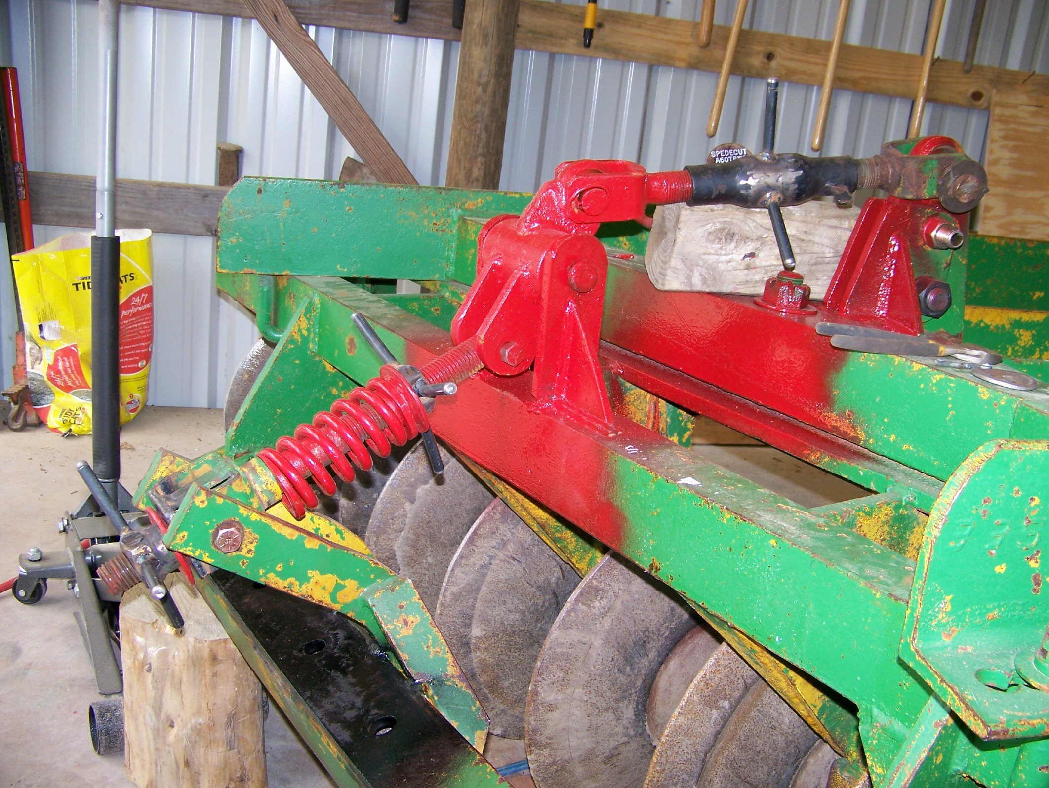

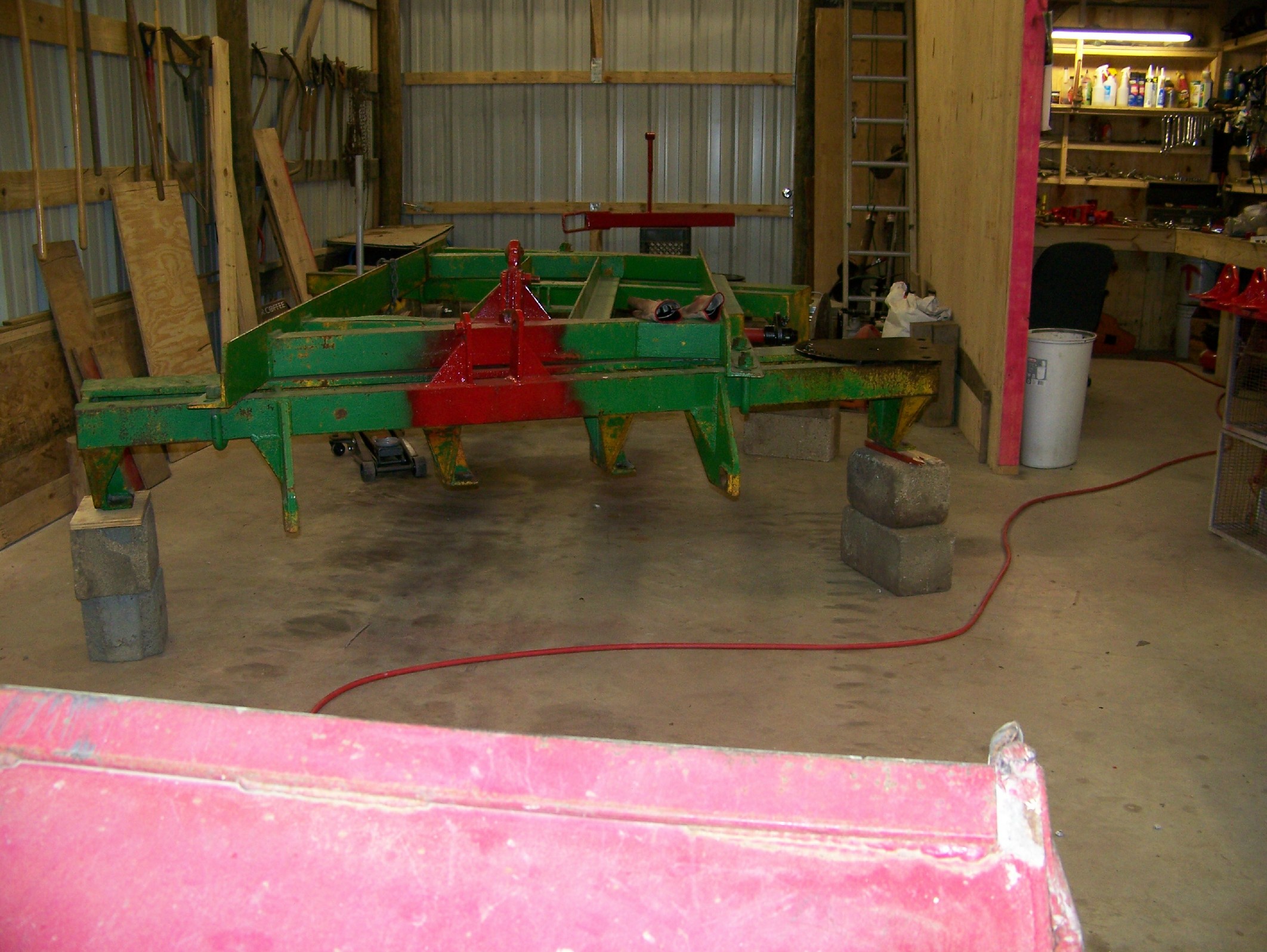

Thanks BR,
I realized while painting the wheels that the stems are rubber. At least they should be steel. I'll either have to live with it, or take it somewhere they can remove the tire. I don't think tire shops want to put thick beaded aircraft tires on their mount machines. But I could ask. I would have to wait where I bought the tires, an hour after work for them to open, to have them do it.
I had one 3 inch pipe nipple welded to the rear rim of my old Ford 3055 (photo above) when I had a flat. Never got the chance to install the other rear valve stem nipple!
hugs, Brandi
I don't know how many thousands of hours I ran heavy breaking disk like yours and also tandem disks and all the tires had rubber stems. Never had a problem with a stem breaking. The tires are generally far enough back that no dirt will hit them. When you get a bigger tractor you will be carrying those tire wheels up so no worry then for sure.
Also it as shame to ruin your good paint job welding on it afterwards, but fixing small cracks before they break is best thing.

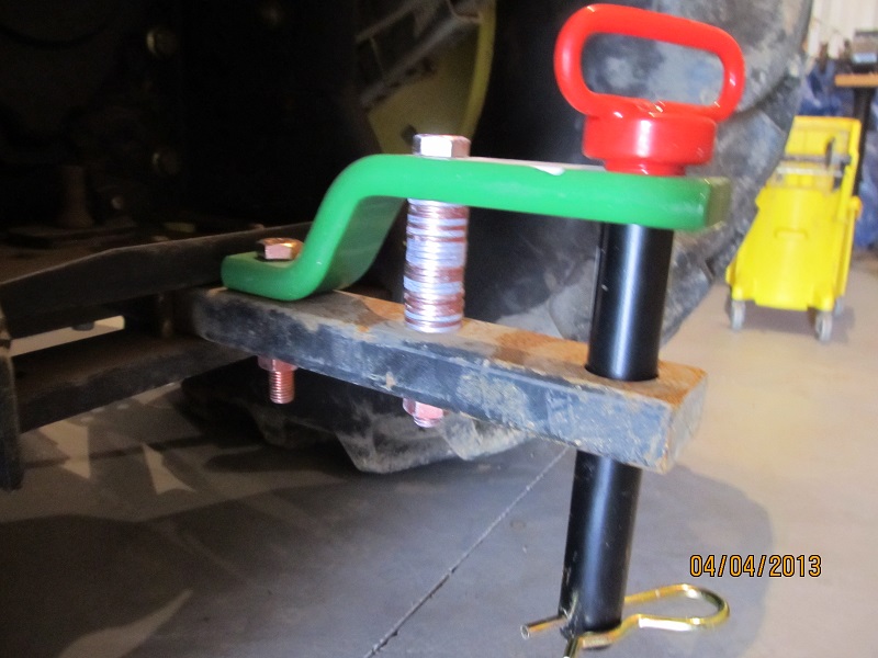

Two points. When I pull heavy implements, I add a "hammer strap" to my drawbar to reduce wear on the drawbar from the "chugging" back and forth of the tool action. The hammer strap is just a sort-of stepped-up short piece of drawbar that bolts to the drawbar and reduces drawbar wear. If you need a picture let me know. Not totally necessary but heplful. Depth is with the cylinder but really should be all the way down for the most aggressive action. This offset disc is going to pull hard but do a wonderful job.
And yes, you have to lift on the turns. I pull similar heavy items and lift and slide around the corners. With rib implement or aircraft ties they slide pretty easy. Not so with car tires as sliding is much more difficult.

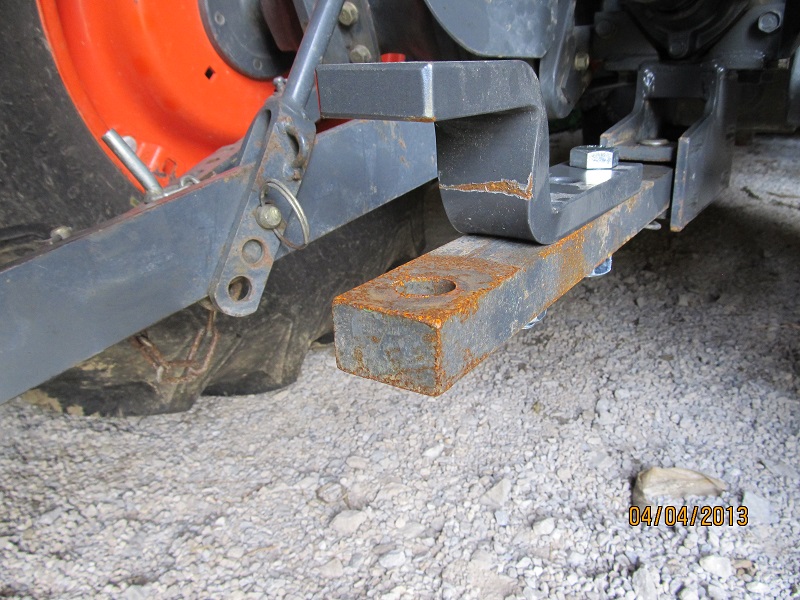

/ Amco Offset Disc #109
Sixdogs,
...Post the picture if you get time.

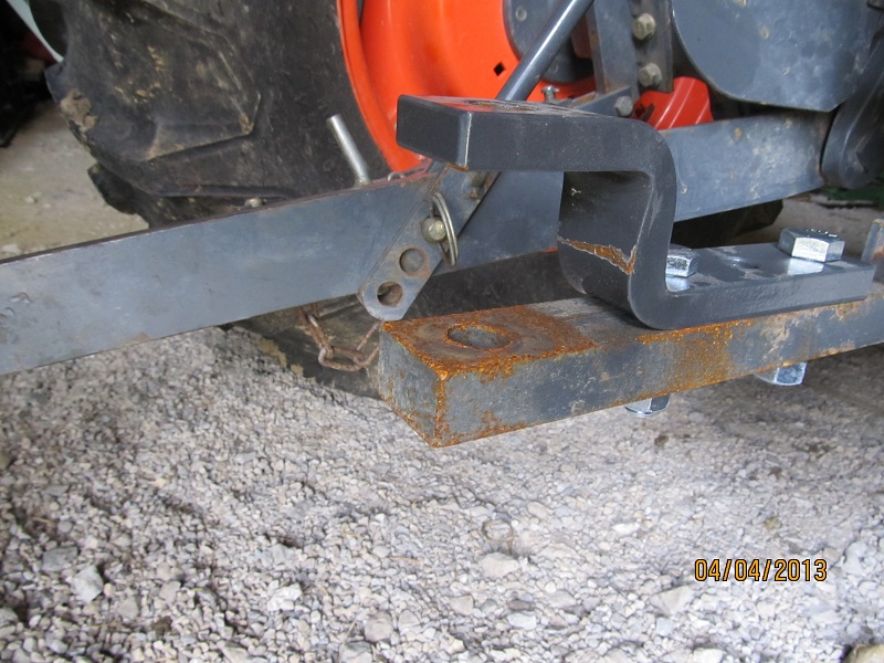

Here you go. The first is on a 50 HP Kubota.
This next one is on my JD 5520 and is not fully set up. JD wanted $65 for the hammerstrap, which is OK, and I think $165, which is not OK, for the bolt and other misc that I think I can get by without. This is shown in mock-up stage with washers being used for spacers. I really don't think it matters what the spacer is but we'll see how it plays out. Anyway, here it is.
As noted, the hammerstrap keeps the drawbar from getting prematurely beat up by having, in effect, a second drawbar to lessen the impact.
/ Amco Offset Disc #110
Looks good!
Thanks for the pics.
Ron
/ Amco Offset Disc #112
How does the pin fit on the Kubota? It does not look square (lined up). Looks slightly canted. Or is it the photo and it just looks off?
Inquiring minds are inquisitive..
:thumbsup::confused:
Tom
No, it's all lined up exact. Must be optical illusion. The top may appear slightly canted but the pin goes in just fine and the pin is nearly the same diameter as the hole.

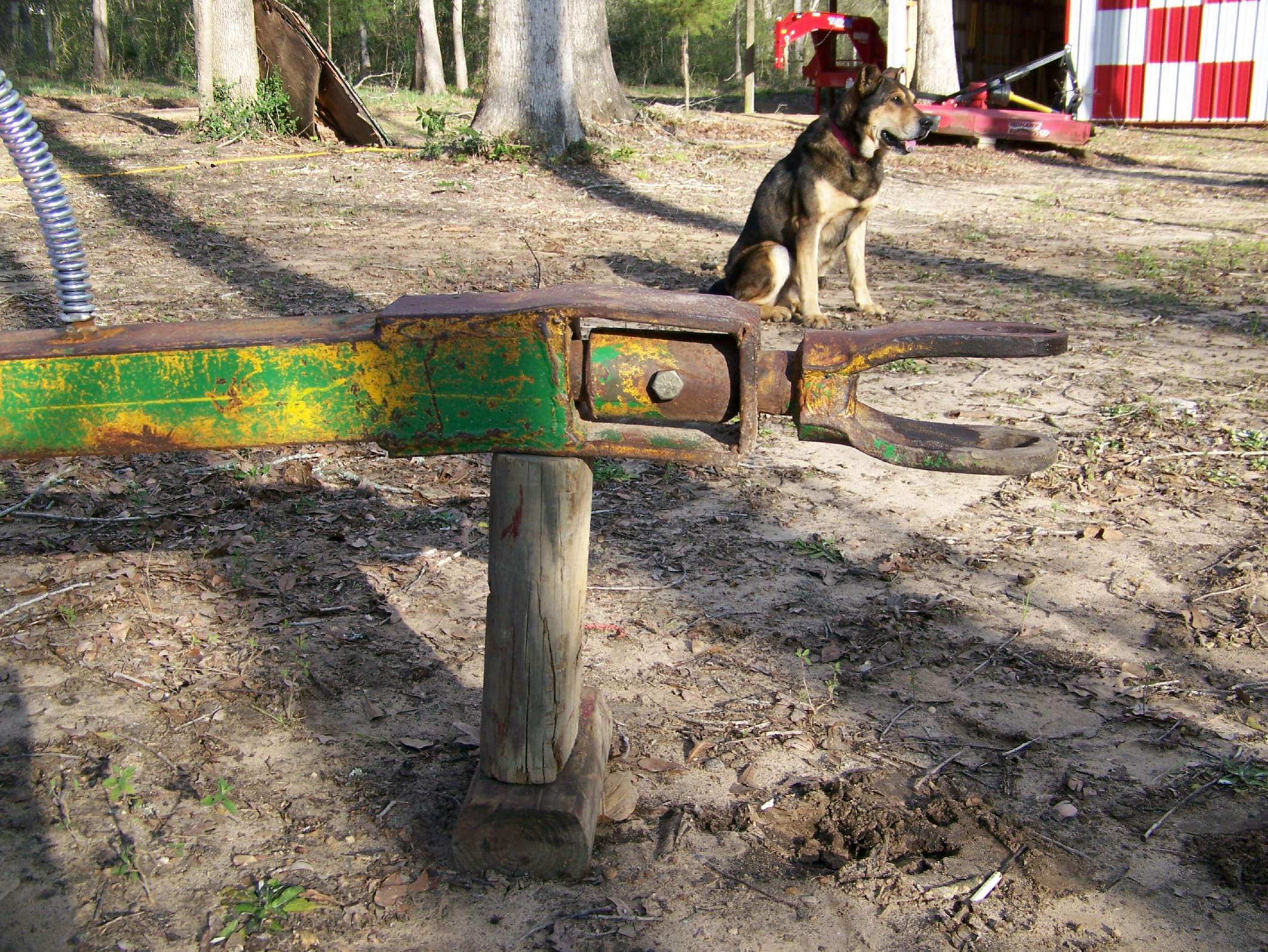

Do you see any advantage in using a hammer strap with my hitch that pivots on the tongue?3-10-13 Disc Hitch.jpg
What would the advantage be on a hitch like mine, other that the pin wearing the holes?
hugs, Brandi

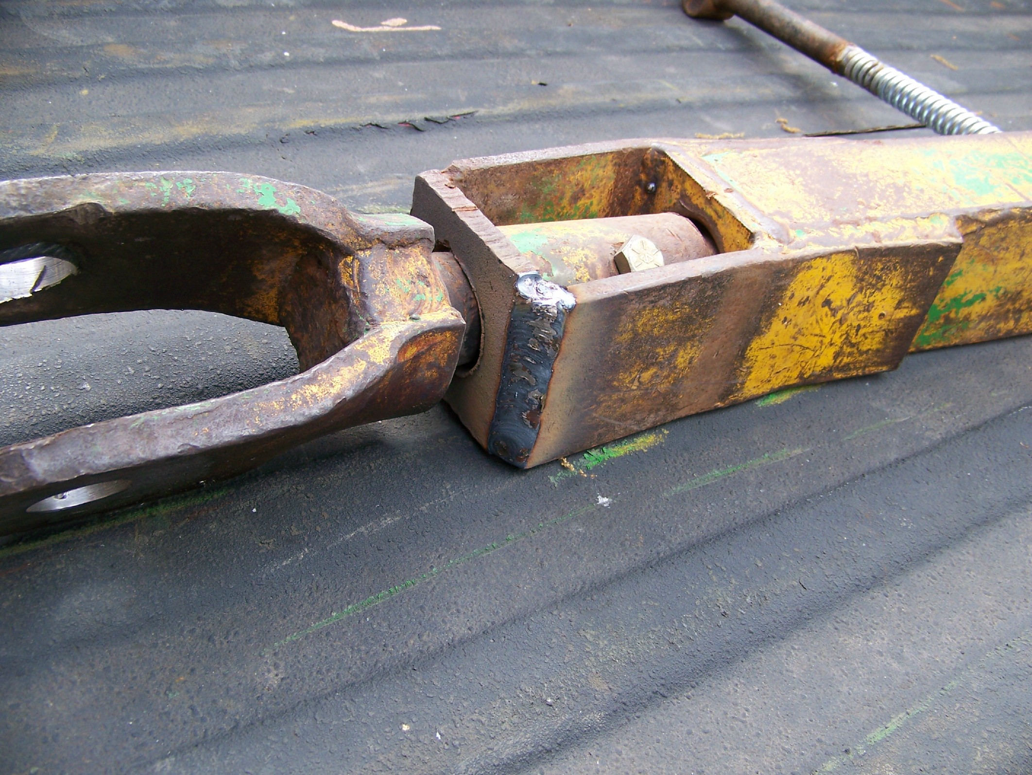

/ Amco Offset Disc #114
Sixdogs,
Do you see any advantage in using a hammer strap with my hitch that pivots on the tongue?View attachment 311598
hugs, Brandi

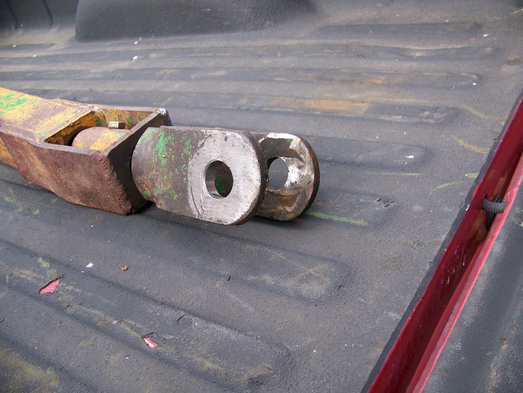

That swivel will help you in the twisting action of the disc and that's a good thing. The benefit of the hammer strap is almost totally with the action on the drawbar hole. Beyond that not much need for it.
I would not get a hammer strap just yet until you use it a bit and see how it behaves. I also suspect the hole in the disc tongue is a lot bigger than the hole in the drawbar and will give you that "chugging" or "hunting" tugging action I mention. Try the disc and come back to it but I'll guess you'll need to have the hole in the disc tongue made smaller and that you will ultimately need a hammer strap.
That is one heck of a rugged offset disc. Carry a spare drawbar pin and make sure there is a hole to put a click pin or hairpin in to keep it from popping out. Also, don't be tempted to use a grade 8 bolt. Normal hitch pins are a grade 5 and the grade 8 will wear the drawbar faster.

Wow.........Grade 5. I just bought a Grade 8 bolt 8 inches long to use in the tractor's front hitch to just move it around.
hugs, Brandi

She showed an extreme example of the wear on the disk tongue a few pages back that you have been explaining the hammer strap fix for on the tow bar.
She or someone repaired it and drilled a new hole. A snug fitting pin or a smaller one with a pipe sleeve will probably keep the slap from wearing the tongue into a slot for a long time on the disk.
I really don't like fooling with sleeves and I don't like the clips you show on your pin. They are nice to pull out but too easy to be pulled out and lost by something while in use. A snug fitting pin, like you show is the best solution unless it gets bent a little; then it's time for the torch. Were the holes in your draw bar already there for the hammer strap piece? I'm recalling an extra hole or two in my old Ford draw bar to mount a loop to hold the baler safety chain. I don't remember if the CNH has extra holes or not. One of them, at least, is shaped like your strap would be if it were on the bottom to lower the pin hole down closer to the ground for proper tongue height on the implements. Guess I better go look. I don't normally leave the draw bars on the tractors except for making hay.
