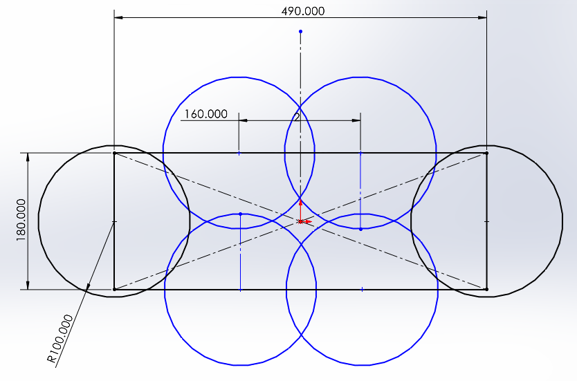

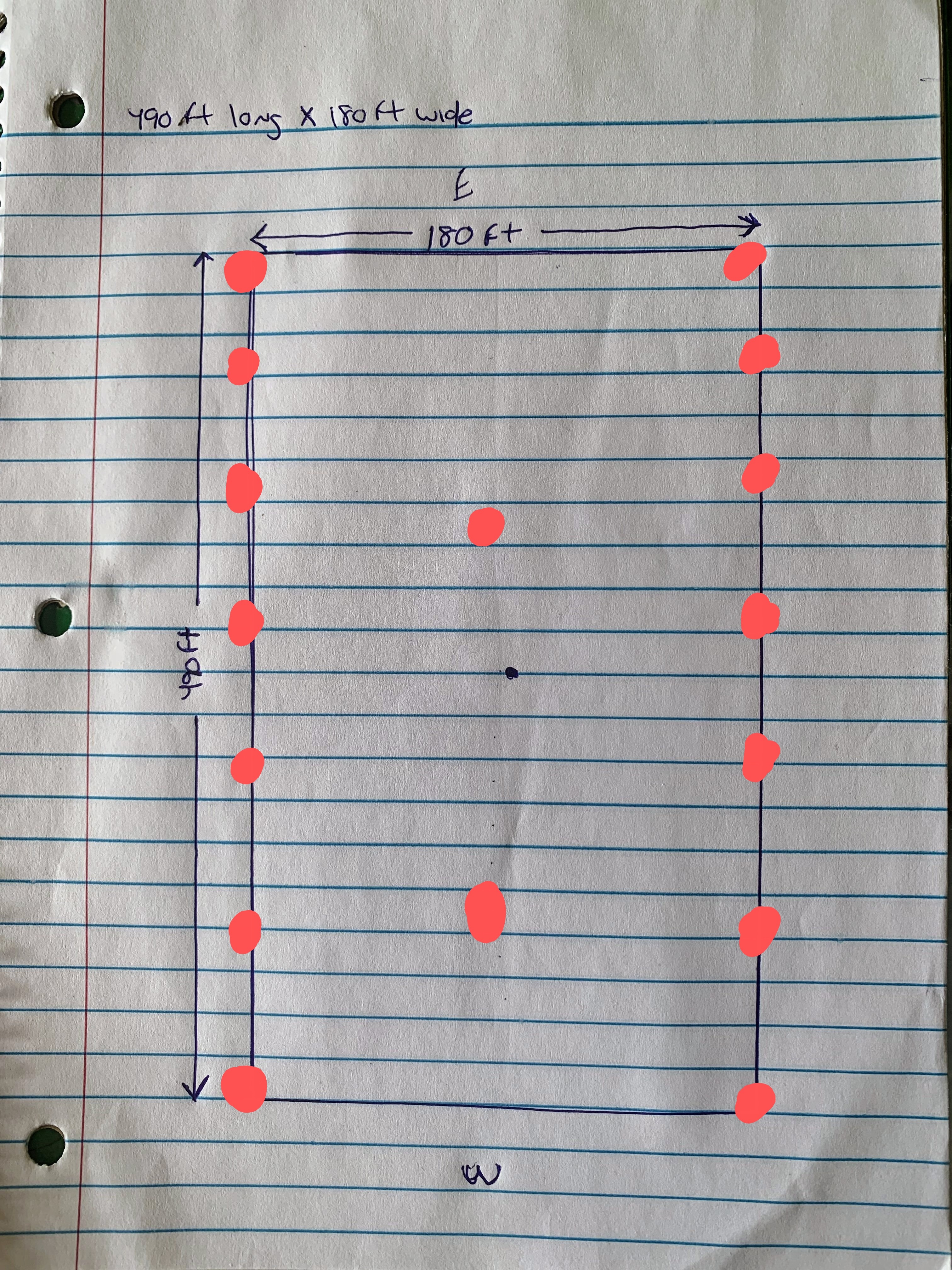

I dunno, my trig may be rusty but 6 down the middle of the 180 length should do it. . .
1st one starts 41' from sideline and the rest are spaced 82'
I could be wrong but I think that does it

Simple cheat: Download the Rainbird Sprinkler Design Software.
Let it optimize for heads with 100-ft reach. Then install quick coupling valves everywhere the software says to put a head.

I thought about that as well, but I think it'll want to put them in the corners, along the edges, and down the middle, like a normal sprinkler system would do.
The OP specifically said they want them along the edges only, and, that they were going to definitely put them in the corners as well.

My scale is a bit off...
Putting the hydrants at the border might make more sense from a land use standpoint not having them in the way but strictly based on covering the area you’re wasting half the potential radius putting them on the perimeter.
If you optimize based on coverage alone and not location, it would save 4 hydrants.
I would argue those 4 additional hydrants add better value by maximizing real space than the cost savings they would produce.
Absolutely.
You're going to be trenching to put in the water lines; wherever a water line is, there's very little incremental cost to add spigots along the way - go hog wild and don't try to minimize them.
I'd minimize what's in the middle and run the pipes deep there....
