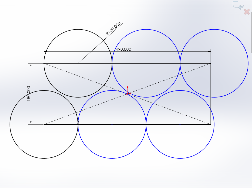

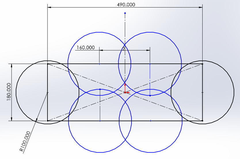

I know this isn't what you asked for, but you could also buy some quick connect fittings for your garden hose along with some short (10'-20') hoses that can bridge the gaps. That would get you down to 4 spigots. Three 15' hoses would allow you to get down to 4 spigots and only leave a very small triangle on each end that you couldn't reach. Otherwise, you're looking at 6 spigots as shown above. If you're not happy with those small gaps, you're looking at 8 spigots.

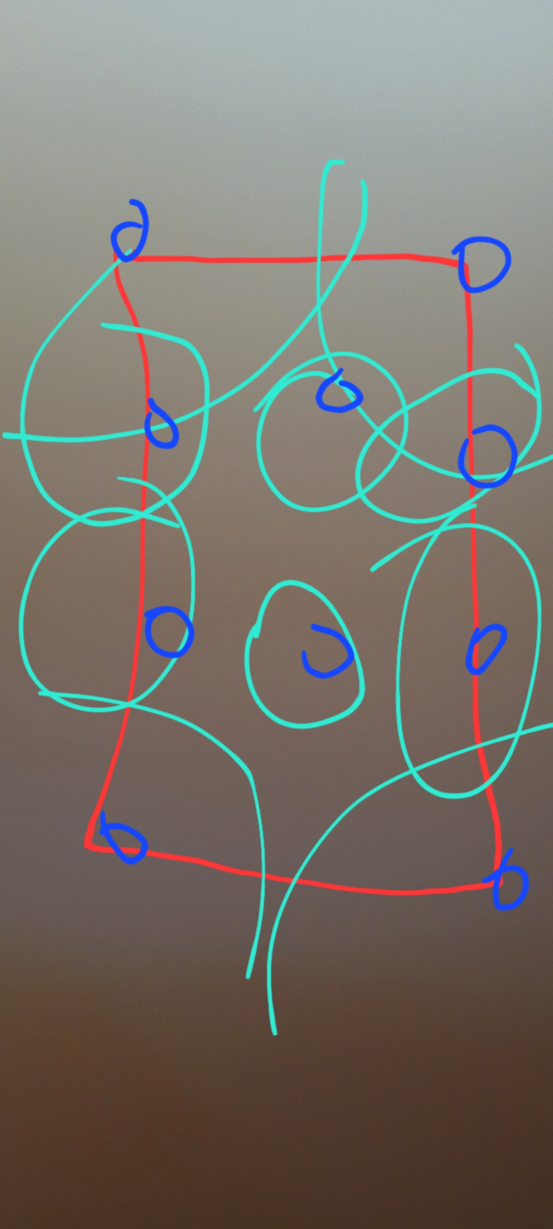

I think you need 10 spigots. If you want to start with one in each corner. Dark blue being a spigot light blue being coverage.

I tend to consider this a right angle triangle problem, rather then a circle. If you draw a line down the center it will be 90 ft from each side.
If you put a spigot at 35 ft up the side line. You will have a right angle triangle, side A is 90 ft, side B is 35 ft, and the Hypotenuse C will be calculated at 96.57 ft - so a 100 ft hose would reach that corner (point 0 on the center line).
If you flip the triangle over top to bottom you would have a second point on the center line at 70 ft. So you would have a rectangle 70 ft by 90 ft and your hose would reach both corners on the center line from the center of the side line.
Do this 7 times on one side and you have half the area covered 490 ft by 90 ft.
Do 7 spigots on each side and you have everything covered, or you could run 7 spigots up the center line and reach every corner with a 96.57 ft hose.
The math says you could use 6 spigots but your hose would have to be 98.83 ft long.
I think the math is correct, it has been a few years.

Don't forget that you need to walk to the bib to turn it on and off, too. Walking is good for you, but forcing it leads one to consider just leaving pressure in the hose all the time with a valve at the end of the hose... like I do a lot... it's ok in the winter, but I force myself to turn the hose on and off at the bib (and release the pressure in the hose) when it gets hotter because the hose is obviously stretching with piping hot water softening the material.
Near the top of my to-do list is actually to put in another hose bib near where I'm mostly using water. It's not where I would've expected to want a hose bib ten years ago, but it's where I want it, now.
   / Any mathmeticians here #29
a = 100 (length of hose)
h = 90 (1/2 width of plot)
b = 87.178 feet maximum distance between spigots
I like things to be symmetrical.
With spigots in the corners you'll need 7 spaced evenly along each long side, that would put them at 81' 8" apart.
If instead of placing them at the corners you put the first one 40' 10" from the corner and then spaced them the same in between (81' 8") you could get away with 6 spigots along each long side.
Please don't assume I am right, I would lay this out using survey stakes and take messurments.

For fun, I asked ChatGPT to give me a diagram based on hoses with a practical length of 80', and ChatGPT is too stupid to get it right. Amusing. ChatGPT is way overrated. Gets things wrong all the time.
You're really asking a lot, trying to get a 100' hose to reach the center line of a 180'-wide field, assuming the hose is 90' long in practical use, which is optimistic. That's 180' divided by two, so it puts you just at the center. Then when you swing the hose at an angle other than 90 degrees, the end swings away from the center.
   / Any mathmeticians here #34
Place spigots at 80-foot intervals along the 490-foot sides (left and right, at
0,80,160,240,320,400,480 and one spigot at the midpoint of each 180-foot side or 90'. This requires 16 spigots total to ensure a 100 ft hose can reach every point inside the 180' x 490' rectangle without dead spots.

My scale is a bit off...
   / Any mathmeticians here #36
Those longer hoses are looking better and better.
