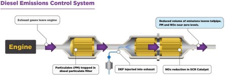

So, with your general knowledge of a trucks workings.... You don't see how a malfunctioning DEF system can burn valves the same way a clogged up catalytic converter does a gas motor?
No I don't see how that can happen. A failure of the def system causes urea to not be injected into the exhaust. It's not causing a restriction as your alluding to with a plugged cataylitic converter.
The only way def burns valve's, is by putting def fluid in the fuel tank and not in the def tank.
   / Anyone have a 17 super duty? #162
DEF is injected into a particulate filter to burn off the particles. Too much DEF, clogged system, too little DEF, clogged system. You need to further your general knowledge.
   / Anyone have a 17 super duty? #163
But would DEF, which is mostly water, pass thru the fuel filters and actually get to the injectors in enough quantity to cause valve issues?
Well def is not injected Into the particulate filter. It's injected into the scr, select catylist reduction. Maybe you should up your general knowledge, and the most common failures associated with it.
   / Anyone have a 17 super duty? #167
You are correct.
But any restriction in the exhaust, of any engine in the world that has ever been produced in the history of mankind will burn exhaust valves if not corrected. It matters not if it is caused by DEF malfunctions, a used up CAT or a rock crushed pipe. When the exhaust can't flow, the exhaust valves can't cool. That is a fact. Stating that DEF can't be the cause of valve failure is wrong.
   / Anyone have a 17 super duty? #168
You are correct.
Well, doesn't the exhaust flow through a turbo and particulate filter, which are both factory restrictions? The turbo is used as a exhaust break and the particulate filter only regens when almost plugged. Valves are fine for hundred's of thousands of miles.
I just don't see it, but I guess there could be an edge case.
If too much DEF is injected and it causes issues with the DPF regen process, bad things happen. Could it wreck exhaust valves? Maybe.
DEF is not part of the DPF regen process. DEF is injected in the exhaust stream AFTER the DPF.
