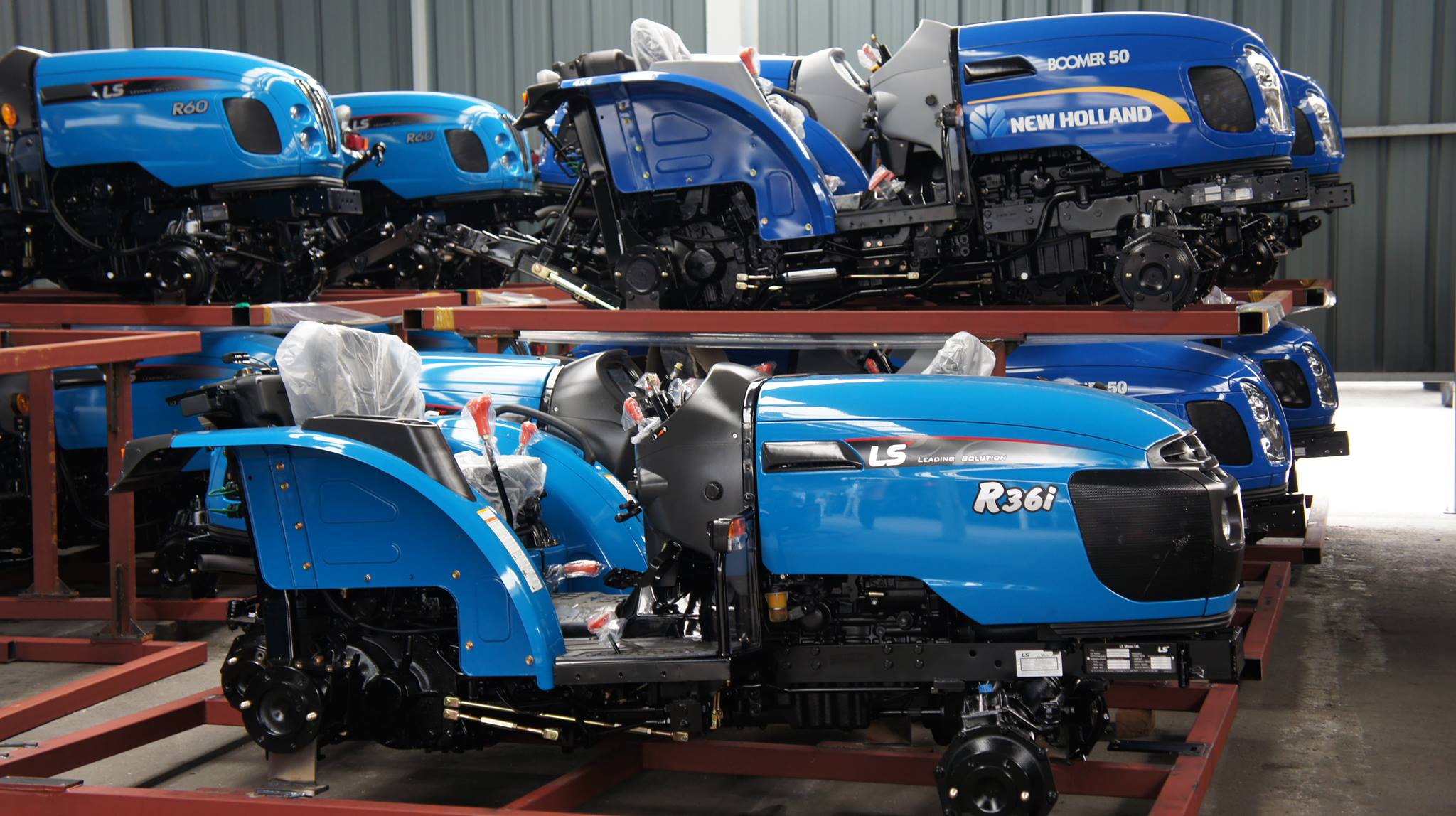

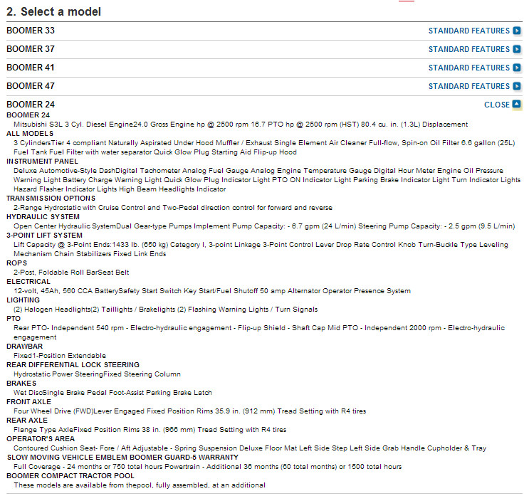

It exists in the "Build My Tractor" section of the NH site (see image below). The press release announcing it was dated late February 2014. Its just their version of the LS J2023H. They do exist. Here's one:
