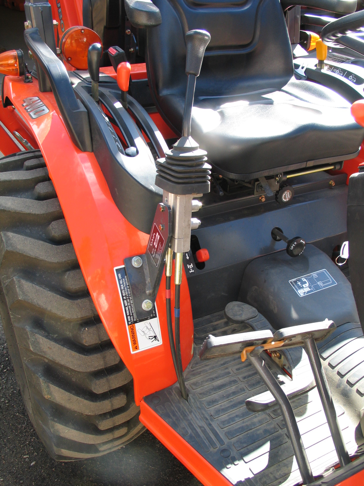

I've never seen a B3000 without a cab. Frankly, I still haven't figured out Kubota's game plan when they stripped the 3030 of most of it's deluxe features and renaming it a 3000. Are the new open station 3030s going to have the same fate? I dunno.
As far as the 3200 goes, you will have the wheelbase / width of the 2630 and 3030 / 3000 without the deluxe features. This will give you the larger lift capacity and ability to run the bigger implements. Also a bonus, in my opinion, is the 3200 uses the same integrated backhoe design of the 23/26/2920. It makes for a more compact, manueverable, TLB. Just take a look at a B30 / 2630 with a backhoe and see how it hangs off of the back of the tractor with a second seat for backhoe operation..... where the Kubota hoe on the 3200 tucks in tight to the tractor and uses the tractor seat as the backhoe seat.
The downside to the 3200, is it loses all the deluxe features. Quarter inching valve, not position control. No deluxe three point hitch which can make changing implements more of a chore. Steering box vs. hydrostatic steering. No suspended seat nor tilt wheel.
All of the above are excellent tractors, it just comes down to what features are most important to you.
In the interest of full discloseure ..... do some reading here on the 3200. There have been a few complaints about vibration. The best I can tell it has been attributed to Kubota 'leaning out' the engine to meet the newer emission requirements. It has been a small minority of 3200 owners..... but something you should know about.
If the joystick position is an issue for you, both the 2630 and 3030 can be ordered with the remote joystick of the cabbed tractors. You probably will not find one on a dealers lot set up this way, but it can be done and I'd expect the price difference from the loader mast mounted stick to be minimal. Here is a pic of member bandit67's 3030 that was ordered that way.
