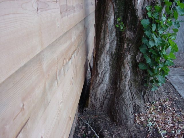

I found this today, I know it looks like it is visible. It is behind the N tree and when you are standing you don't see it. So one more to change out........

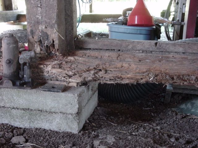

This is the other side of the rotten beam I found today, no apparent damage from the inside......
