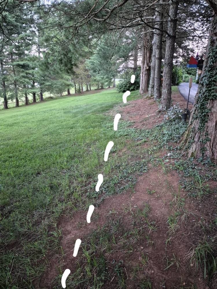

The fence contractor here said: "There ain't no way you're gonna hurt them trees."
I was afraid it would cause damage as well. Who knows? If I auger every 8 ft. I may get lucky not hitting many roots. I want fence fairly close, otherwise I'd be trying to mow grass. If I stay out about where dotted line is would be about right.
I need to remember where electric & water is buried.
   / Board fence ideas? #37
The fence and augering the holes won't hurt the trees, you disturbing way way less than 1/3 of the root system. I'm more worried about having a clear 6-8ft from fence to trees for mowing, brush control, keeping limbs off the fence.

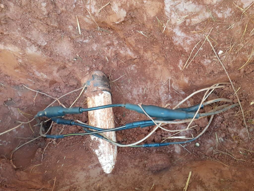

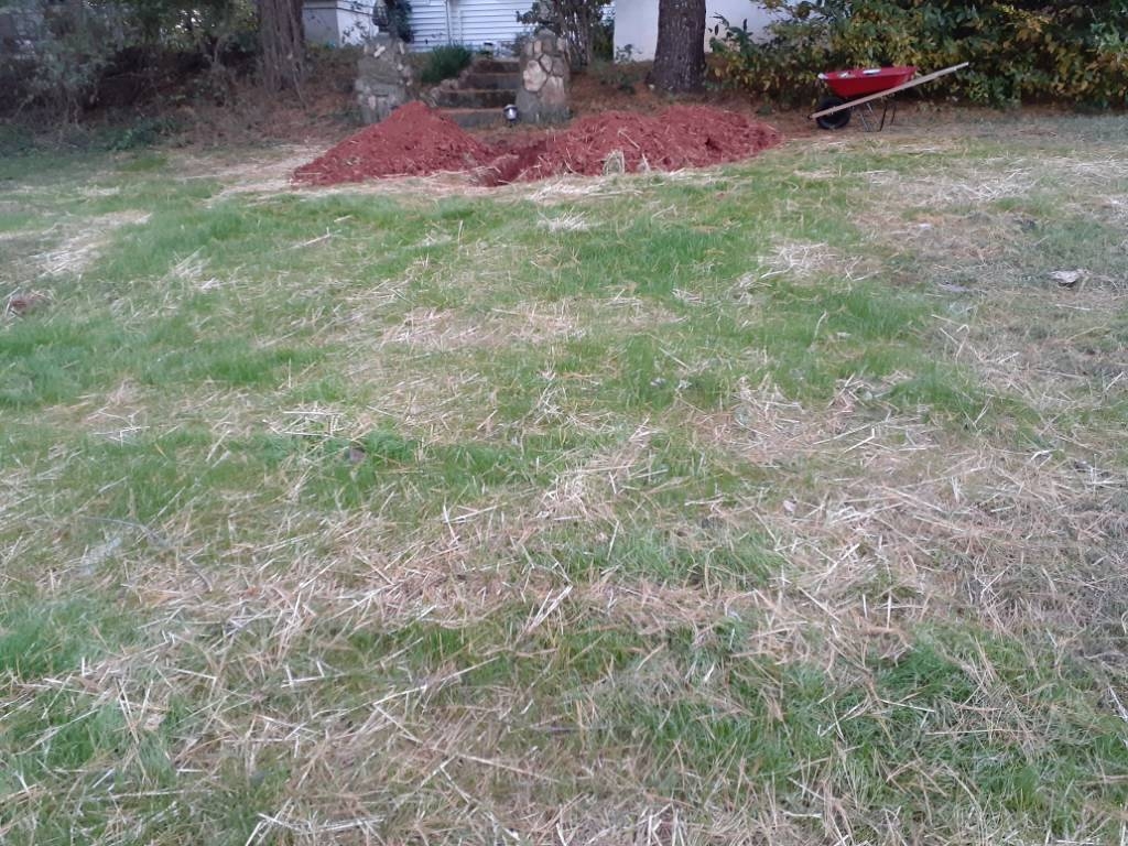

I'll need area marked carefully for electric, drain line and water! I'll use it as a starting point to avoid it. It's at bottom of steps I made years ago. These pictures a year ago when I had drain replaced.
Times like this I wished I had ground penetrating radar!
Miss Utility will mark if I slip them some cash.
Miss Utility will mark if I slip them some cash.View attachment 940269View attachment 940270
I think that getting the pipes wires traced and marked is likely to be worth whatever it costs...an ounce of prevention and all that. I found a used wire tracer for cheap and it was worth every penny to me, as the buried feeds to my outbuildings didn't go where I thought they would go, they zig-zag around. (And the internal property wires aren't on the 811 list, of course.)
