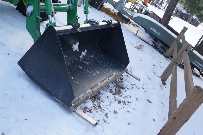

I wanted clevis hooks without going inside the bucket, so I made these:
I've wrapped chain around the clevis part and used the hooks from behind - works well.
