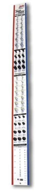

Our local TSC has a wide selection of nuts and that's how I found the correct size for a nut I have having a hard time finding. I used a thread pitch tool and ordered the nuts from Amazon. They didn't fit.. thought I was going crazy, went into TSC and found/bought the same nuts I had already ordered, M10 x 1.25. Turns out they shipped the wrong nuts (M10 x 1.5). Here's the tool: Grip Thread Pitch Gauge MM & SAE Markings - Hand Tool Sets - Amazon.com
