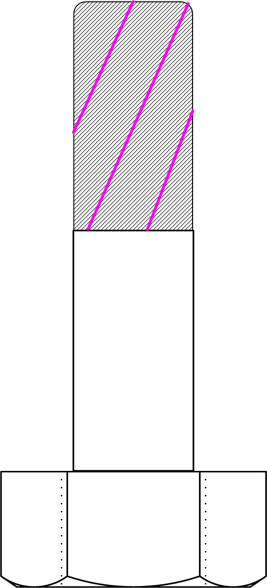

You can make your own thread chaser bolt by filing reliefs in the direction of the threads. Two or three will do.
