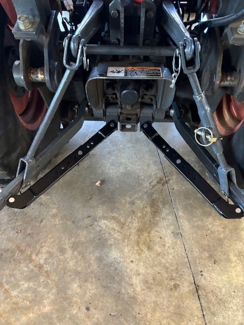

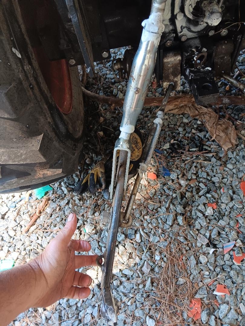

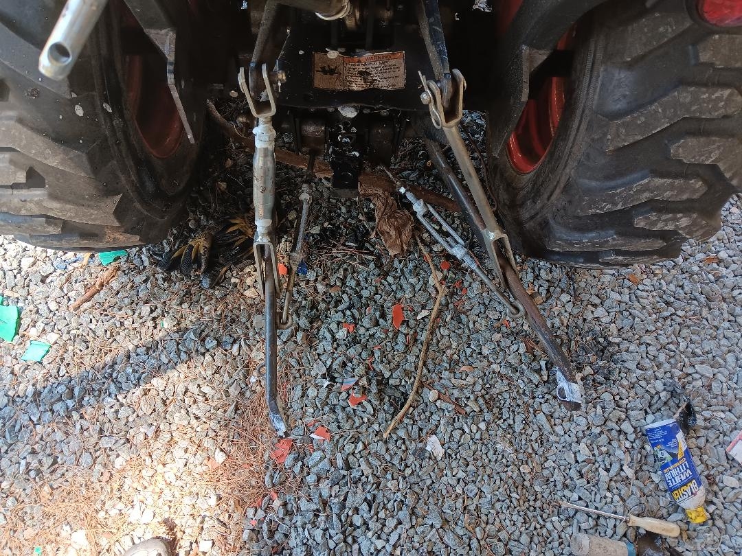

2 things, is this fluid ok for this unit? I use it in Kubota G1800.
Also I think the 3 point arms are backwards.

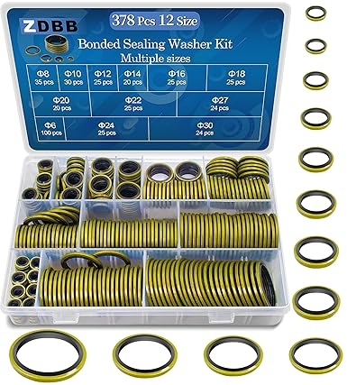

Just ordered bonded dowty washers to fix leaky 3rd function valve.

Yes your arms are backwards - switch left and right lower arms. Also I finally bought a set of pin style connecting links for the lower arms - holds them out for attaching 3PT implements then you can adjust in once mounted - shoulda done that years ago.

I got my o-ring washers in, no more leaks and now have a few in the kit for future.
Turned 3 point around as well.
Seen a full set of Kubota's for $250 on MP but I need a box blade next.
/ Branson 2400H #7
No - its $40 for the set - cheap and they work well.

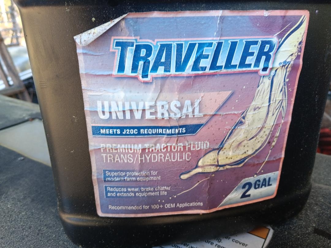

I can't check the TSC AW46 oil specs because it won't let me access the TSC website but seeing the AW46, tells me it might be just hydraulic oil.
You want universal tractor transmission oil, also called UTTO, since your tractor has wet brakes. This oil has the necessary additives for wet clutches and wet brakes, which straight hydraulic oil has not.
The operators manual calls for the Texaco TDH oil which is a tractor transmission oil.

These are the specs posted for the Universal TSC Fluid - not the ISO 46 Hyd Fluid,
Traveller 5 gal. Premium Tractor Trans/Hydraulic Fluid is designed with modern farm equipment in mind. It employs a common sump to lubricate hydrostatic transmissions, differentials, wet brakes, hydraulics and final drives gears, and it can be used with a variety of off highway machinery, industrial tractors, final drives and more. Thanks to this hydraulic fluid's universal compatibility, taking care of your brakes and gears is simple. Meets J20C standards.
Premium hydraulic fluid helps reduce wear and brake chatter and helps extend equipment life
Formulated to provide superior protection for modern farm equipment
Special multigrade (SAE 10W-30) fluid blended with the highest quality lubricating oils and the most technologically advanced additive system
Employs a common sump to lubricate hydrostatic transmissions, differentials, wet brakes, hydraulics and final drives gears
Designed for low temperature pumpability, excellent thermal stability and gear protection
Temperature rating: -44 to 439 degrees F
Universal hydraulic fluid recommended for 100+ OEM applications (see label for complete list)
Meets J20C requirements
Includes 5 gal. bucket of tractor hydraulic fluid

Yes, just done at 350 but I have to repair an o ring and may lose lots of fluid.
The o ring is on dipstick mount, 2 o rings.
Sorry didn't make myself clear, Manual says TDH 1893 but I read that that AW 46 or Mobile 424 replaces it.
I'm using JC20 to top off which I use on my small Kubota.
Bottom line is which hydro fluid is best for Branson 2400H? Thx
