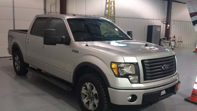

As you all know I'm partial to Ford's and here is why. I have had them all including 4 GM's, 1 Nissan, 1 Toyota, 1 Dodge, 1 BMW, 1 Lexus, and we'll over 15 Ford's now. My average trade in is 5 years old and 120,000 miles.

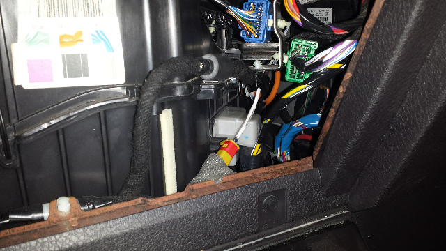

Yesterday I was coming home from work and the blower motor on my 2012 F150 Ecoboost would not work. It has 56,000 miles. I got home and did some research on the net and found out 99.9% of the time it's the control module. I checked the relay and fuse and both were fine.
After calling 3 dealers I found one in stock. All the other dealers could have it by noon the next day. I stopped on my way to work at a dealer about 5 miles out of my way and picked it up, cost $82.
It took all of 5 minutes to replace. Open the glove box, drop the door by pressing two tabs, and there it is. 2 8 mm screws held it in and a wiring harness. The old one was black pictured on the hood and the new one is white pictured inside the dash.
So yes, Ford's do break! But consider this. Since 1997 I have owned a 1997 F150, a 1999 F150, a 1999 F350, a 2001 F150, a 2003 Mercury Mountaineer, a 2004 F250, a 2005 Mercury Milan, a 2006 F350 (still have with 128,000 miles) a 2007 F150, this 2012 F150 (with 56,000 miles) , and a 2013 Edge (with 63,000 miles) and this is only the SECOND unscheduled repair made. The other being my 2006 F350 needing a dash cluster due to a faulty fuel gauge.

Nice looking truck. Freshly washed for the pics!
MoKelly
All my vehicles get washed weekly as a minimum. That one got washed Saturday.

Chris,
Would that control module going be the cause of a fan only working on high? On the way out? A friend has a 2010 F150, fan only works on high.

Chris,
Nearly always when a blower only has high speed, it's the voltage regulator. Our module as ford is calling it. It gives resisted, lower voltages to the motor for lower speeds, and is "direct drive" for high speed. Meaning no resistance needed, it's pushing full 12 volts to the blower.
I've always called it the "blower motor resistor" they are usually around $20 at the parts store and are sometimes in an inconvenient spot. The blower motor in my 04 F150 started making odd noises at around 30K miles and at that time Ford wanted $150 for the motor. A friend had to have the blower motor changed in his Toyota FJ Cruiser and was told the job would have cost $3K if it had not been under warranty due to the sheer amount of interior disassembly required.
