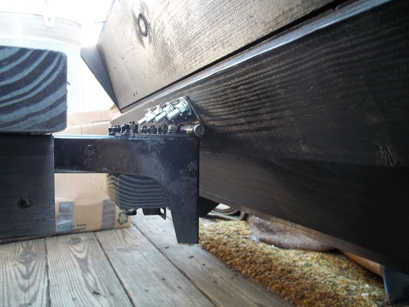

It is visually impressive, you do nice finish work. My concern is what is to keep the bottom of the plow from being pulled under the mount where the hinges pivot?
Hey Mike, Thank you for the compliment ;)
I took 2 pix closed up so you can see. I'm thinking putting another 2"x4"x24" so it can hit the Bracket when it hit snow. Right now it's only like 1" hitting the Bracket. I tried it by pushing in Front of the Plow and the Tractor moved, it didn't go under at all, but yah, anything can happen right?
One of the Pix is lifted a bit so you can see the different. Maybe you got other Ideas??? I'm all ears...:D:thumbsup:

On the attached picture I added a red section. I would put a piece of wood there attached to the metal bracket so the plow rests against it when down. Shape it so it matches the angle. The bottom part of the plow will get loaded up, without something for the pressure to be dispersed to I think your wood will fail at the bottom.

Hi Mike,
Yes, that is the Location where I was going to put the 2x4x24. You read my mind, thank you!

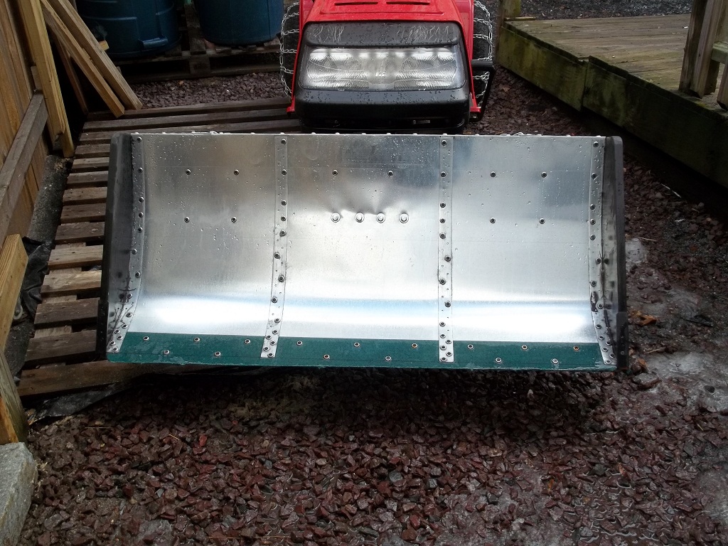

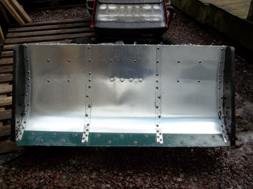

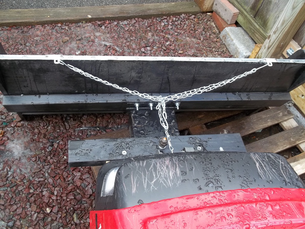

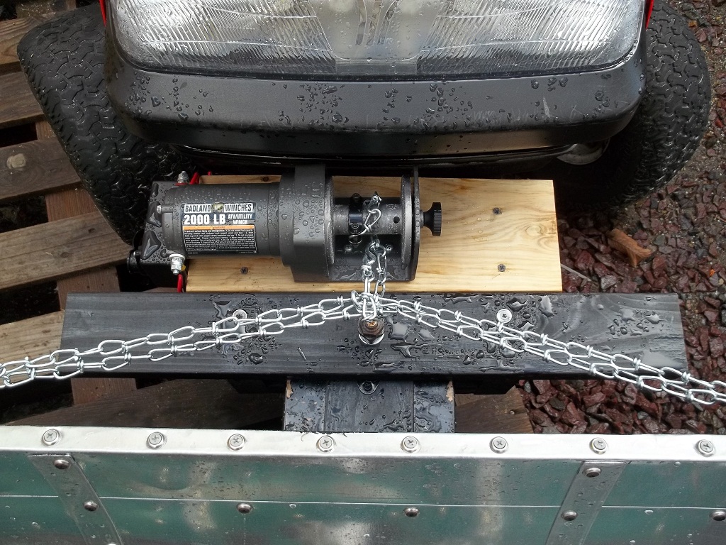

Anyway, here is an update Photos for the Plow after 1 usage!
I def needed a Metal Blade and Snow Shoes, which I never got a chance to do it. Although the Garden Fiber Divider / Garden Edge thingy can't really hold up that good, LOL. Well it's FREE after all so I can't really complain and I have 4 more of those so I'm gofnna use them until they are gone then go buy a peice of Metal for the Blade. The Winch was helpful because lifting was easy and a snap.
Everything else was AOK with about 45 Mins. of usage. Things holding up pretty good, especially I had to Plow the side walk it's like 1 Path of about 48" X 200' long.
