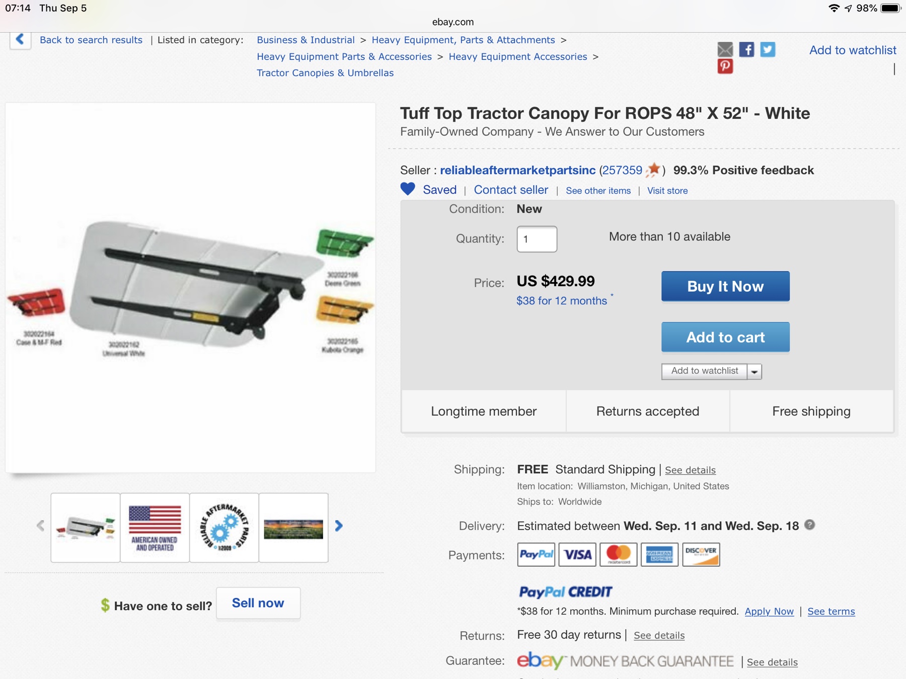

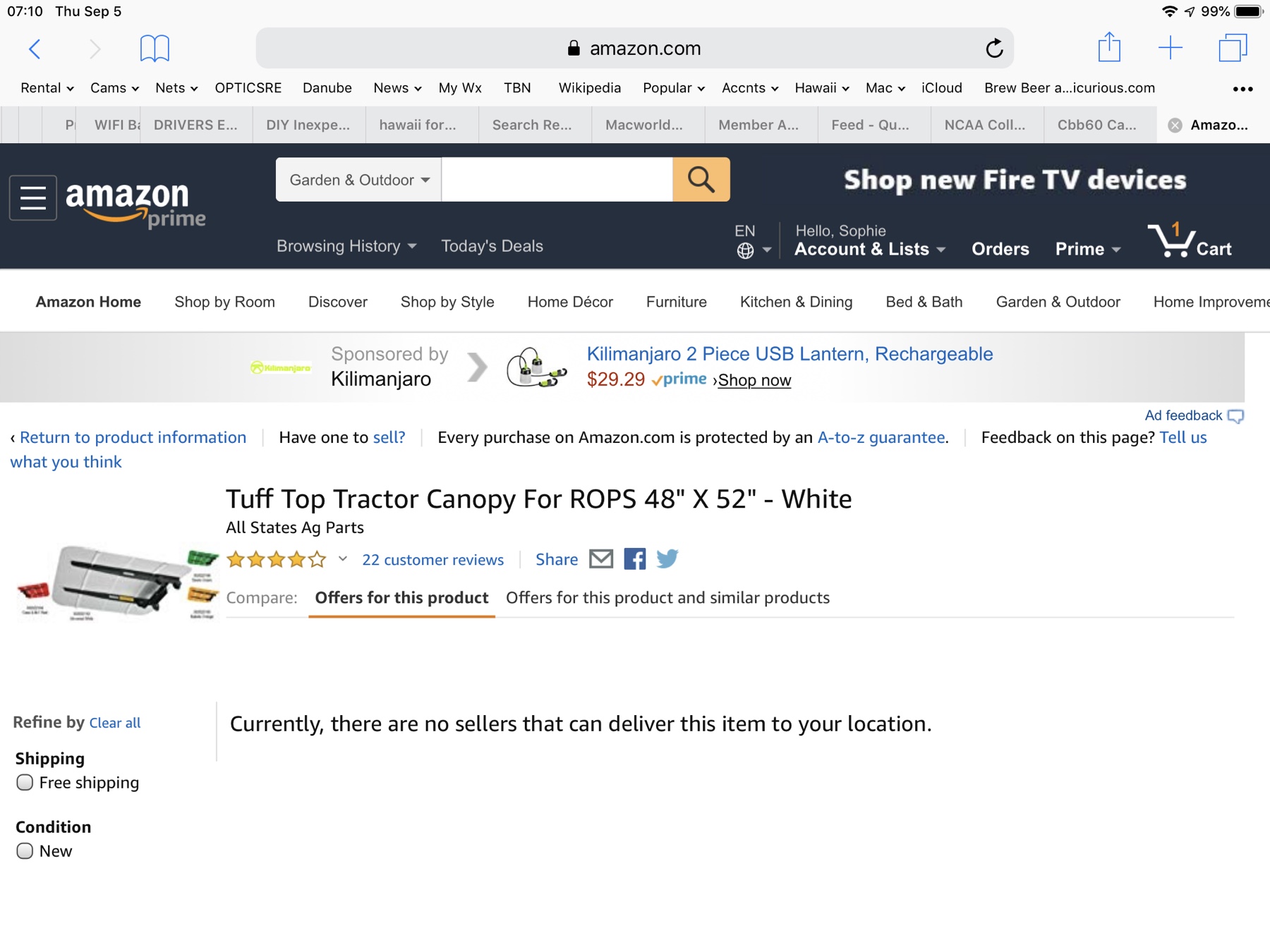

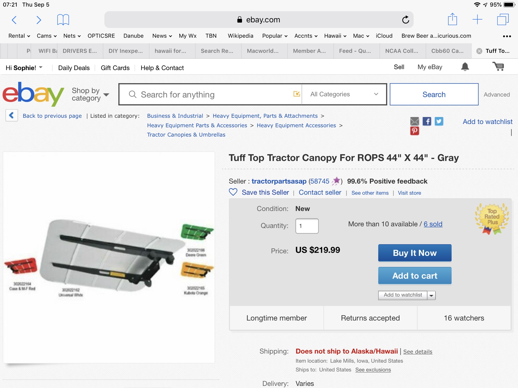

Would be easy to have cab envy, but I don’t have to move snow and most of my tractor time the temps are in 70’s, rarely hitting 81°F. If I had a cab, that might mean I’d have to mow in the rain, but the fields are to slippery when wet. That said, a bit of shade would be nice. Had a Tuff Top on my Kioti and it was great, thought I might go that way. Nope, either companies don’t ship to Hawaii or the shipping cost is prohibitively expensive. Guess I was fortunate years ago to get the TuffTop.

Considering the cost of a commercial one, it seems like you have too much idle time on your hands. Personally I like the ROPS mounted shades with nothing in my sight line. Very happy with the 'Tuff Top' and not that expensive at under 300 bucks.

Well Daryl, wish that were true, but have a whole list of projects I’m behind.
As I said, another Tuff Top was my 1st choice. but just a quick relook:
As for $, less than $200 at this point and likely less than and $50 to go, not counting the goodies I’m considering.

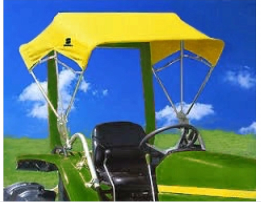

Back in the early 1960’s we had two Ford 3000s equipped with umbrella buggy tops similar to this.
We feature tractor the best tractor canopy tops, tractor umbrellas and tractor sunshades by Femco. We have many colors. And our tractor canopies, tractor umbrellas and tractor sunshades are proudly made in the USA!
They were later upgraded to Ford 4600s with cabs and AC but it made 12 hour days quite enjoyable cultivating 1/2 mile long rows especially on one farm that was oceanfront.
Great memories!

BTW, I had seen this site, another no ship to Hawaii ☹️

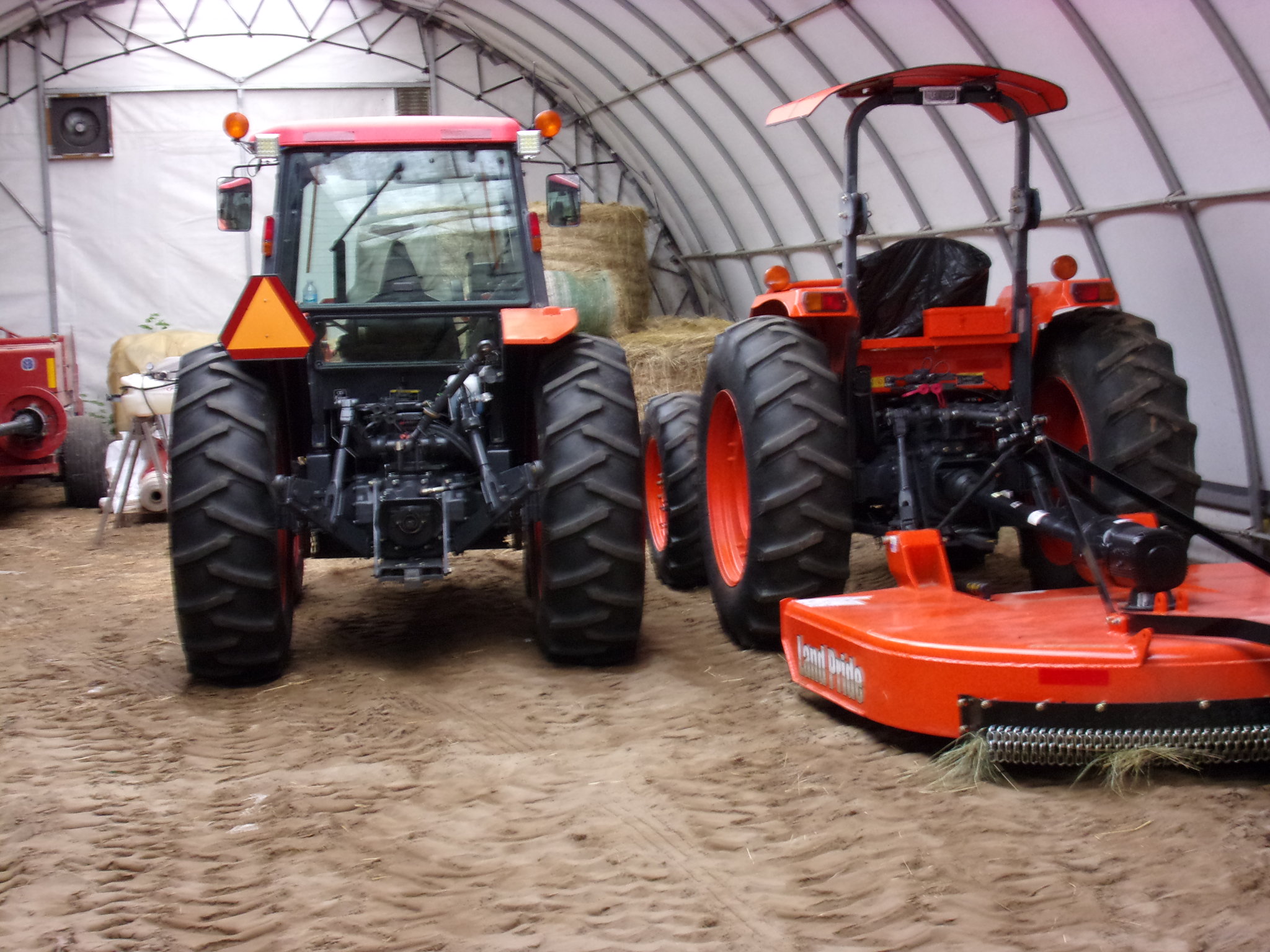

I have those lists as well, why I bought the manufactured top in the first place. I own a fab shop so building one from scratch wasn't the issue, time was.
On my open station, I went with mirrors mounted to the loader uprights, 2 mirrors from All States ag and some flat stock and I was in business.

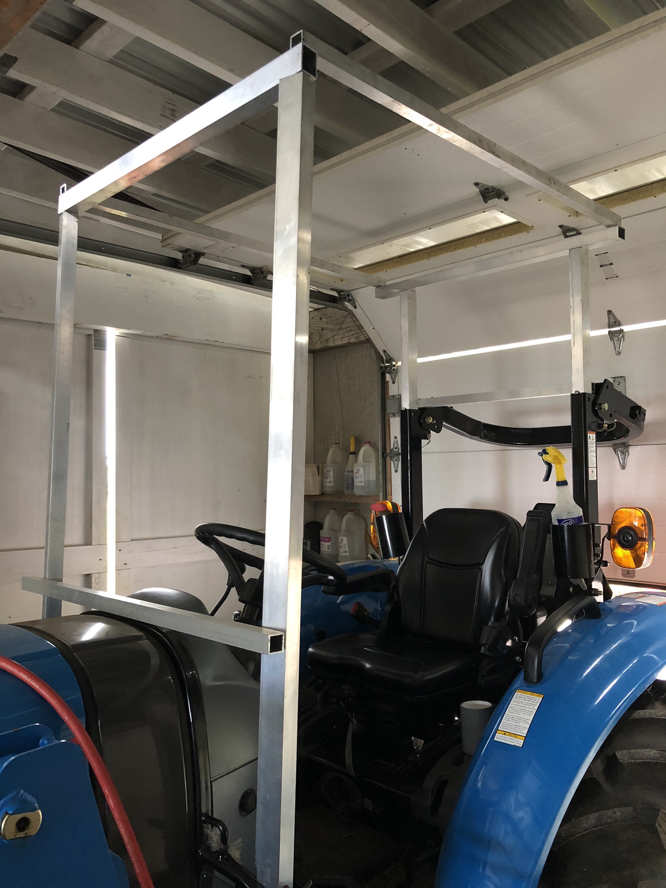

A bit of progress, the 4 vertical legs, the 2 cross tractor top supports and the brace over the dash. Just temporarily held in place with screws for now as I’m expecting to disassemble then final reassembly. Still need the 2 top brackets that go lengthwise and possibly a cross brace at the ROPS.
I actually left it on today and brushhogged about 4 hours. Was pleased with the sturdiness, especially knowing it will get even better. The rubber tape mitigated any metallic noise.

Thought I had a pic. Will post one tomorrow.

Pic from yesterday
