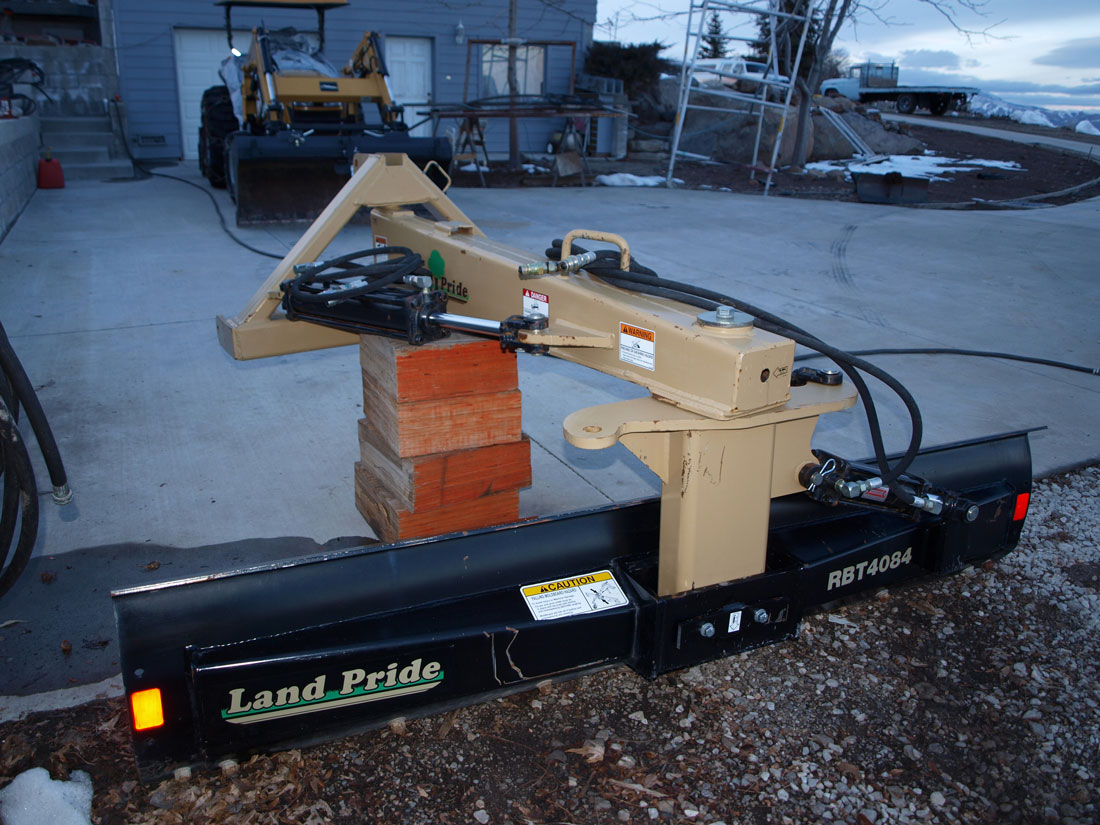

You never know when a real deal comes along. Patience is a virtue. I was lucky and found this blade for a grand with a cord of wood to go with it. These Land Prides are built. I have a box blade that came with my tractor, but it is not built like this Land Pride blade. I will be putting this blade to work and will post some pic's.

Ken, if you decide that you need to sell that blade, I will be happy to purchase it from you, even pay a little more so that you can make a buck or two. ;) I'm looking for an RBT3584, but that 40 would work juuuust fine.

What a deal! I would love to have found that.
