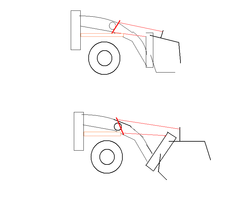

It was pretty miserable out last night to try to take a picture of the plow. But the idea of a jig to hold up the center cylinder sounds like it would work.
Any ideas on how to get away with out needing a deadblow hammer and a driver to get the pins started? I am just thinking that for me the tools are in the basement workshop and the tractor and attachements are out in the carport thats a decent walk away.

Matt, in the short term I think you would be stuck with a mallet and dowel or piece of PVC pipe to drive out the pin. Perhaps they will lossen a bit and become more free with use and some polishing.
Red Dirt, the next thing will be to be able to produce the same geometry on the home built attachment. Shouldn't be too difficult, but, some attention to those measurements will be in order.
I won't trying to remove my lower pins in the next few days, so whoever does so, just post your findings.
