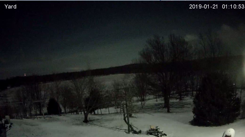

A little snow, a full moon, a low light camera and .... presto ... near daylight at 1AM:

I didn't know you had trees where you live?
Where is that anyway?
