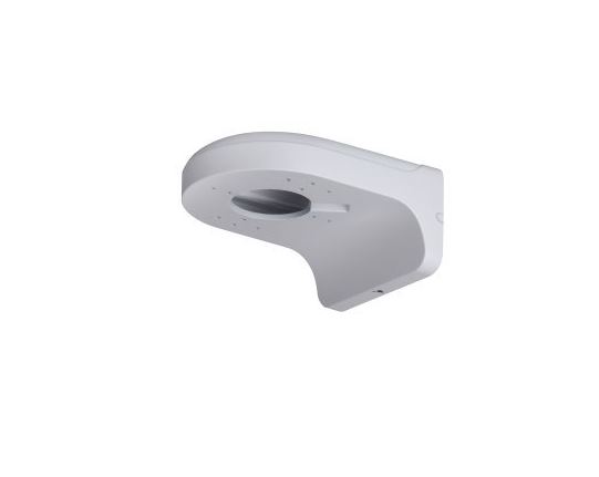

Dahua is pretty much all I use, I installed about 20 systems last year, FYI The bullets cams will be spider magnets and you will be brooming them off every week in the warm weather. The Dome cams are OK but they have issues with night time IR reflection. I have been using the turrents for outside work when possible like this. Dahua IPC-HDW5231R-Z . The starlight technology is hands down the best nighttime low light cam on the market right now for its price point. Ask your installer if they have anything like this.
I understand the bullets are spider magnets. I did just order a Dahua Starlight to compare with my Reolink. They are double the price though. Also am considering the very same 5231 that you suggest but I do like the ease of mounting the bullets on vertical surfaces which is pretty much everywhere on my house. Otherwise I am going to have to fab up some brackets and I will have wire exposed.

Dahua, amcrest has a nice wall bracket for their dome cams.
Dahua Does make a mounting bracket for them and also a waterproof junction box.
