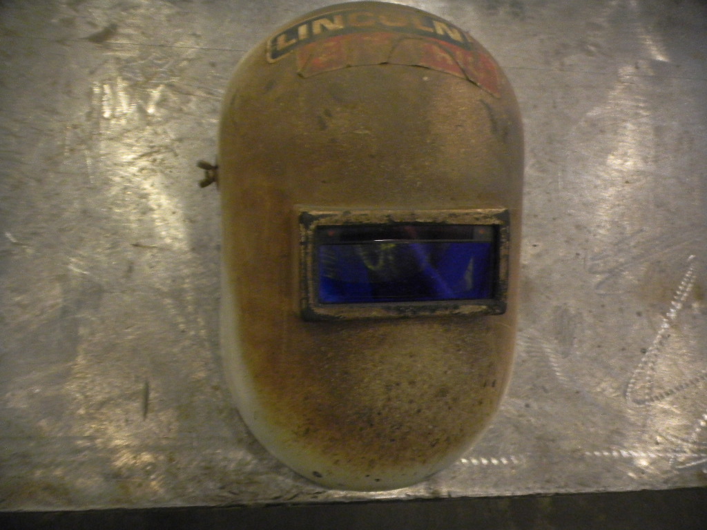

Being a hobbyist, I imagine Shield Arc is STILL on his first clear lens....
Terry
I gotta learn to keep my face out of the smoke! :laughing:
