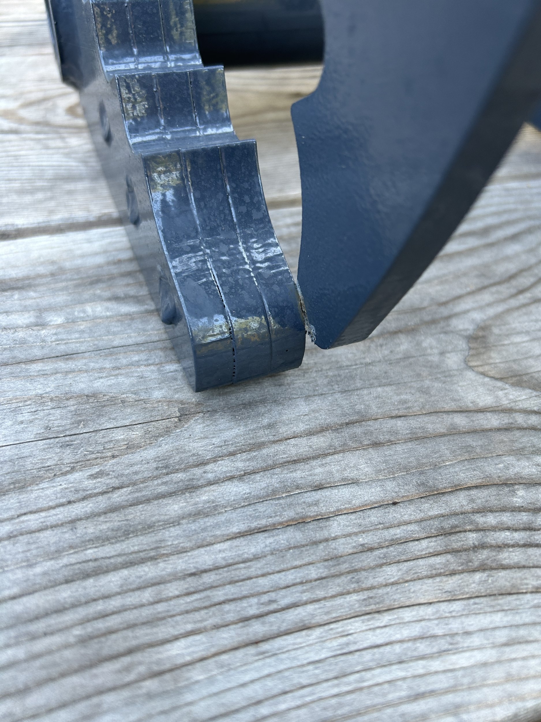

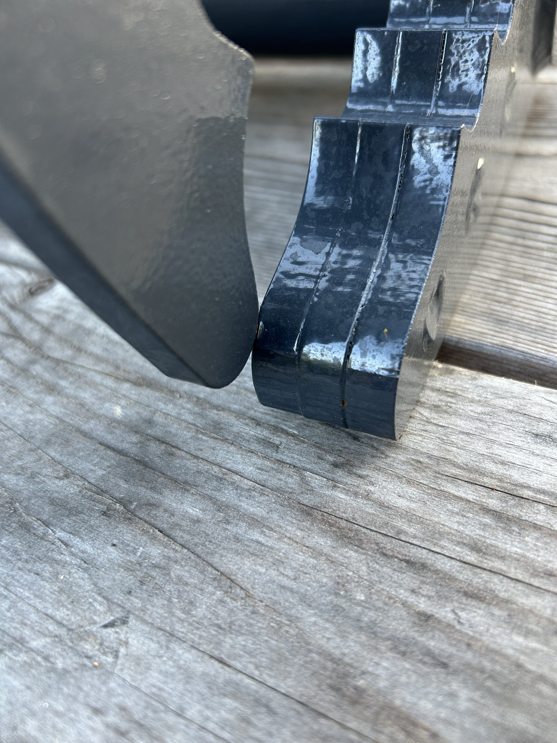

Below you can see just the tiniest bit of interference on the two outer teeth. If the cylinders do in fact have enough travel to close the jaw even further this wouldn’t take five minutes to clearance with a side grinder. I’ll report on the outcome when the tractors is back in my possession.

I just noticed something. If you go back to the very first post in this thread and look at the first two pictures that show a grapple sitting on the showroom floor you can see that in fact the jaw is closed further. I’m guessing mine is going to need some touch up on the tips of the teeth.
