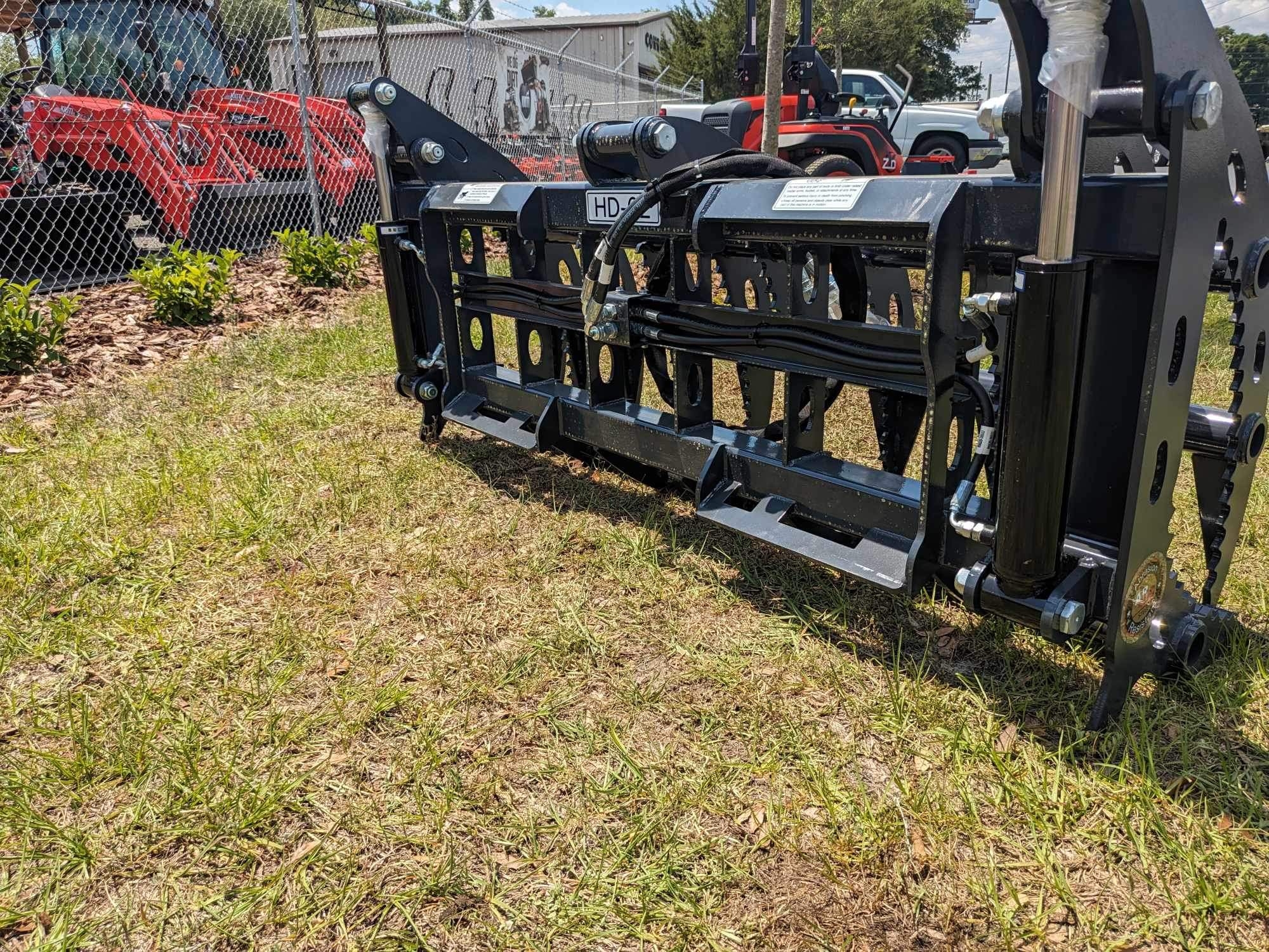

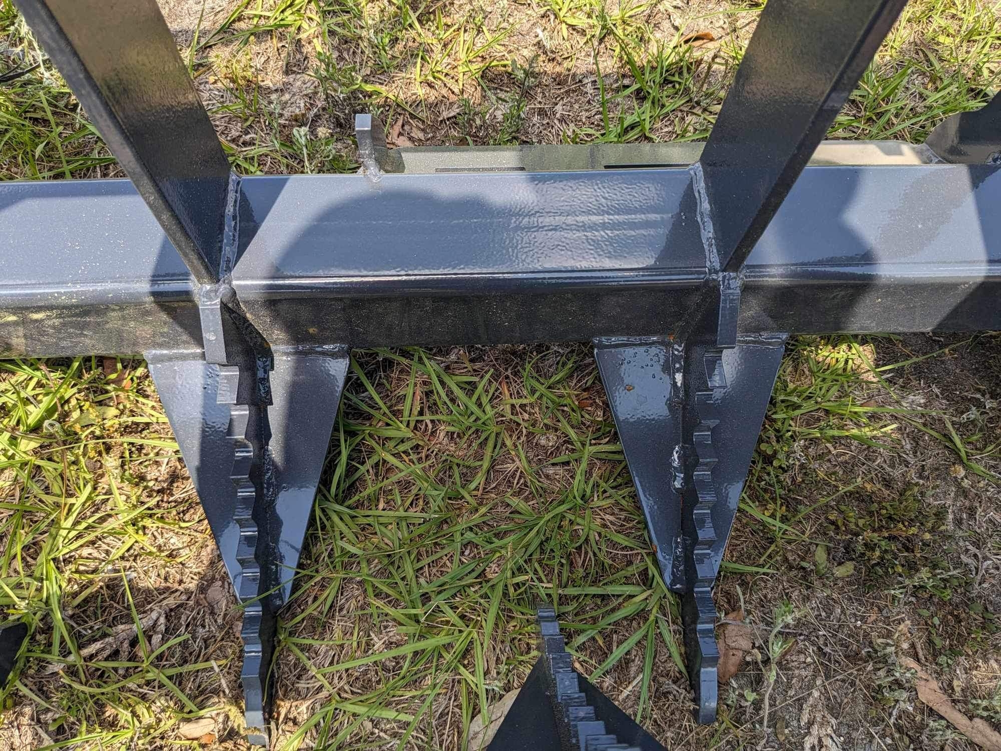

While browsing grapples for my Yanmar YT235C I ran across an ad from a fairly large tractor dealer that's not far from me. After looking more closely at the pictures I liked what I saw so I started asking questions. He claims that they are made by Carolina Implement (not to be confused with Carolina Attachments). He stated that they are a 2-3 year old company and only sell through dealers so there is no website to look at. The look similar to a Wicked grapple to my eyes.
62" Heavy Duty 486 lbs
62" Standard Duty 440 lbs
Has anyone ever heard of Carolina Implements? Do you see anything in the photos that jumps out at you as a weakness? The overall design looks pretty stout to me.

Yes - it DOES look stout. I like the middle arm and the hydraulic cylinders are plenty big enough. I think you found a winner.

AND that is a very respectable price. New company - it's not cheap to advertise on the internet.
/ Carolina Implement Grapple? #6
Make sure it has grease fittings on the ends of the cylinders and pivot points
I have it in my notes to check for grease points. I can see Zirk fittings on the upper cylinder connection points but I can’t see any others. A closer inspection will be required.
/ Carolina Implement Grapple? #8
That looks quite rugged; stout was mentioned prior, I think that's a good assessment from afar.

I'm not a fan of using threaded bolts as bearing pins for the lid. What other shortcuts did they take? Mild steel tube for the chassis?
Good eye. That kind of observation is the type of input I was looking for. I wonder how hard it would be to source the correctly sized pins to replace the bolts?

Those bolts are a little different, the ends are dimpled. Without looking closer, they could be pivot pins.
That grapple sure looks like this one
Looks heavy duty enough for what your tractor can put behind it. Does it really matter who built it, for repairs it’s mostly generic parts and weld and paint if needed. 2k (or better), price is pretty good for todays market.
If really concerned, maybe local dealer would give manufacturer (maybe importer) phone #?

Good find. It appears to be identical right down to the stickers. I wonder if these are just being imported and sold under multiple brand names?
As you stated, anything can be fixed with a welder as long as the steel is decent quality.

In the link I added, the 3rd picture shows a Carolina and HD-(?) sticker. Again, maker or importer to me, wouldn’t be that important. If I was buying a bucket for a 100hp+, I’d want to try before I buy. Without doing something dumb, this grapple looks well put together and is a pretty good deal. Would I back drag using the upper teeth, no. Would I wrap a chain around the upper and pull, no. Would I push /pull a tree using the upper, no. Picking up trees / brush, junk, old fence posts, yes.

My first grapple was a single lid unit I bought online. Used bolts for pins and the holes for the pins were cut using a flame torch. POS. Re-welding broken buttered welds covered with globs of high hide black paint is good fun.
I'd recommend checking it out in person before dropping cash.
