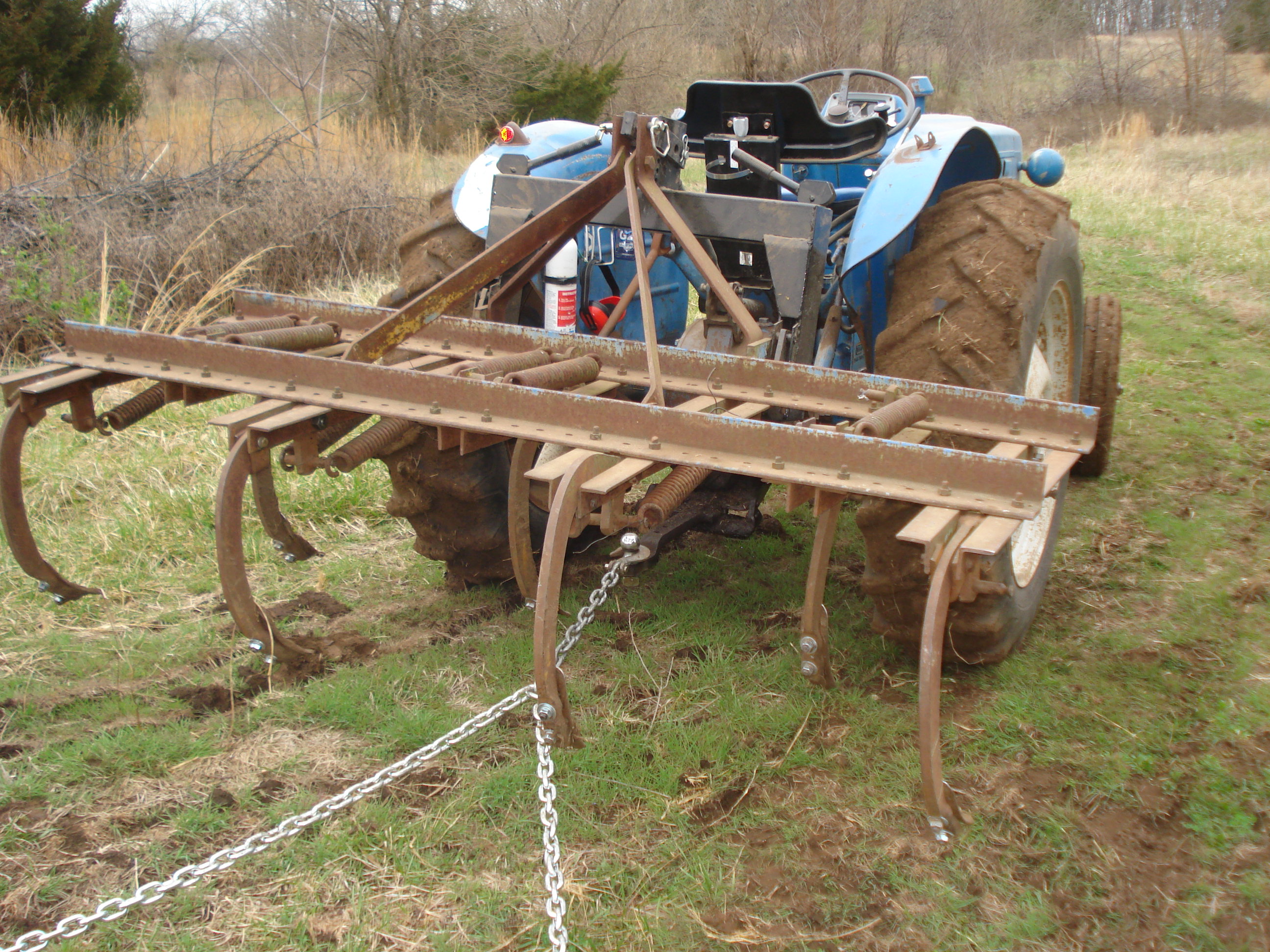

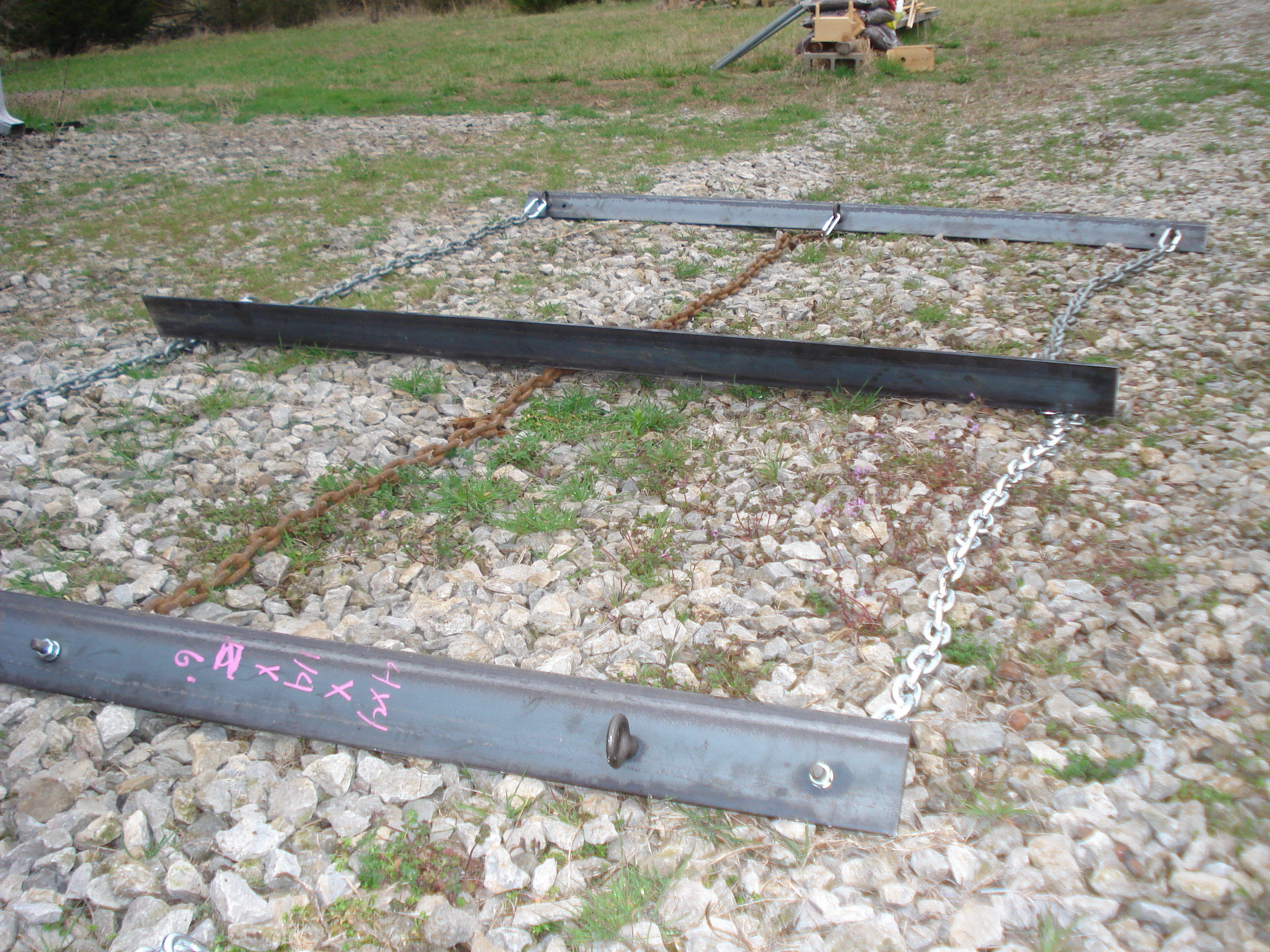

I made this the other day, copying another's idea, and it worked pretty well smoothing out soil that had been run over with a field cultivator. Cost about $150 to build buying everything at retail. Less Surface Trash.jpgSet up.jpgConnection.jpg

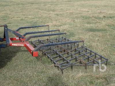

Picture of harrows on three point made by Farm King.
