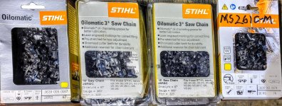

I happened to take a pic of some of my spare chains,,
The three on the left are for my 029Super,, the one on the right is for my Stihl 261C-M
OHHHHHHHHHHHHHHHHHHHhhhhhhhhhhhh,,,,,
two of those chains are the dreaded "yellow link" HIGH kickback chain,, (I guess)
The yellow is the only chain the Stihl place that I shop at carries,,
I bought these chains over the years for the 029Super as spares, and have not used them ,, yet.
If anyone can "decipher" what the chains are, I would appreciate it,,
I can not figure out a couple of them from the Stihl info,,, o_O
