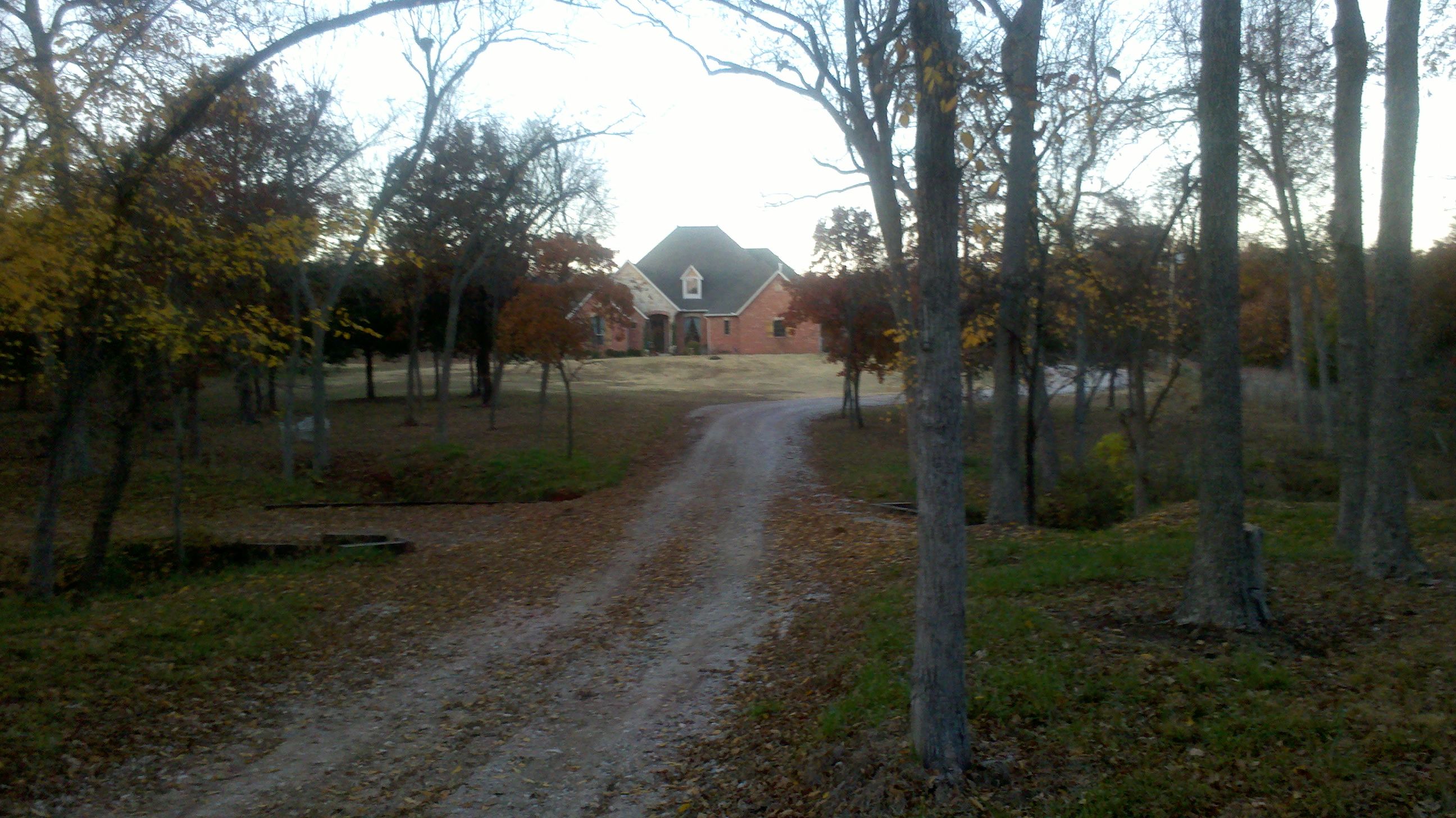

We have a long (1100') gravel driveway put in when we built our house in 2008. It has a 6-8 inch deep base of 3-4" crusher run. Then was top-dressed with 3-4 inches of 1.5" crusher run. About 5-600' is on a good downhill slope and it drains from east to west naturally. With a good rain i have to redress it with my boxblade and drag the sediments back to the top.
My wife and i always said that when we hit the lottery, the first project would be paving the driveway. Since we dont buy lottery tickets, thats not likely to happen. However, my neighbor just built a 4000 sqft concrete house and he has offered to me use his metal driveway forms. Is a project this size do-able in 10 yard increments? We were thinking about 1-2 trucks or sections per year. I was thinking to start in the middle, that way the areas by our garage pad and street approach would look nice. Hopefully we could get our mistakes out of the way early.

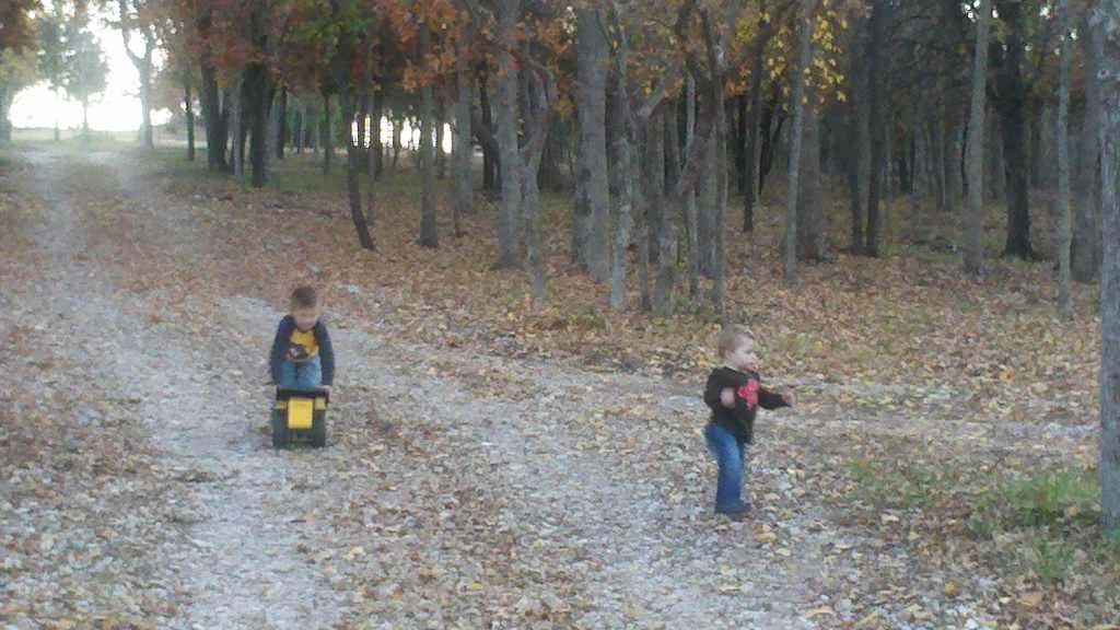

Here are a few pics to help with the "visual" members. I always appreciate pics when people upload them too! Pic1 is looking uphill towards our gate and Pic2 looks downhill towards the creek then up to the house.

Nice setting you have there. There is no doubt, gravel drives are a lifetime project, but I actually prefer their more rustic/rural/natural look over concrete. But, it's not my driveway, so...
I would begin at the garage. You will have less tracked in grit, and by the looks of it, you will be needing a place for a basketball hoop and someplace smooth for toys with wheels :)
Have you experimented with water bars to keep the water from eroding the gravel? It doesn't look like you would need very many.

Thanks again for the kind words. We have worked hard to get it to the point we are at. We first thought that gravel wouldn't be bad but as our kids get older, they can't enjoy the luxury of having a big area to play on. I know I'm fussing about petty issues in the grand scheme of things. However, I would like a big area for them to learn to ride their bikes on and other activities.
Its funny that you mention water bars. I actually found a post about them on TBN and have installed 2 of them. One is about 50' into the long straight-run on the hill and the other is about 350' further downhill. They are reclaimed cedar boards and constructed out of 1 2x6 laid flat and then 2 2x4s spaced apart standing on their spine to make a trough. I cut spacers out of conduit and place that in between them. They are about 4 inches deep and work to kick the water off into the trees at strategic locations. They are dug into the driveway so they lie flat and you dont notice them when you drive over them. They work adequately in slow, steady rain that produces a small downhill stream. However, we got 4 inches this past Saturday night and it overwhelmed them and they filled with gravel and sediment and then they are useless until cleaned out.They also are a pain to work around when boxblading the gravel. You have to stop, scoop up any extra gravel, pour onto uphill side, then begin again to the next on.
