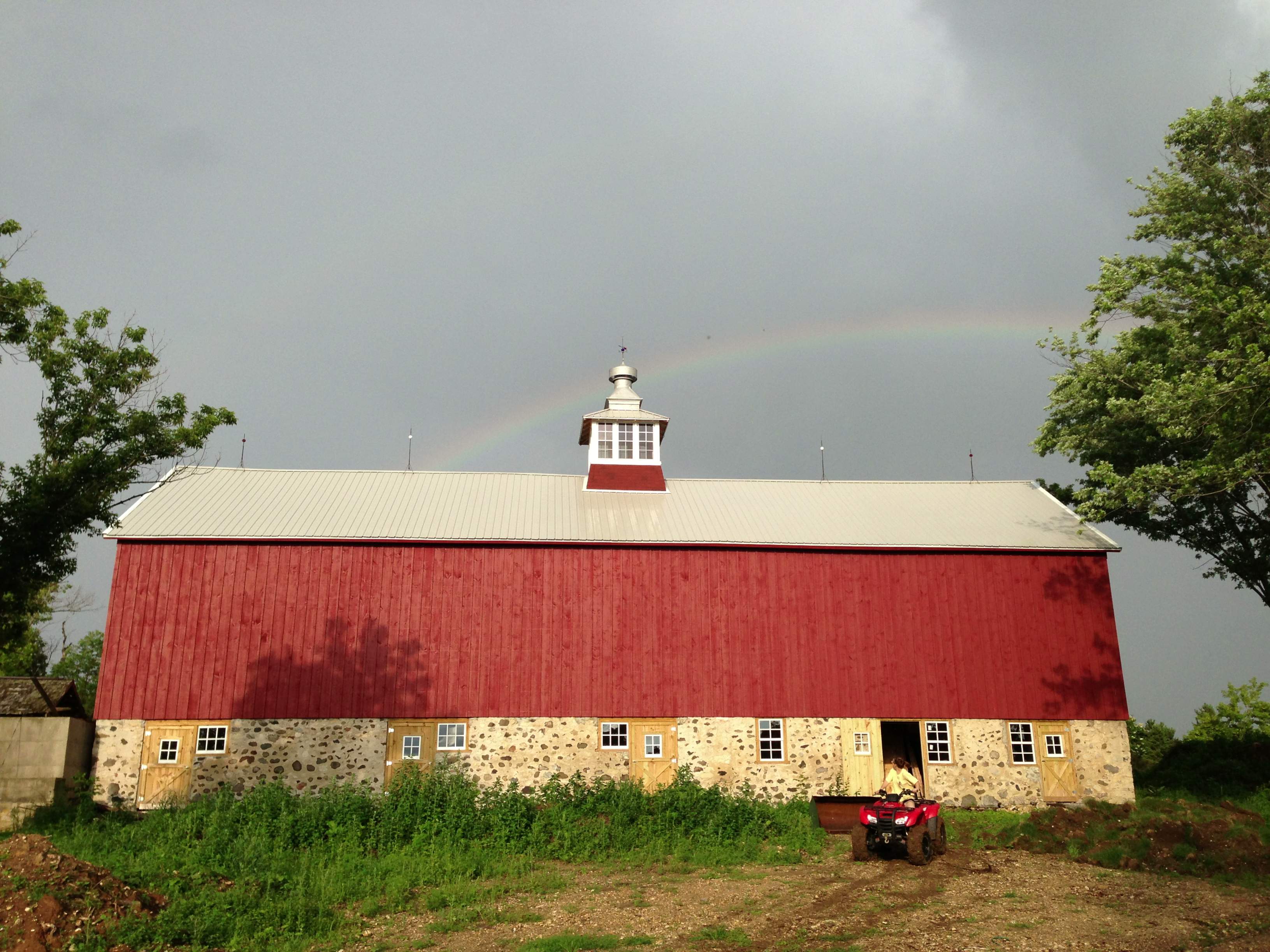

We used an Amish crew when we had ours rebuilt. Cost came in at less than half what the English quote was. I like steel roofs and wood siding. Shingles are just too much trouble. The Amish rented a all terrain forklift and manlift for the work. I can tell you that I can't find anybody to rent me a forklift, much less a crane. Insurance just won't allow it. When we moved our garage I ended up buying a old utility truck with a crane. Did the project and the sold the truck for a loss because the trunion seal had blown. Only lost a couple of grand on the deal which was worth it because we got our use out of the truck.
I've found some plans here: Free Framing and Utility Building Plans If you are in a snow region, please don't forget to figure on drift. I've seen too many building collapse for that reason. Also, never have an open sided building because the wind will get inside and rip the roof off.

Now Cord that is one nice barn :thumbsup:
