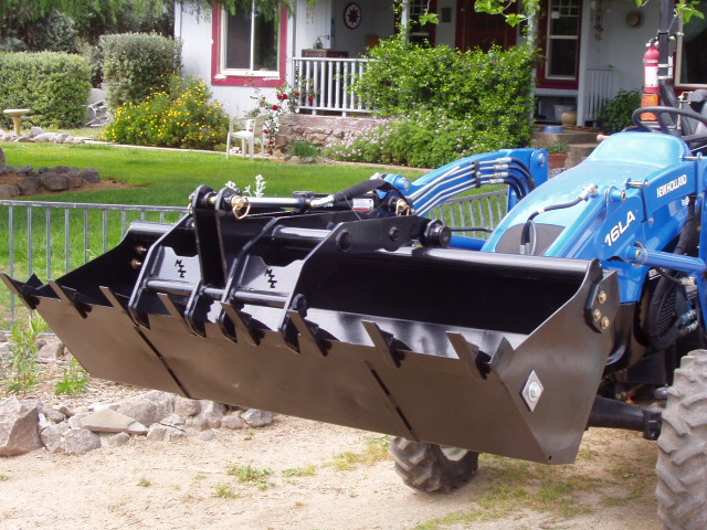

David,
I certainly realize that you are laying out some big money with an initial tractor purchase but when you do jump for a toothbar, welded or bolted, do some homework on a future bucket grapple of your choice mated up to your existing toothbar. Look closely at nybirdman's photo. You will see that his "Thumb" bucket grapple has an "overbite" between the teeth of the toothbar, a correct way to make the two work in harmony, good job nybirdman. The last thing you want to go wrong is a conflict/strike of mismatched spacing of the new grapple teeth and the existing toothbar teeth. I've loaded this photo of my M.I.E. bucket grapple before and some guys viewing this may nod off due to repetition but I feel it is important to you and others on the toothbar/grapple threshold to understand the necessary dynamics required between the toothbar and the grapple. Even if I decide to temporarily remove the toothbar, the standard bucket's cutting edge is still the grapple's stopping point.

David,
Nickel Plate,
Excellent point. The engineer in me saw that when looking a NY's "thumb".
In the end, I got a killer deal on a WR Long root grapple (very slightly used) and I dropped the BOG idea completely. The bucket is for bucket work, the grapple is for the rest.
Thanks,
David
