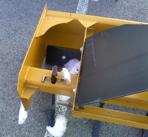

Picked up the LD today. It's exactly the same except it doesn't have the outside corners and the cross tube gusseted. The corner gussets could be easily added if necessary and the reason why the short gusset on the cross tube isn't there is because of the shorter box. It's like 1/2" from the fwd side of the box, so there's no room.
In playing with it this afternoon, I have 3 complaints, 2 of which are easily fixed and one that is just a cosmetic thing that doesn't really need fixing.
1. The square tube that accepts the retaining pin for the scarifiers was just chopped and welded on without cleaning up the cuts. There's some sharp metal on there that WILL lay me open eventually if not taken off.
2. Not much care was taken for alignment when that square tube was welded on. Two of the pins have to be driven out to remove the scarifier. I'll be cutting them off and cleaning them up before getting my buddy to weld them back on.
3. The paint job is horrible. Really really bad runs everywhere. Not an issue, but a 6 year old could have done better.
All in all, I'm happy with it. I think I will put the corner gussets in and paint it Kubota Orange to match the tractor. I also realized today that there is going to be a learning curve in using this thing, and that would have been rental time had I just chosen to rent one when needed.
