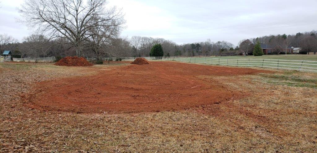

My tractor is working hard. I have moved about 75% of the dirt. I spend all day on the tractor yesterday. I used 6 gallon diesel fuel.
It is raining again today and tomorrow. I am still slowly getting it done. 440 cubic yards is a lot of dirt.

I have the trenches covered back up. I put the land planer to work.
I will get some top soil next if it dries out long enough to get it hulled in.
The two plies of red clay will be moved to the back of my property for a shooting range.
I will rent a dump trailer and use my tractor to load it and move it to the back of my property.

I had two piles of dirt that needed moved to my back pasture. I will be making a shooting range with this dirt.
I rented a dump trailer from Home Depot $115 for a day. I moved 23 loads or 69 cubic yards of dirt. I needed the whole 24 hours.
The dump trailer was pretty powerful it would dump with whatever I filled it up with.
I am now ready for my top soil hopefully I can get it this week.

Unless you had a compactor you'll probly want half of that dirt back to fix trench settling. Only needed to haul away the cubic yards of your piping.

I am bringing in top soil to get grass to growing.
For settling I will need to add top soil you really can’t grow grass in red clay.
We have had lots of rain and it has not settled at all yet but I am sure it will. I am not sure how long that will take.
   / DIY Digging trenches for Geothermal #112
Yeah, I understand the topsoil thing. Not sure what piping you laid. Just understand that displacement is all you needed to haul away.
Yep, it'll definitely settle. In your case it's pretty easy to know how much.

Not much space taken up by the pipe it is ¾ pipe it goes out to end of the trench then back two loops in each trench.
So very little space is used in each trench.
I only used my tractor to pack the trench and it is only weights 3K pounds.
1/2 the trench was filled with dirt then it rained and filled the whole trenches with water so this should help some with packing it.
   / DIY Digging trenches for Geothermal #114
So your piping space is very little. Actually insignificant. So you are going to need all of that dirt back. Then add topsoil.

we have had inches or rain scene I filled the trenches in. It has been over a month since they were filled back in.
The trenches all both a little higher that the ground right now. They would be a foot or more higher in I put that dirt back.
I just read on the Geo forum that it could take a couple years to settle back in. they suggest letting some dip for good as it catches rain and helps the Geo system perform better.

Yeah, sometimes it takes awhile.
There's no magic here. If the trench area was flat when you started, and you hauled away 69 yards of dirt, you will have to haul 69 yards back, plus however thick layer of topsoil you want.
