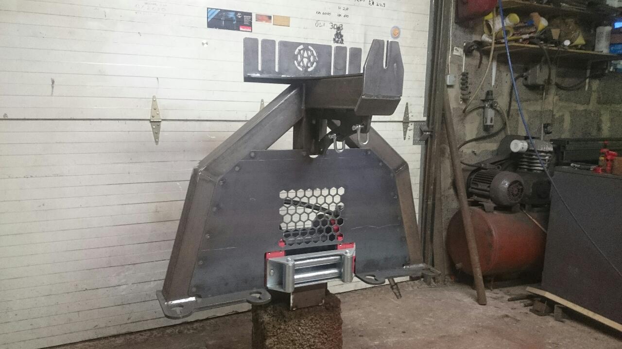

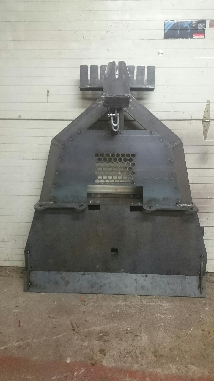

Hello

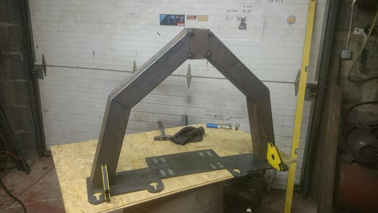

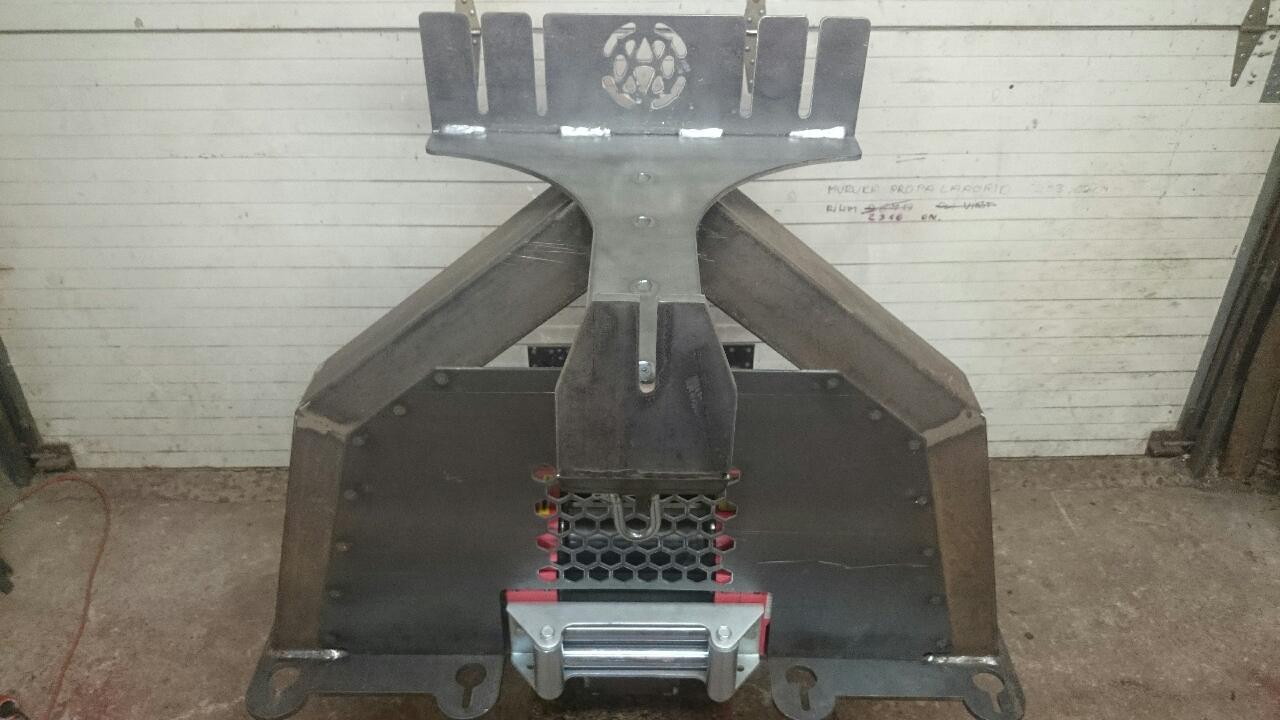

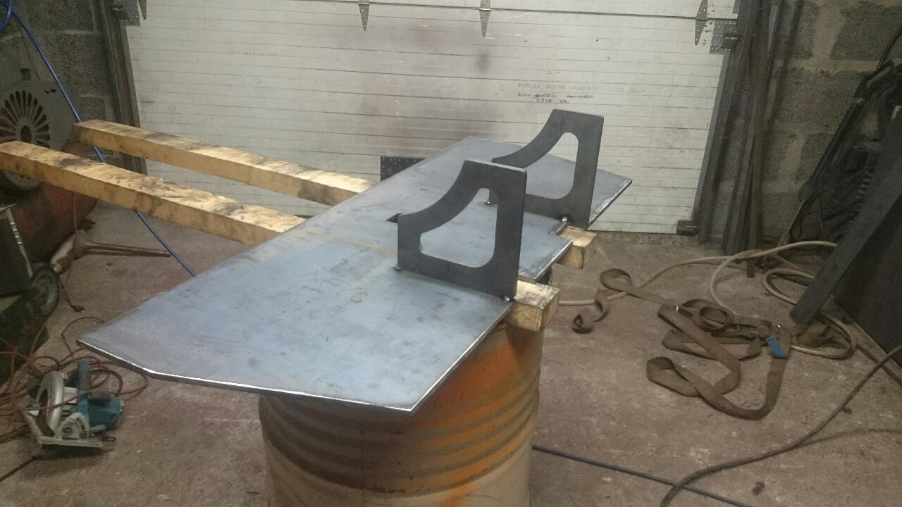

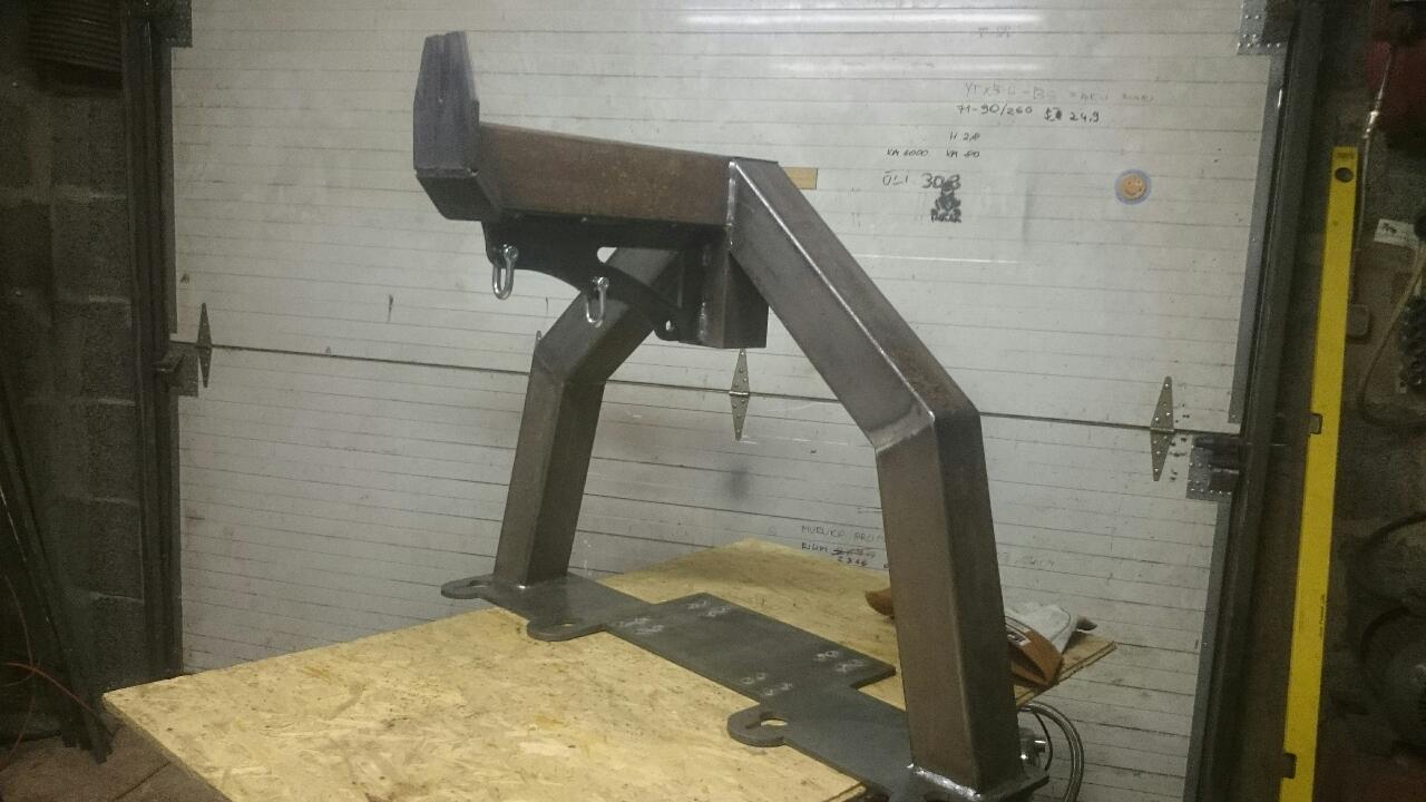

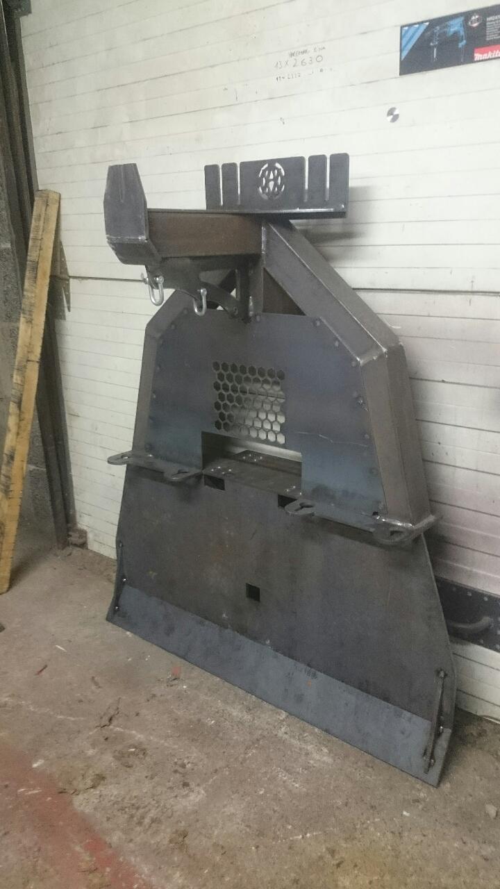

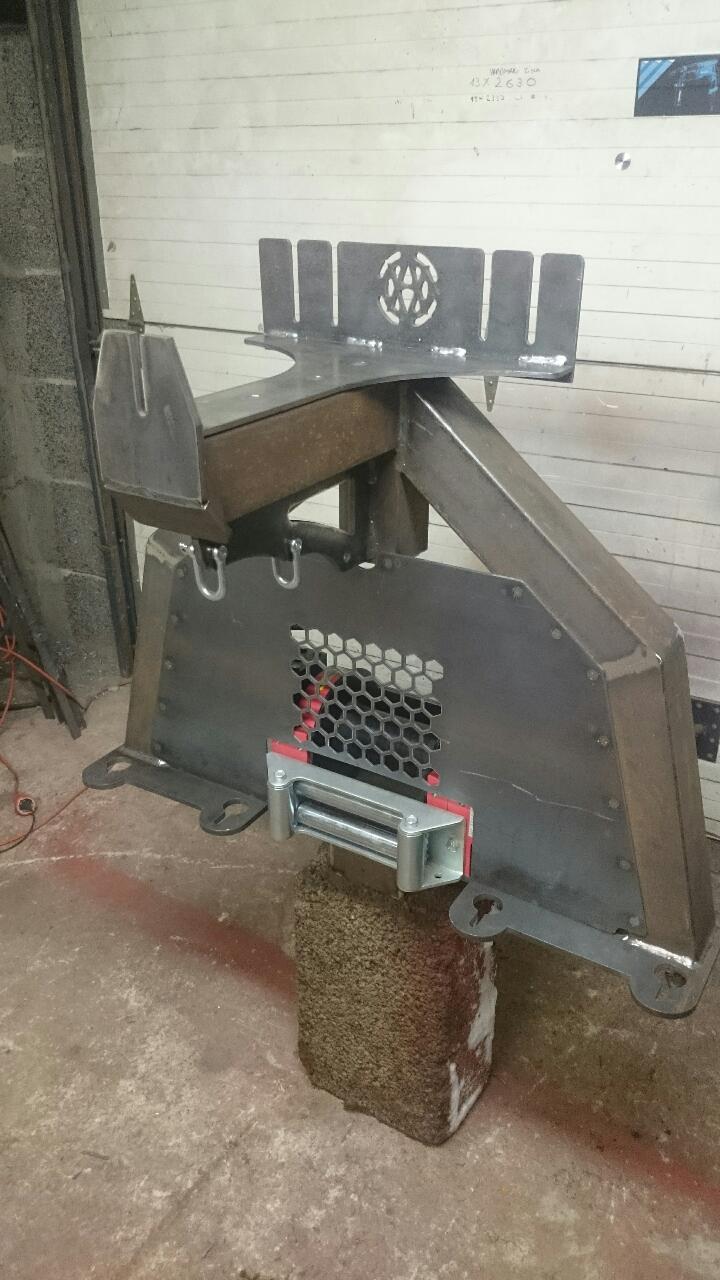

I also build a skidding winch.
Here are some pictures of my project.
DSC_0475.JPGDSC_0474.JPGDSC_0473.JPGDSC_0447.JPGDSC_0445.JPGDSC_0444.JPGDSC_0439.JPGDSC_0437.JPG
/ DIY logging winch build #127
Hello
Very nice finish on the metal work

/ DIY logging winch build #135
Very nice, what is on the business end? Looks to be set up for an electric winch? Is that cut on a water jet or cnc plasma table? I need to find either one locally ...lol
The winch is hydraulic and the control I want to do wireless. I used plasma cnc for cutting.
