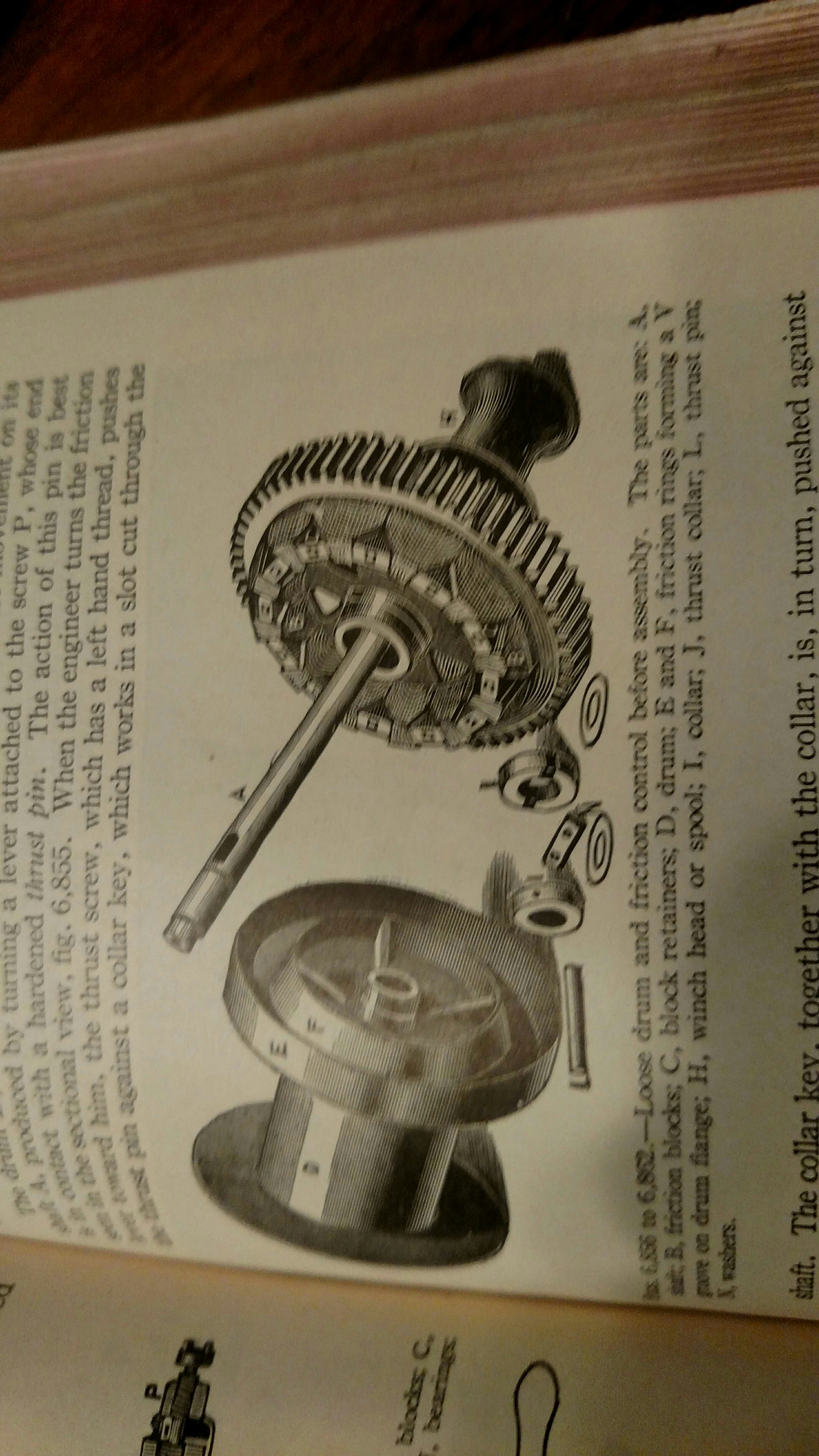

You may not need as much clutch as you think.
1509835937308.jpeg this is from Audels millwrights and mechanics guide (Gas and electric hoists section p499 from my unknown addition.)
You just need a large enough diameter for the friction to take place at.
For our friend looking to clean a pond.
Please look for a PDF copy of "Practical wire rope information and useful information on the drag line cableway excavator" by H.B. Saureman.
