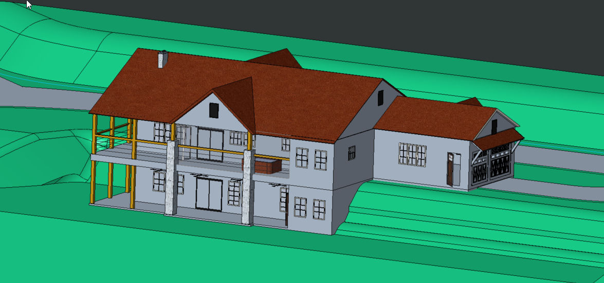

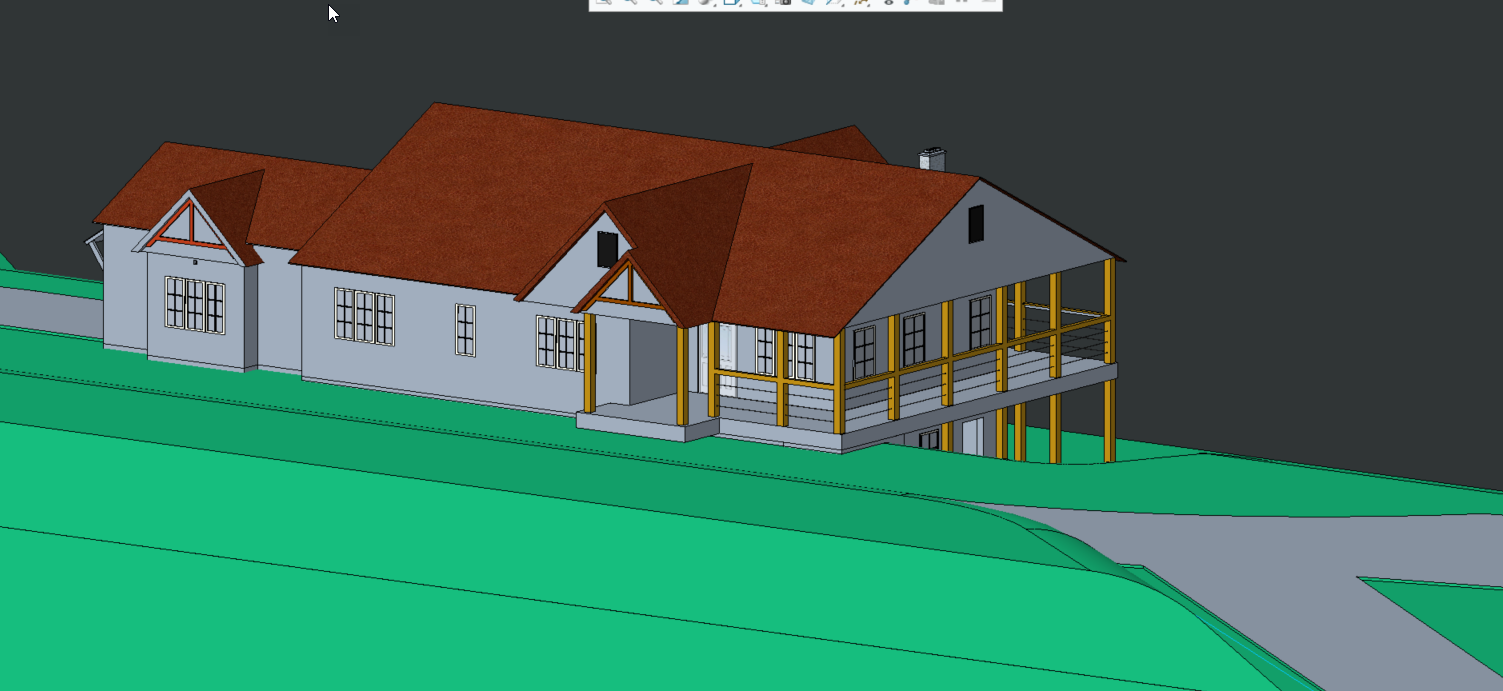

When I did my own plans for my workshop in 2011, I had my mentor architect still working with me. When it came to the house in 2014, he had retired and I was on my own. To make sure I did not run afoul of the local inspector, I went in to the building dept with my rough plans and got my inspector's boss to work with me on the structural span tables and other items that were crucial to the building and would be of particular note to the inspector.
I did this b/c my particular inspector (one of 3 or 4 for the area) was known to be a demanding jerk. I noticed on my first building that he really needed to be right - about something. I realized that if he wasn't allowed to be "right" about something, he would niggle until he was. So, on each stage after the second one (and when the point finally registered..) I made sure to leave one thing on each round a little sloppy. When he caught it, I thanked him for saving me. He was calmed and I was free to proceed.
When it came to the house, the structure was more complex and the systems were more intricate. I knew if I didn't get a hedge against his need to be right, it would be a nightmare. So, by having his boss guide me in all the critical structure elements, and in the process, overlook all the drawings, I could refer to that review process to defect any excess niggling. In fact, when his boss realized what my game was, he made a point to bring the inspector in for two of our sessions and make sure he knew I was not trying to be a "cowboy."
It worked in more than one instance, when the inspector would question why I did this or that, I could refer to the fact that is was either him or his boss, or both, who reviewed that choice in the planning stage and directed me to do it that way. He couldn't argue with that. He tried, but had to give in to the fact. Also, with my building permit costing thousands of dollars, once I learned I could go in for advice and review, I really got my money's worth from that permit fee.
