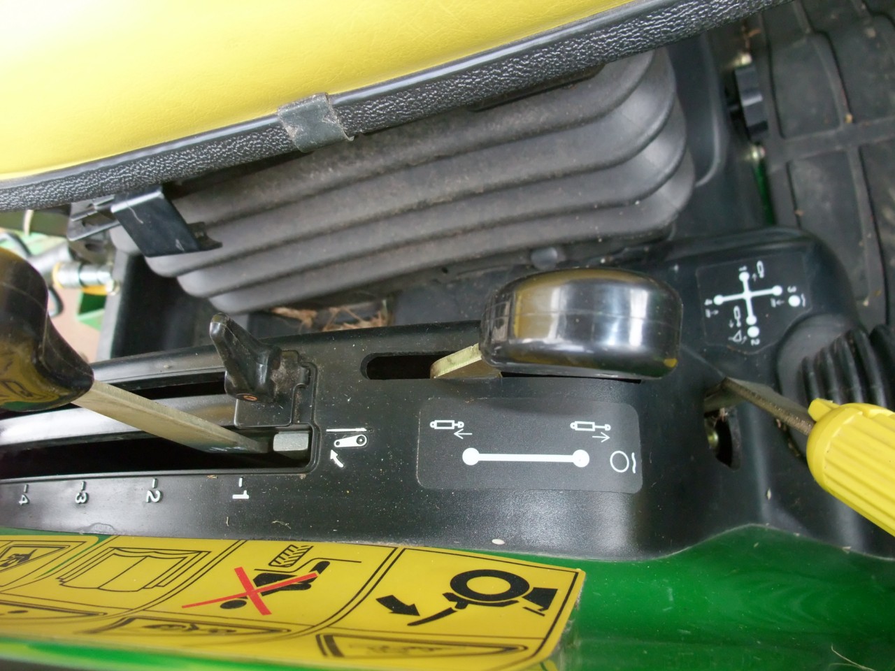

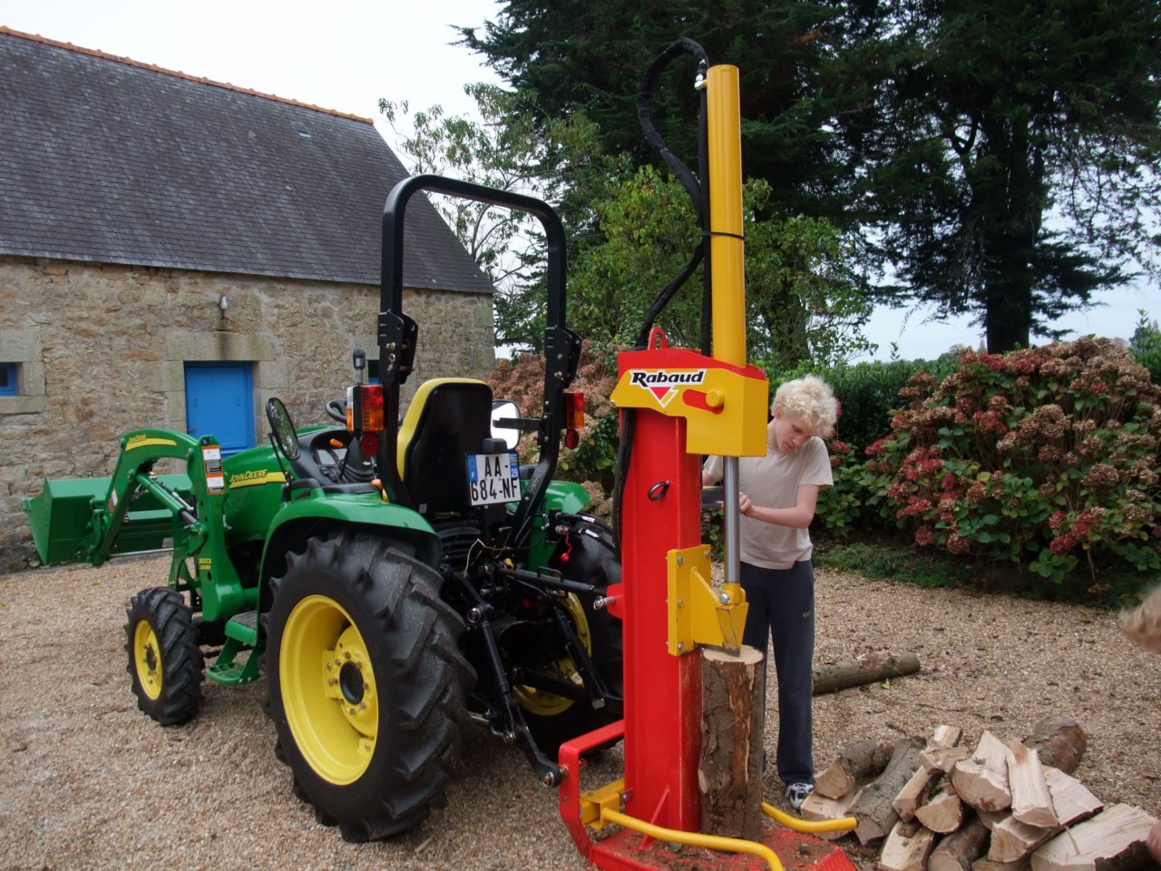

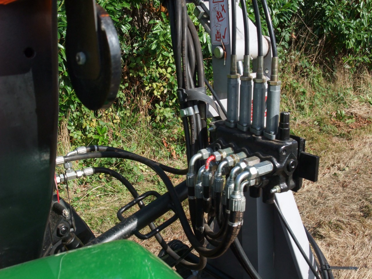

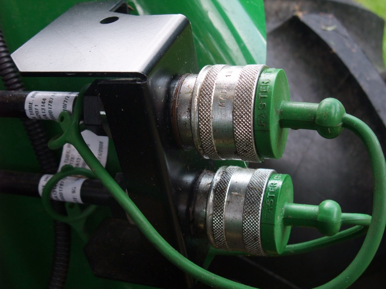

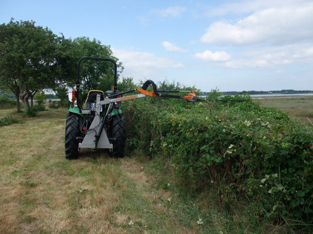

I have the only thing that was supplied on the new tractor, the lever-controlled 3rd SCV. The lever has to be held in position by a small metal chain supplied with the tractor (or a bungee cord). It is very difficult to find something to tie it to. The dealer suggested the PTO selection lever, I rather like the 3 point hitch stopper. You are never sure the valve is fully open. The lever often gets free, stopping the implement at the worst moment. Besides you can use neither the FEL nor the 3 point hitch at the same time as the 3rd SCV. I asked the dealer to modify the plumbing and put in a valve with detente in the open position, his answer was it wasn't possible. So I make do with this very unprofessional arrangement, wasting a lot of time.
Bad dealer setup is the cause of your troubles, NOT John Deere. What you need to operate implements with their own valves is the Power Beyond kit. It supplies a constant flow of hydraulic fluid whenever the tractor is running-no valve to hold open.
I couldnt have said it better myself!!! Which is exactly why I asked the question to start with - dealer not asking questions to verify what you are doing and what implements you plan on using with it. As KennyD said - you need a Power Beyond.
