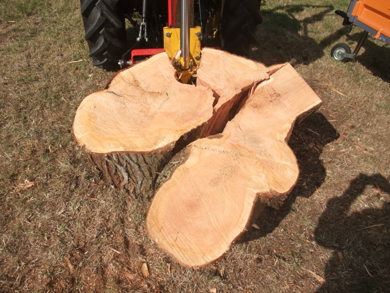

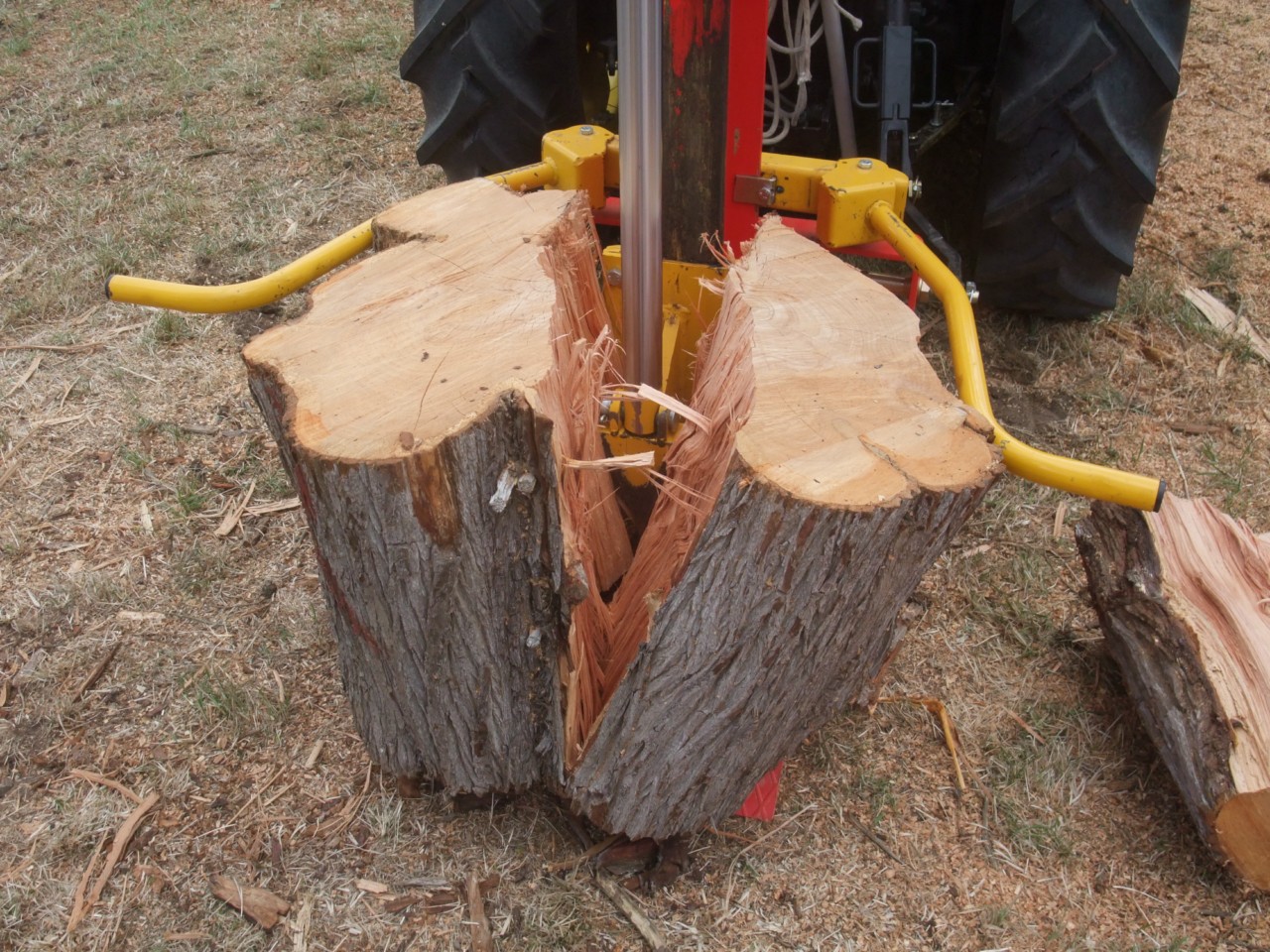

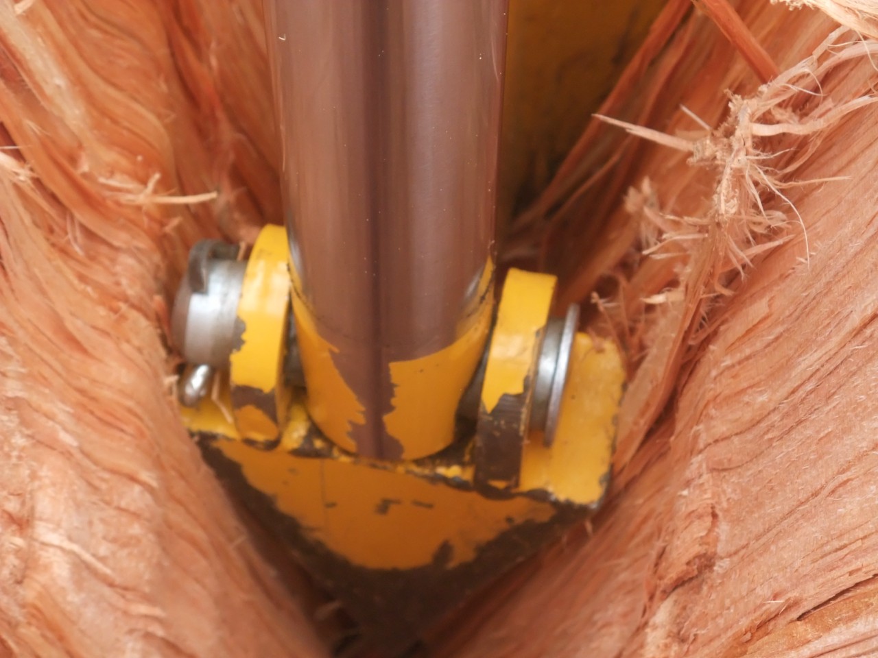

Nice stock of wood you have. I have a 3PH splitter too but you're ahead of me. I took down some trees and thorny scrub this spring but haven't split the wood yet.

I had to take down 6 big trees (cypress) as they had become dangerous for buildings or power lines. Even if it was not the best time of year to cut trees for fire wood, I took advantage of the very dry spell we're having to be able to drive around on firm ground and do minimum damages. I am splitting them now under pressure of the family to clear the space around the house. IMHO there was no real hurry, but the splitter is doing great work.
