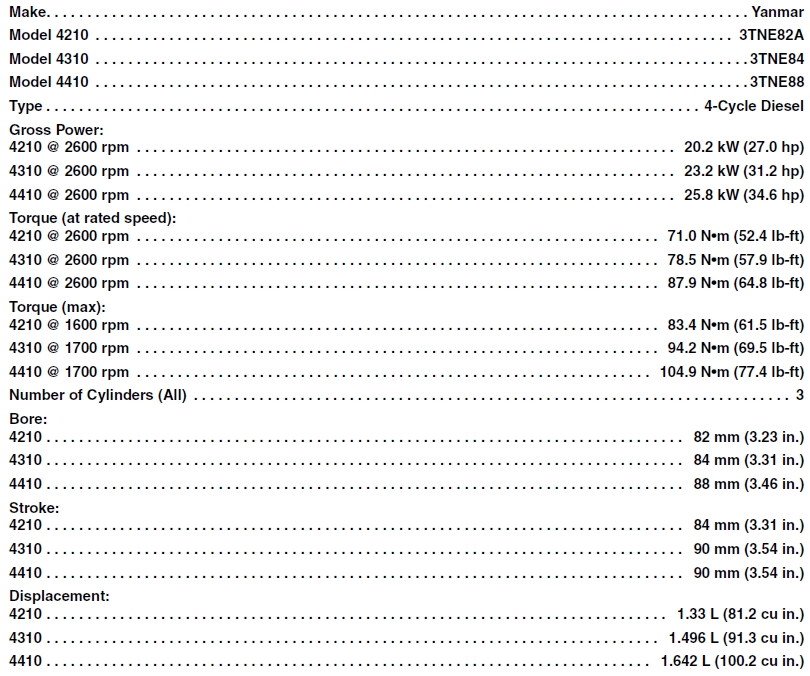

   / How can you evaluate a 4310 without seeing it in person? #38
I looked at the 3032E/3038E about a month ago and decided that I'd rather have a used 4310 for less money. The only difference between them is a turbo as I understand it. Is this similar with the 4310/4410?
None of the 4x10 tractors have turbos. Ignore all the errors in the dimension section below.

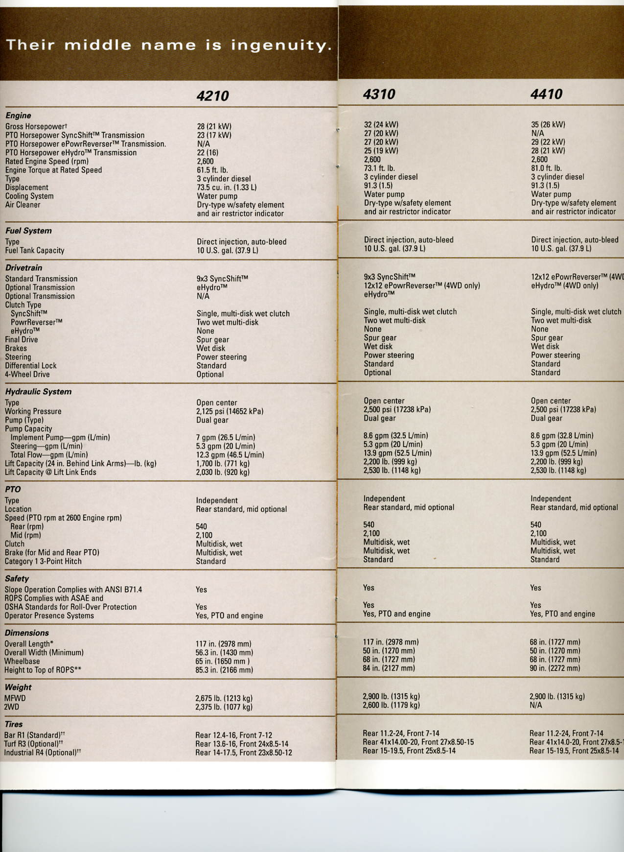

#39
I actually have that same brochure from back when they were made. The displacement is the same for the 4310/4410 so where do they get the extra 3 hp? Just engine programming? I would think that would mean they would be pretty close on fuel consumption although I could be completely wrong, not that for my use a slight difference in consumption matters at all.
   / How can you evaluate a 4310 without seeing it in person? #40
That's another error in the brochure. The 4410 has a larger engine. This is from the tech manual. The earlier 4x00 brochure also has the correct info.
