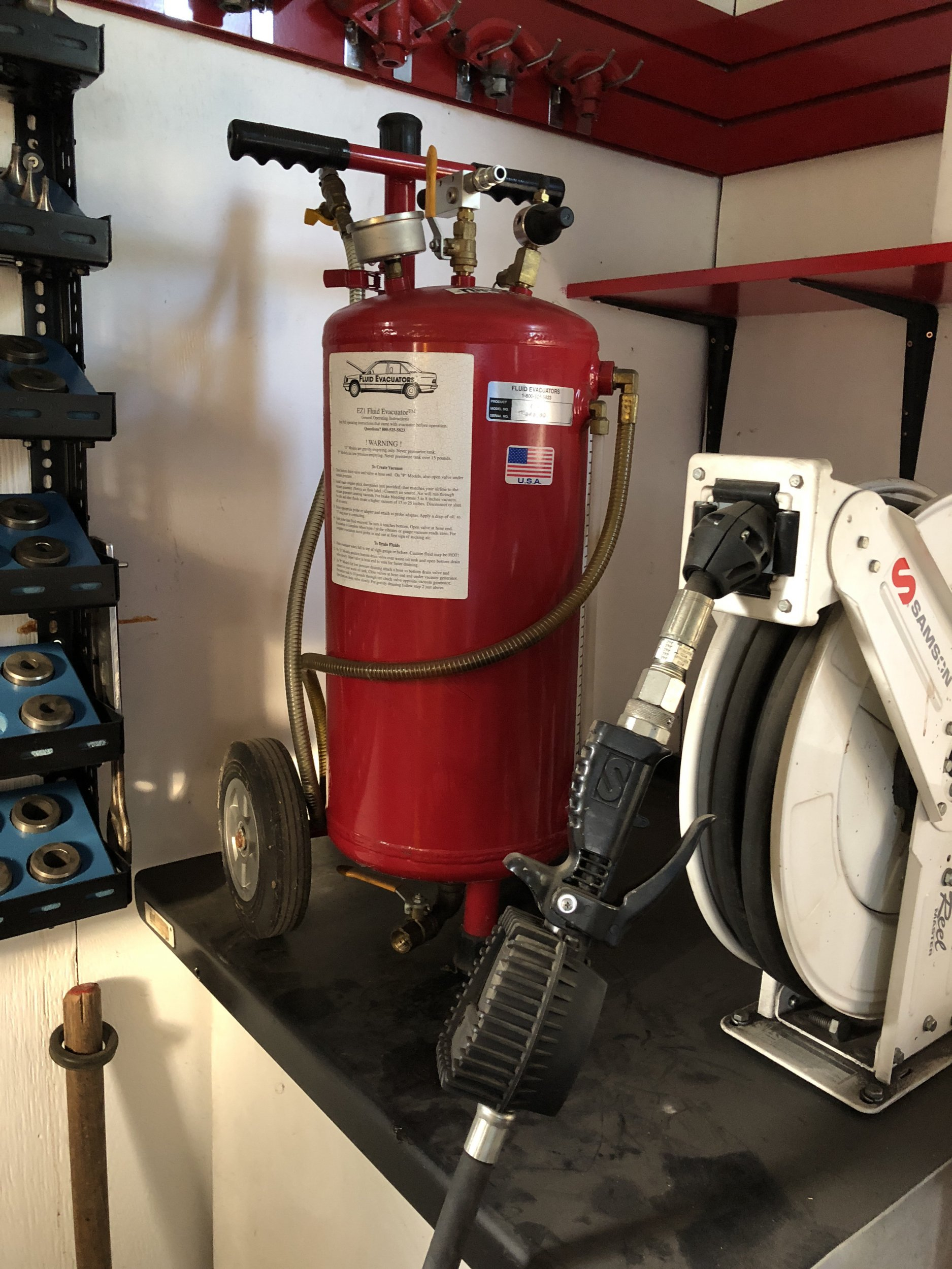

I use an oil extractor to vacuum the oil out of the engine. Then pump it into large plastic jugs.
Just feed a small diameter plastic tube down the dip stick and suck it out.
My DR oil pump type extractor is rather slow for that. I'd use the Northern Tool 12v one. Think it does 0.5 gpm.
