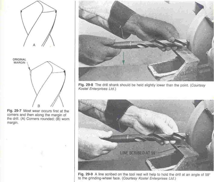

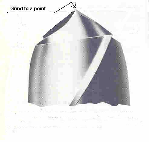

/ Drill DR. #29

I have the DD and like it. I would suggest that you do learn how to sharpen a bit with a grinder as it really helps you understand what went wrong if a bit you've sharpened doesn't seam to cut. It's kind of like learning math, if you just learn how to push buttons on a calculator then you really have no way of knowing if the answer it spit out is right.
