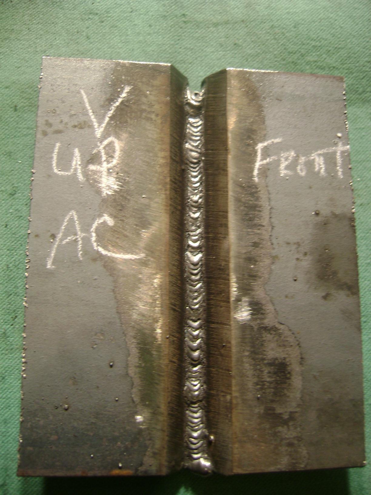

A lot of talk about welding on AC lately. Only AC welding I do is aluminum Tig, so I thought I'd give it a try. I used Hobart's 335A 6011. Other than the difference in noise I didn't really see a whole lot of difference than on DC.
What brand of rod did you buy?
