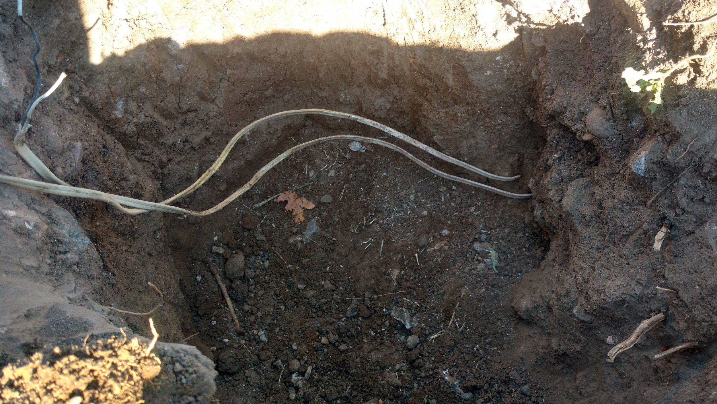

We have a light on a pole in our driveway. Its in a center circle bordered by pavers. I want to replace the light with a water feature.
I turned power off, removed the light and pole, and found two romex lines. One was still hot (don't ask!) They are about 2 feet below current grade, and about 3 feet below what the new grade will be.
I need to move these lines as the new water feature would be sitting right on top of them. I wish they were long enough to get to an electrical box on the edge of the circle, but they are not nearly long enough. And I still need power out there for the new pump.
I know you are not supposed to put romex in conduit. Nor splice wires and have electric junction boxes underground. But I'm stumped on what else to do?
Any ideas?

If it truly is Romex and it's in the ground, you should abandon it and run new - real UF (underground feeder) or THWN in conduit.

First, it does not look like what you have is Underground Feeder wire.
Next, I ran hundreds of feet of UF cable inside conduit with no problem in my barn. I ran 300' of 12-2 UF cable inside of 2in black plastic pipe with no problem....it's been 25 years....works good.
So...if the problem is that you have regular 14-2 or 12-2 indoor electrical cable...I would replace it.
Depending how long the run is, try to give it a yank and see if it will move at all.
If it does.....solder some UF feeder cable to the end of the existing cable and run a new line.
If it doesn't, look at digging up the cable at the edge of your existing circle.....and see if it pulls when you dig it up...
If so, same as above...replace with UF cable the underground section under the circle....and dig a trench to do the rest.
Sometimes the easiest thing is to call "Dig-safe" and have them sniff the exsisting line and other utility lines and dig a whole new trench and run UF cable inside of 2inch well plastic pipe.
The probem you have will get worse as you are planning to put a water fountain above suspect pipe...water wicking into the indoor wiring that is buried can short out the wire....

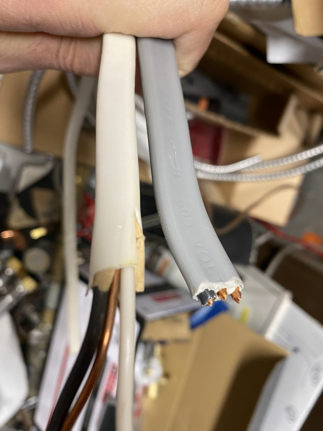

I don't know about your local codes but yes you can (and should) run your romex through PVC conduit. Check on the size but I would probably use 2 inch PVC for a single romex cable. What you are NOT supposed to do is run romex in steel conduit that is used to run residential or commercial building circuits.
/ Electrical / romex mess #50
Probably best to call your local electrical contractor, that wire does not even look like direct bury Romex.
If he can read the markings on the wire, if it says "NMW" it's direct burial rated (Canada) but in the US it will be called UF instead. Depending on the supplier, it might have *both* labels on them. Standard household romex (NMD and NM) is not burial rated.

It is not UF wire! Ut is therefore not rated for ground contact nor UV exposure. Thus it needs to be replaced. Aside from NEC violations, it is a major major major safety issue.

There will be no below grade junctions. The wire is currently in the center of an 18' diameter circle. If I dig back to the edge of the circle, I will have at least 10+ feet of exposed wire. Since it's buried only 2 feet, I'll have plenty of wire to bring it up into a box with no splicing.
I examined the wire and did not find any markings. It does look *exactly* like the UF wire picture that was posted earlier.

Both wires feed into the hole from the same direction.
If expose more wire, I will eventually get to the edge of the circle. I could put a concrete electrical box there, and turn the wire upward into it. No splice. Not ideal, but simply using what was original-- and with no splice. Maybe slip a conduit over the part that turns upward before backfill?

I'm going to clean the jacket on the romex and learn what it is.

If the ground is wrapped, it’s probably uf direct burial wire. But who’s to say for sure. Traditionally UF cable has very heavy insulation that’s hard to cut. But I have seen some out there with thinner outside insulation but still listed uf cable.
If the ground is also wrapped it probably is UF wire. With a bit of wiping the exterior sheathing you should be able to find a UF marking on the sheathing. Your photo of exterior sheathing removed looked dis not look like UF. Check carefully if not marked UF, I would replace to a point it is above ground level.

If it is not marked UF, any inspector (including a fire or insurance inspector) will put in their findings it is non UF wire. You would like then have issues collecting on your homeowners insurance for any claim. One of the problems is it could run and overload to the electrical panel and involve the entire home.
Replace to an above ground junction box or to panel and switch box with UF rated wire.
