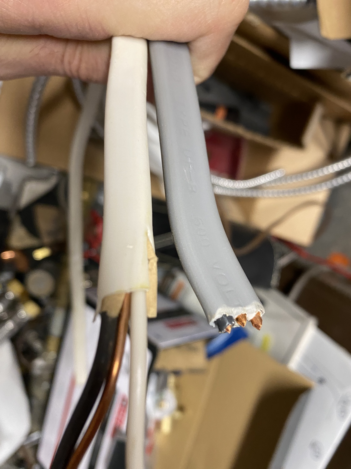

We have a light on a pole in our driveway. Its in a center circle bordered by pavers. I want to replace the light with a water feature.
I turned power off, removed the light and pole, and found two romex lines. One was still hot (don't ask!) They are about 2 feet below current grade, and about 3 feet below what the new grade will be.
I need to move these lines as the new water feature would be sitting right on top of them. I wish they were long enough to get to an electrical box on the edge of the circle, but they are not nearly long enough. And I still need power out there for the new pump.
I know you are not supposed to put romex in conduit. Nor splice wires and have electric junction boxes underground. But I'm stumped on what else to do?
Any ideas?

If that is direct bury uf cable, and not romex, you can dig backwards both directions and use accessible junction box . Place 1 j box at both ends. No problem using underground rated weatherproof wirenuts. Totally legal. Now if the wire is plain old house romex...THATS ANOTHER ISSUE.
I agree. It appears to be UF by the color. Easy to put above ground or surface of ground J-box on both ends to take care of the wire going straight through. Then use the light wire for the new pump. You may be able to read the writing on the cable to determine if it is UF.
/ Electrical / romex mess #94
I checked and there are no markings on the romex. Looks like black #12, white#12, ground in center, no paper. The ground is enveloped in its own plastic sheath just like the other leads are. (I.e. not "loose" in the center.)
That appears to be UF when all three wires are surrounded by insulation.
