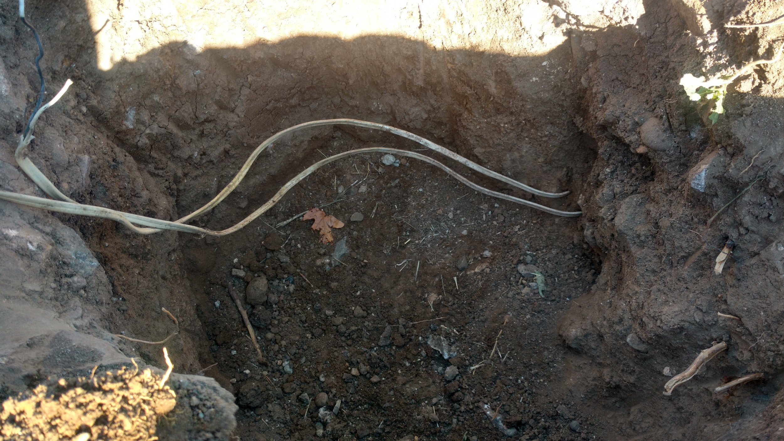

If it is not marked UF ...
I re-inspected the cable in bright sunlight using my 3.5+ cheaters. :LOL:
It is marked UF and also says "S U N L I G H T R E S I S T A N T"
There is also a funny marking on the other side of the wire-- kind of like a horse hoofprint in the ground but more triangular. Perhaps a manufacturer logo?

More info: I believe it is UF romex-- there is no paper and it looks just like the pictured one. I can excavate the exposed wire back to the inner wall, then turn it up into a (new) box with no splicing.
Both romex wires are connected to the same breaker. One is switched (the former light circuit) and one is always hot. Both are connected to the same breaker-- a 15amp Square D arc fault breaker.

>I know you are not supposed to put romex in conduit
Why not? Safer than burying it, surely!
/ Electrical / romex mess #71
OK, now that sounds like a switch loop. See this example of how I understand what you have. I used yellow in place of white so it would show up.
/ Electrical / romex mess #72
We have a light on a pole in our driveway. Its in a center circle bordered by pavers. I want to replace the light with a water feature.
I turned power off, removed the light and pole, and found two romex lines. One was still hot (don't ask!) They are about 2 feet below current grade, and about 3 feet below what the new grade will be.
I need to move these lines as the new water feature would be sitting right on top of them. I wish they were long enough to get to an electrical box on the edge of the circle, but they are not nearly long enough. And I still need power out there for the new pump.
I know you are not supposed to put romex in conduit. Nor splice wires and have electric junction boxes underground. But I'm stumped on what else to do?
Any ideas?
Call a licensed electrical contractor. Someone has been feeding un-truths. Wires can be spliced underground and romex can be installed in a conduit for physical protection of the wire.

You should not run UF wire through conduit. However, the actual wire without the jacket is likely THWN, which can be in conduit. You could convert to conduit as long as the UF shielding is removed. It would be best to do this is a junction box. I doubt the electrical code prohibits underground splices since devices exist to facilitate that very thing. This more pressing issue is wire size and the intended amperage you intend to draw through it.
/ Electrical / romex mess #75
You are correct. I turned the switch off, saw the light turn off, and thought all was well.
After pulling up the pole and light fixture (and a giant blob of concrete) I saw the 2nd UF cable, which I didn't expect. I mistakenly presumed it used the light circuit as its source, and traveled on to another "downstream" ... something. But .... I was later "jolted" back to reality. :D
Whatever you decide to do, you need to identify how to turn-off the 2nd wire. Yes it is insulated but there could be a shovel nick in the wire.
I'm convinced you have UF wire
You absolutely can use splice kits. Perform work precisely!
Depth should be: http://www.adamselectric.coop/wp-content/uploads/2015/02/Minimum-Cover-Requirements.pdf
If you have any double -tapped breakers they must be designed for it. MFG label says "2 pole" Easily corrected.
If this were my home, I would rather have direct-bury splices than to have j-boxes sticking up next to where people are driving.
I'd also want a GFCI breaker.

My licensed electrician finally returned my call. He said the described plan is exactly what should be done-- thank you all again for the many replies!!!
