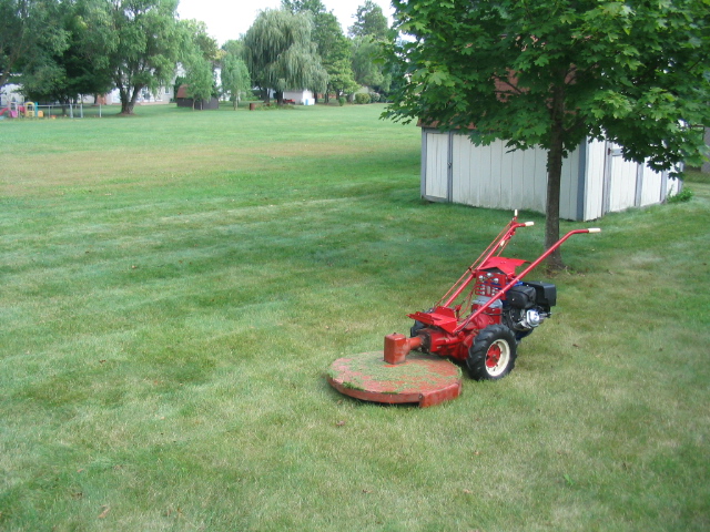

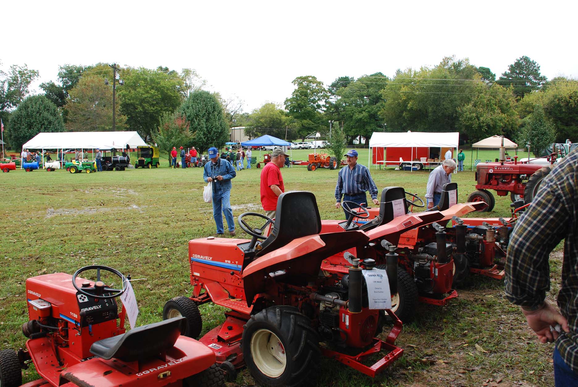

Hi folks. You may recall earlier this Summer I put a 13 HP clone on my 73 Superconvertible. It worked but the tractor ran too fast. Since then I had Bruce shave 3/32" off the 1" drive gear shaft so it wouldn't stick too far into the tranny. I also soaked the hi/lo planetary in oil for about a month. Finally I adjusted the hi/lo clutch band. Tried the tractor tody and it worked! Guess that makes me an offical member of the repower club! There is a photo below showing the tractor cutting my back yard today. The 30" mower even put some nice stripes on the lawn.
When I started this I wanted to see if I could make an adapter without doing extensive machine work. To do this I used the front half of the Gravely 7.6 engine crankcase and put a home made aluminum plate on the back. I say home made because it is a simple aluminum plate made using a circular saw and drill press. I did need some machine work done on the gear and bolt used to hold it to the crank - which Bruce did exactly the way I asked. I'm tickled this worked and appreciate all the suggestions made on this forum.
