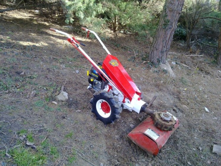

Hi all
I have GRAVELY LS need help
I wanna ask you, becouse I made repowering too, change the original Gravely engine for new Honda GX200. At original GRAVELY with original engine, there was transmission lubricated from engine. How can I lubricated transmission when I use new Honda GX200? Can you help me please?
Thanks you very much!
Martin

This isn't an issue when repowering an L model other than blocking off the original oil lines, many use pipe plugs to close up any line connections on the transmission housing, all newer model 2 wheel Gravelys (after the L) used splash lube in the transmission.

Thank you very much for comment
Bruce from N.Zealand said:
When replacing the old Studebaker engine (with oil pump)
for a Honda or similar: you must use between 4.5 and 5
litres of engine oil in the transmission. When you do this,
be careful with changing mower or cultivator as it will spill
out.
So, I fill it with oil 10W30 and it´s ok.

Jeeze I forgot that important info on the additional oil in the trans, yes if I remember correctly my Kohler tractor uses 4 qts and it is engine oil, do not use gear oil as most of the stuff available has additives that are harmful to the brass gear.

FYI: I have three Simplicity two-wheel tractors and my Gravely attachments that require GL-4 gear oil. I was able to find it a NAPA.
   / Engine ideas
#450
Yes if you locate the "special" stuff (GL4) that works, wont eat the brass gear. Last I know from those into Gravelys said engine oil for the trans also.
