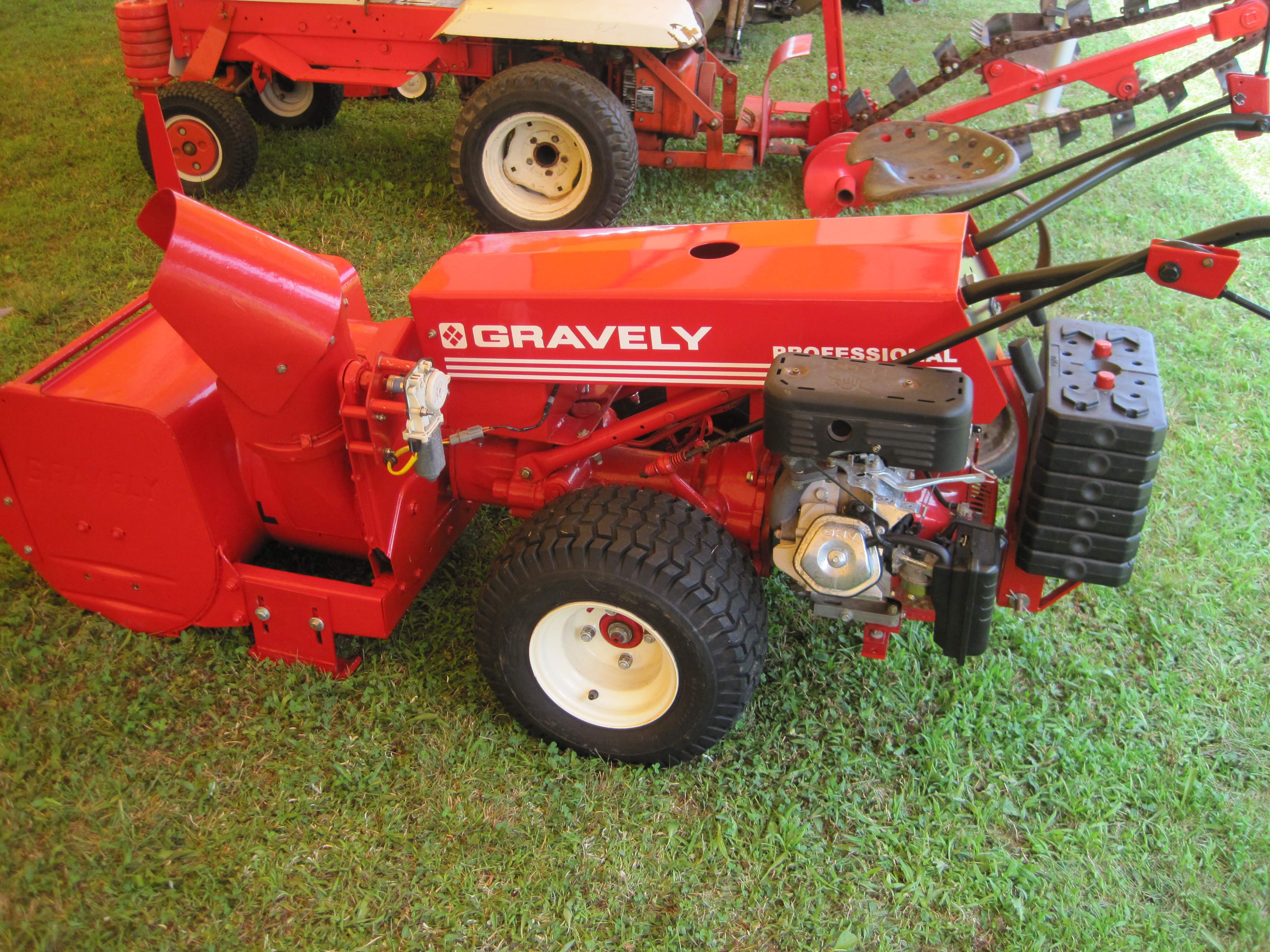

I got to see two of the later model conversions that used Bruce's conversion parts at the Mow in,,, nicely done, if ya didnt know Gravely you wouldnt have known it was a conversion, well cept for the empty filler hole in the hood. I also got to hear one running, or should I say I had to listen to hear it running, man was that quiet compared to a Kohler with the pepper pot muffler. A pics for all the pic hounds,,,

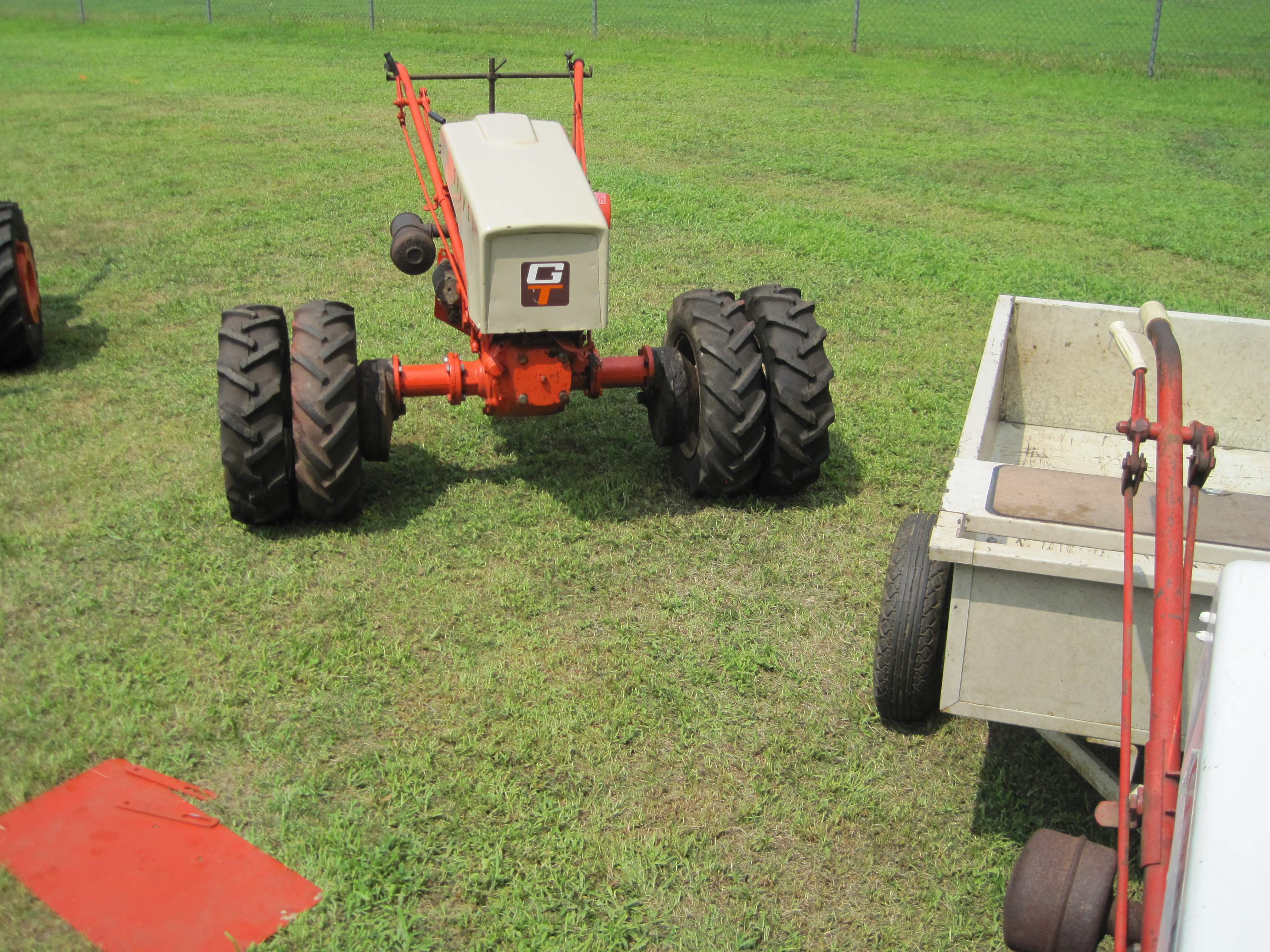

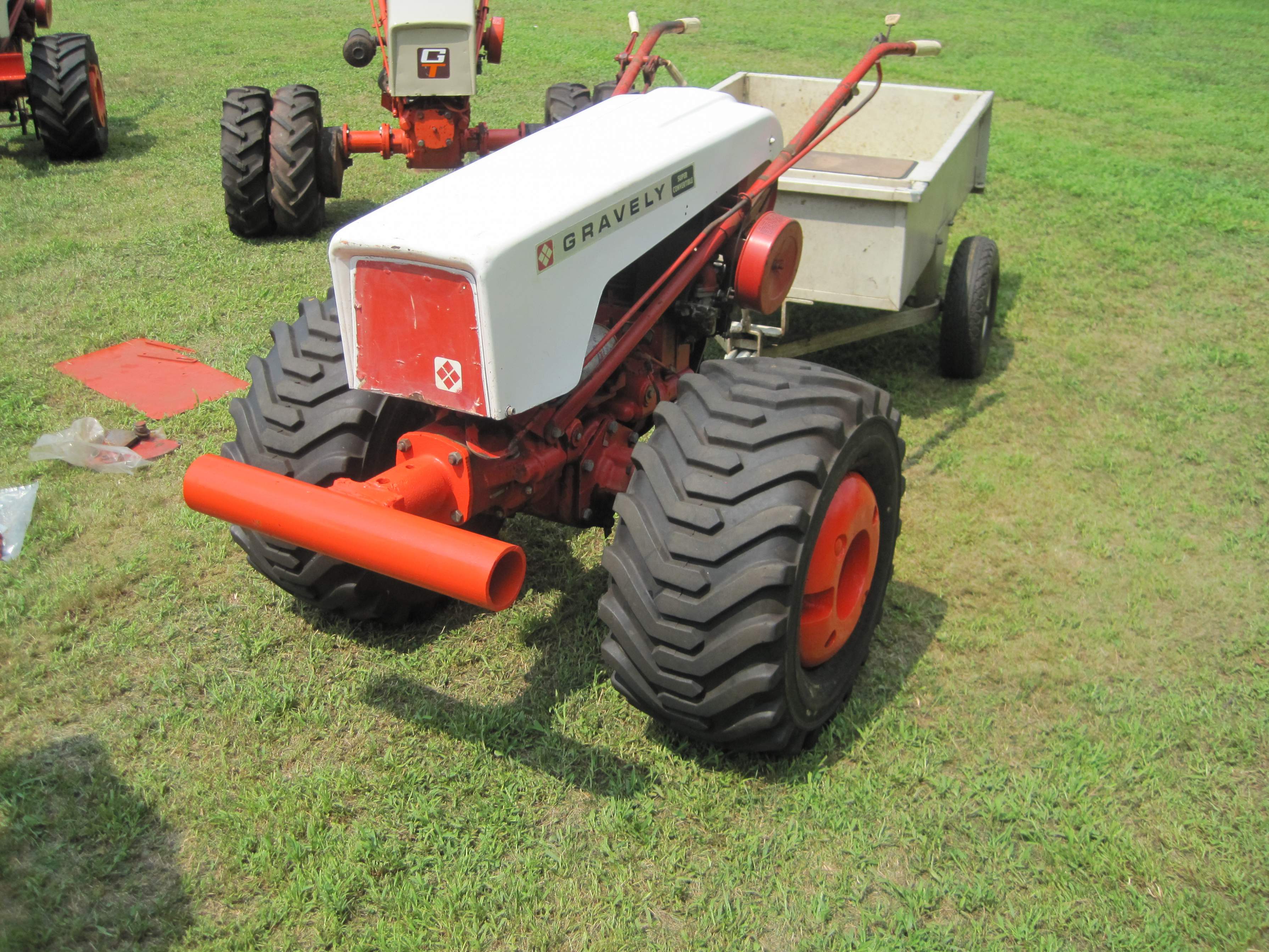

I just cant resist posting these, man did they look beastly in person. None of em have engine conversions, all still running the Theads. The only one I remember the tire size for is the wide boy with the duals, axle extensions, and gear reduction, tires were 6x12s. Maybe the owner will see em and give us some details, I did get to talk with him a bit but my JD hat was distracting him,, ya if ya go to a Gravely event dont wear a JD hat,, unless ya got armor plate for skin, all good fun though.
