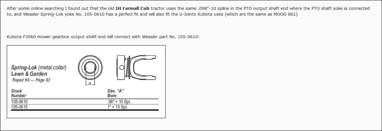

Is the PTO output connection on the F-3680 the same as on a regular Kubota tractor like the L2501? I'm guessing the lift mechanism isn't the same as a tractor 3pt so there wouldn't be an easy way to use a light duty rotary brush cutter designed for a tractor on the F-3680?
Your Kubota F-3680 model PTO output shaft should be the same as for example IH Farmall Cub tractor PTO shaft is - it's easy to count the splines & measure the OD if it is .098" ?
See my post couple of years ago regarding my F3060
Kubota F3060 PTO Shaft - OEM Replacment No Longer Available!
(The U-joints in F-3680 PTO shaft may or may not be the same as MOOG 861 ?)
Weasler parts are readily available - I hope this helps.
Cheers

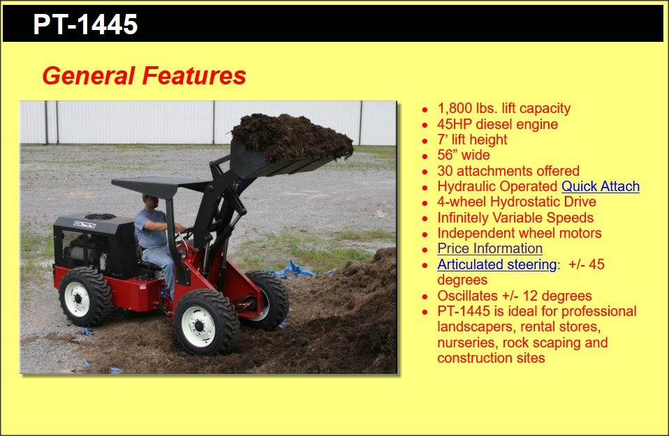

Power trac pt1445 but am still in the break in period so I don’t quite have an opinion if it was the right choice for these slopes. Already had to upgrade the Oem wheels on the mower deck and fabricate a debris deflector. But not enough hours to have a real opinion yet.
   / F3680 slope capacity? #30
Wow, that is an impressive looking tractor!
Just got this from the manufacturer's website:
